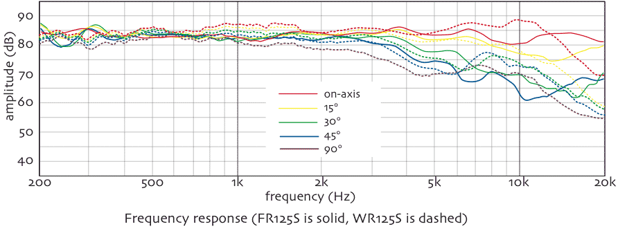

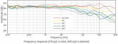

I'm listening to WR125s (with an ApexJr T -- XO is a 1.8 uF Solen) in a 14-15 litre sealed box. I am quite pleased with this combo. One of the biggest tasks with the WRs & FRs is taming the bass -- far too often i have heard them & the bass was just too much (quite the thing to say about a 4 1/2" driver).
Off axis is quite good -- alot of my casual listenng is off to the side -- i can just see the speaker grills. Serious listening is in the far field and the sweet spot is fairly wide.
The technical sheets have a graph of the measured on & off axis response.... attached below.
dave

Caution on Arrayed Drivers
Do not assume that you can use full range drivers or drivers with extended responses in an array and achieve the same extended performance as for an individual driver. The best way to confirm is via measurements of the array but you'll find that the woofer line in an array will lose directivity and start falling apart (sensitivity rolls off) beyond one wavelength center to center spacing. Other researchers caution against going beyond a half wavelength c-t-c. See the white paper for discussion.
