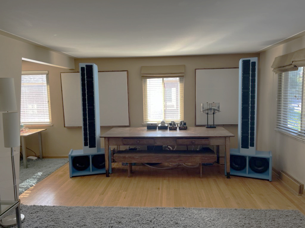

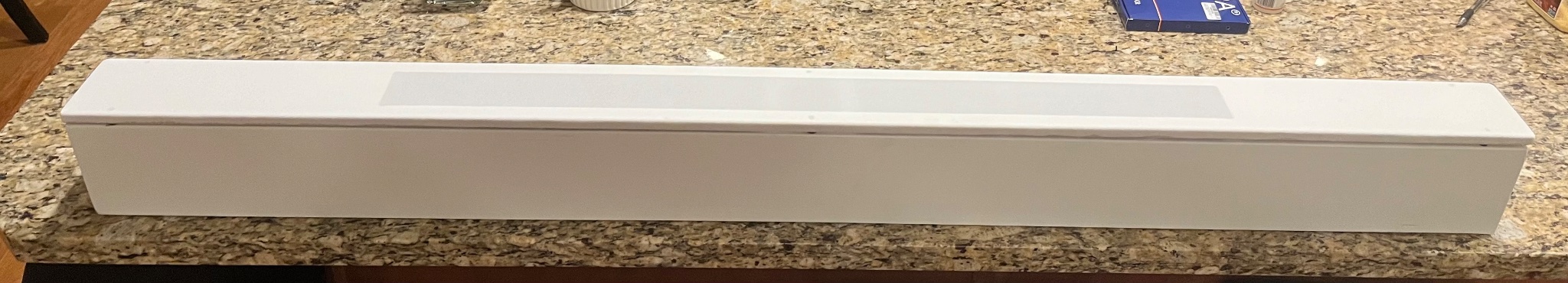

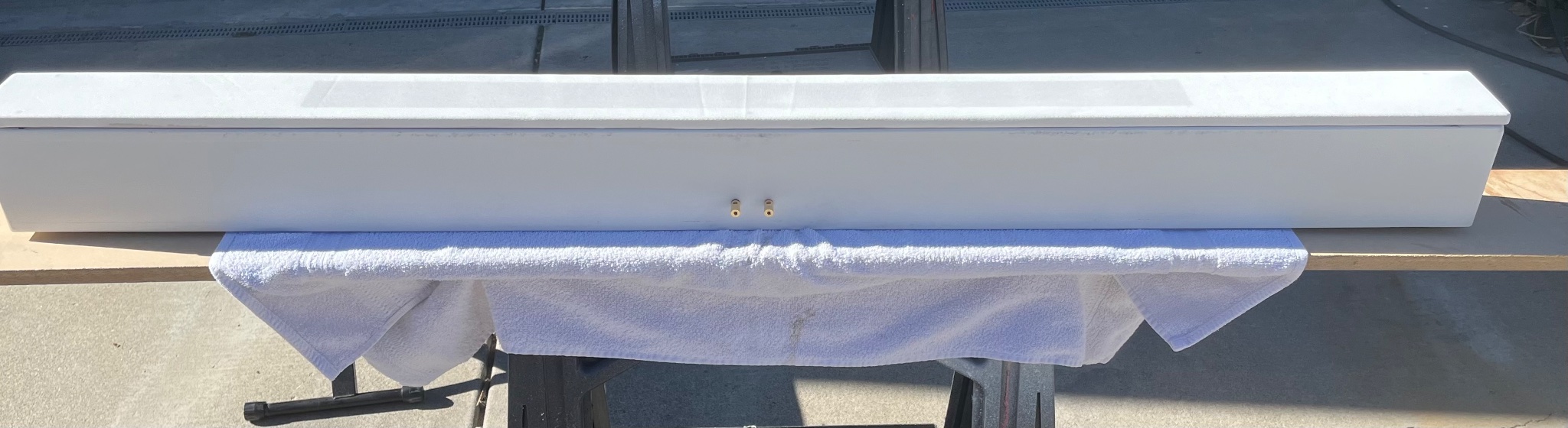

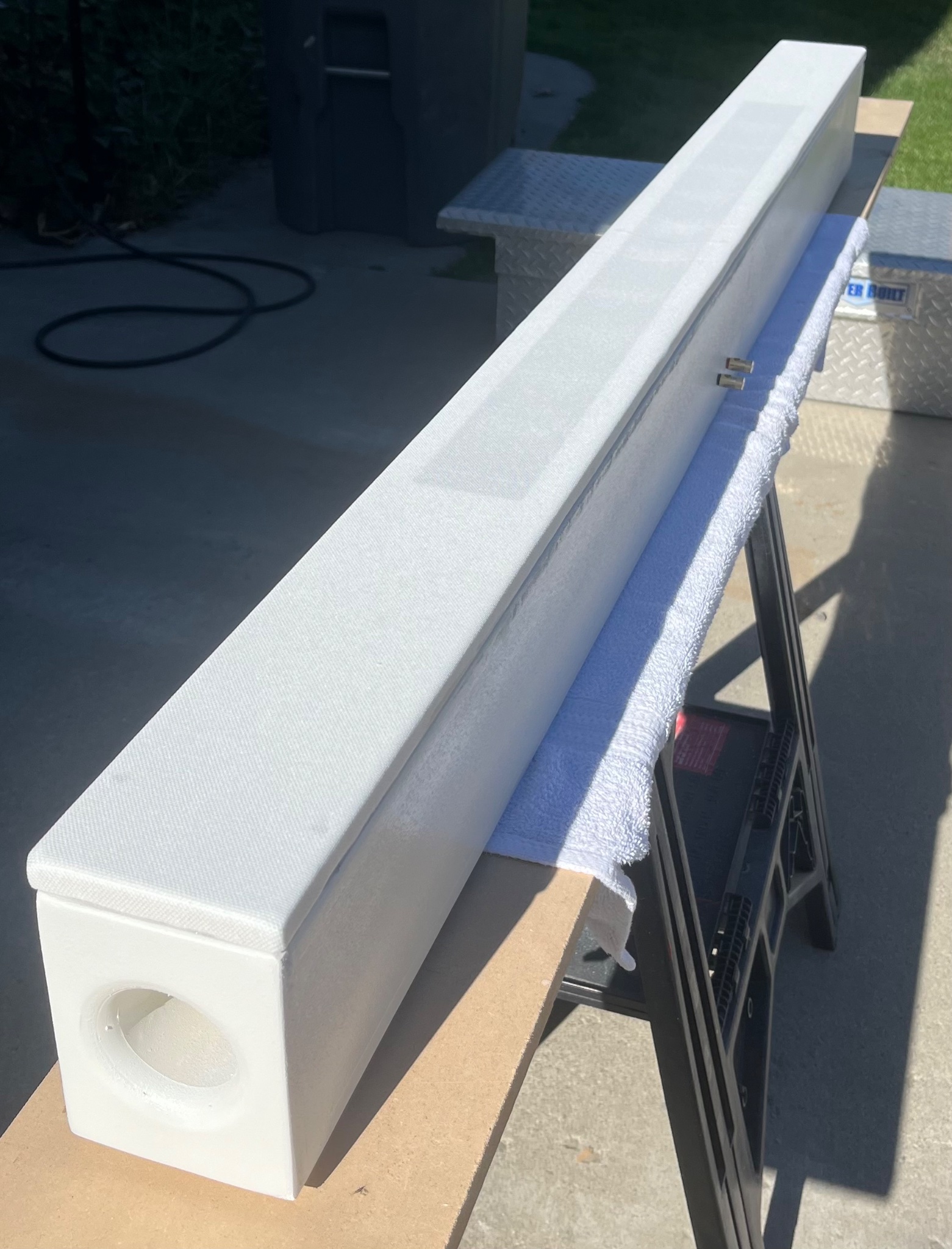

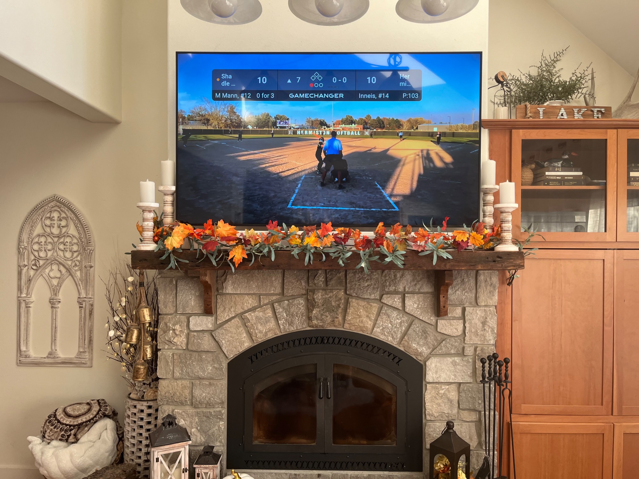

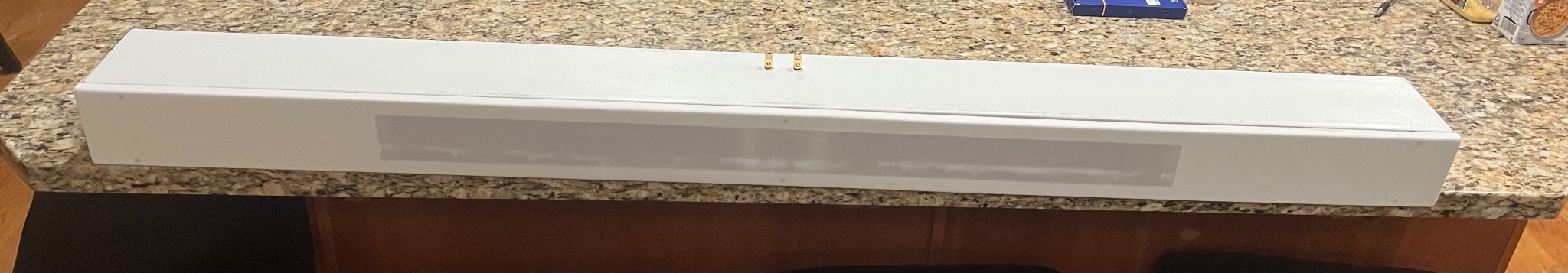

All done, by the amount of decor you can see why I wasn’t super worried about the finish, but it still looks great!

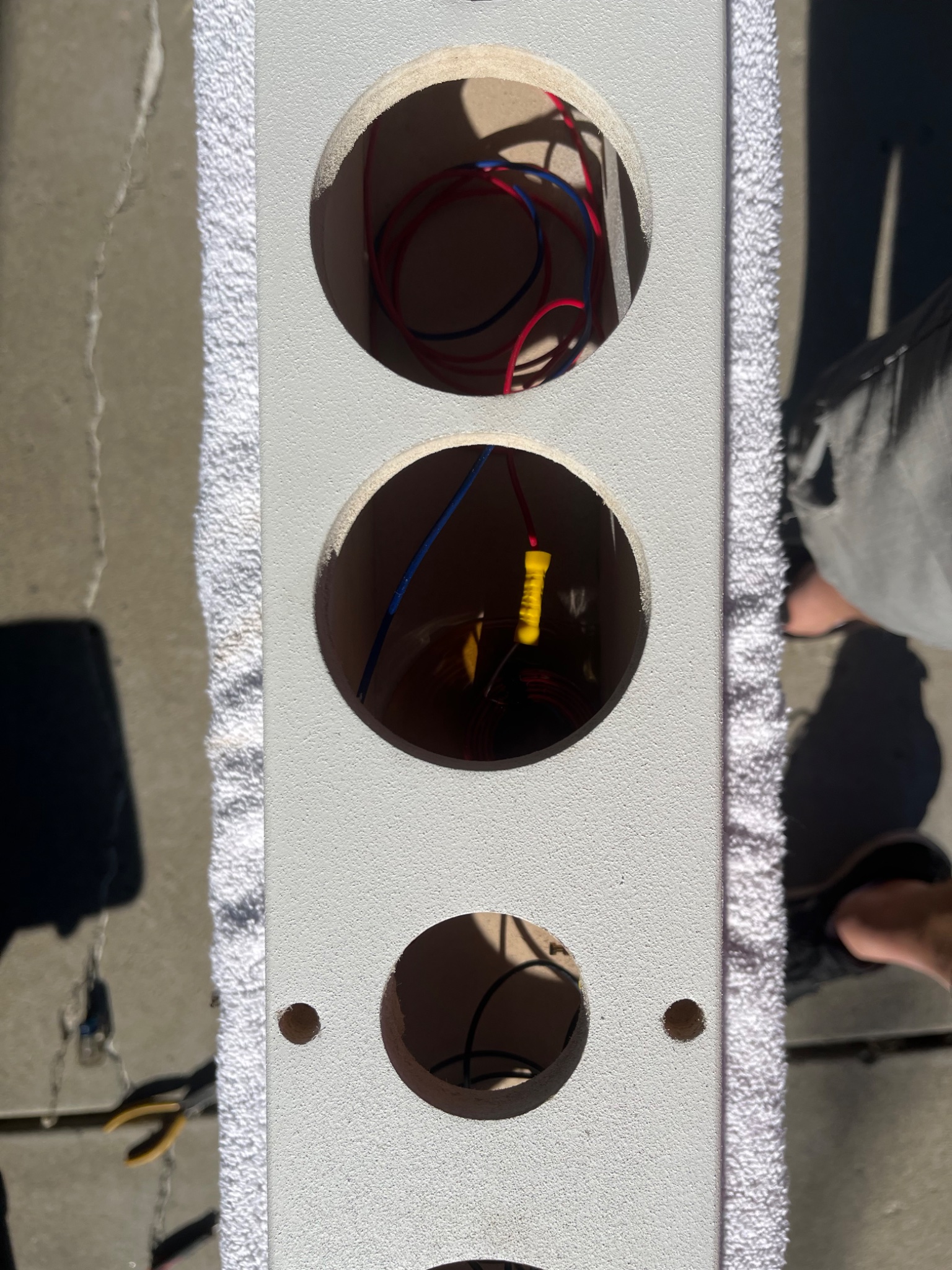

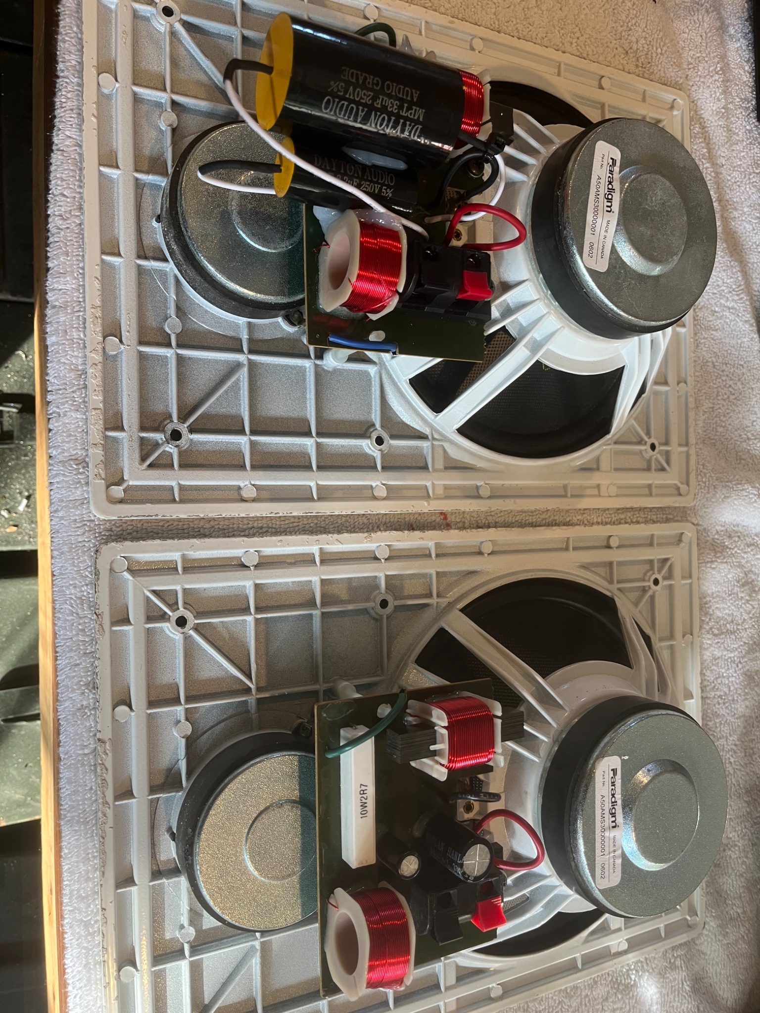

Sound is good. When you pass it up close, within a few feet you can hear the phase nulls, but at about 8’ and further they seem to sum decently and vocals are very clear.

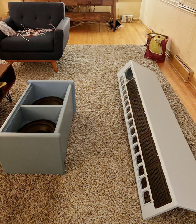

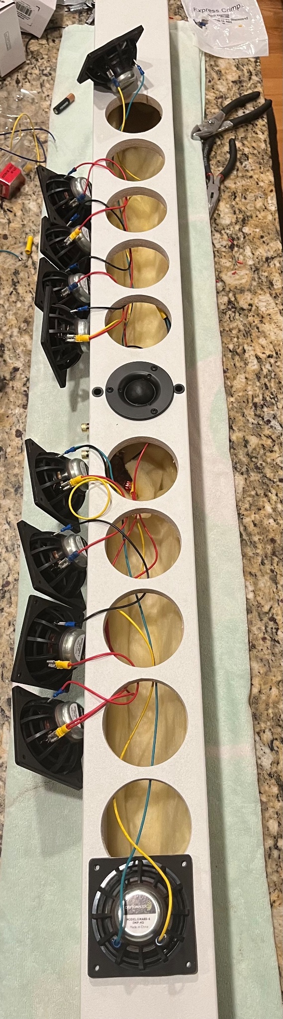

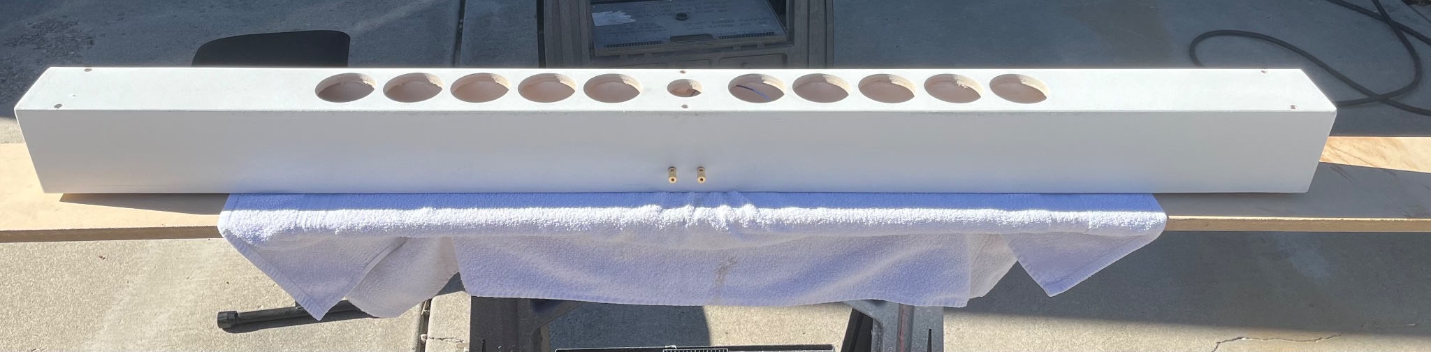

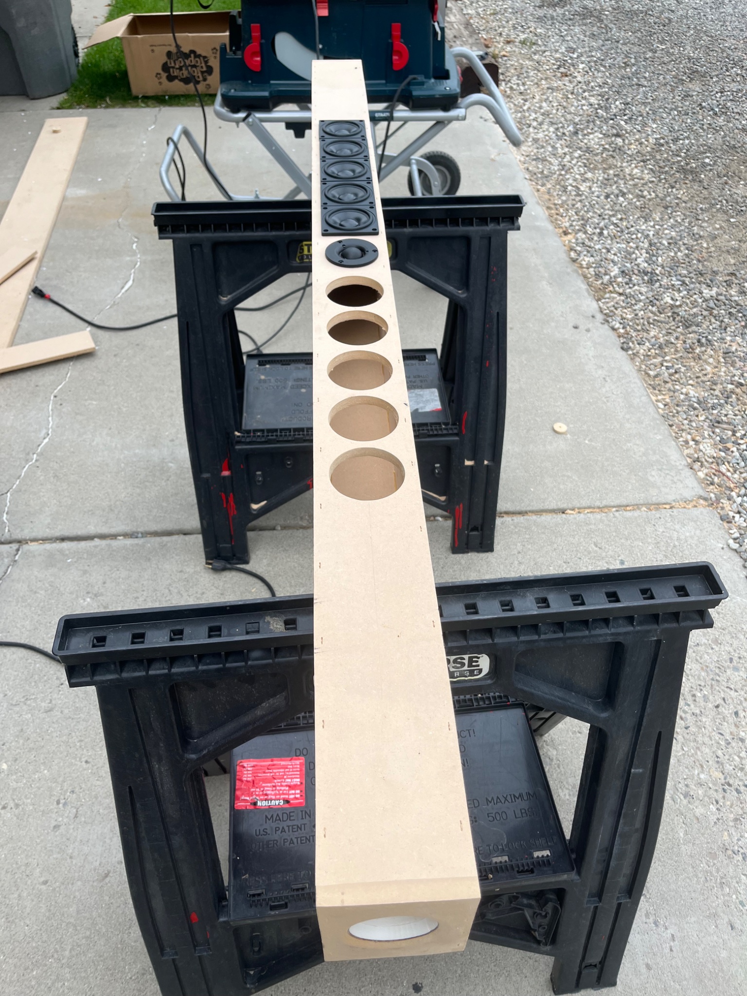

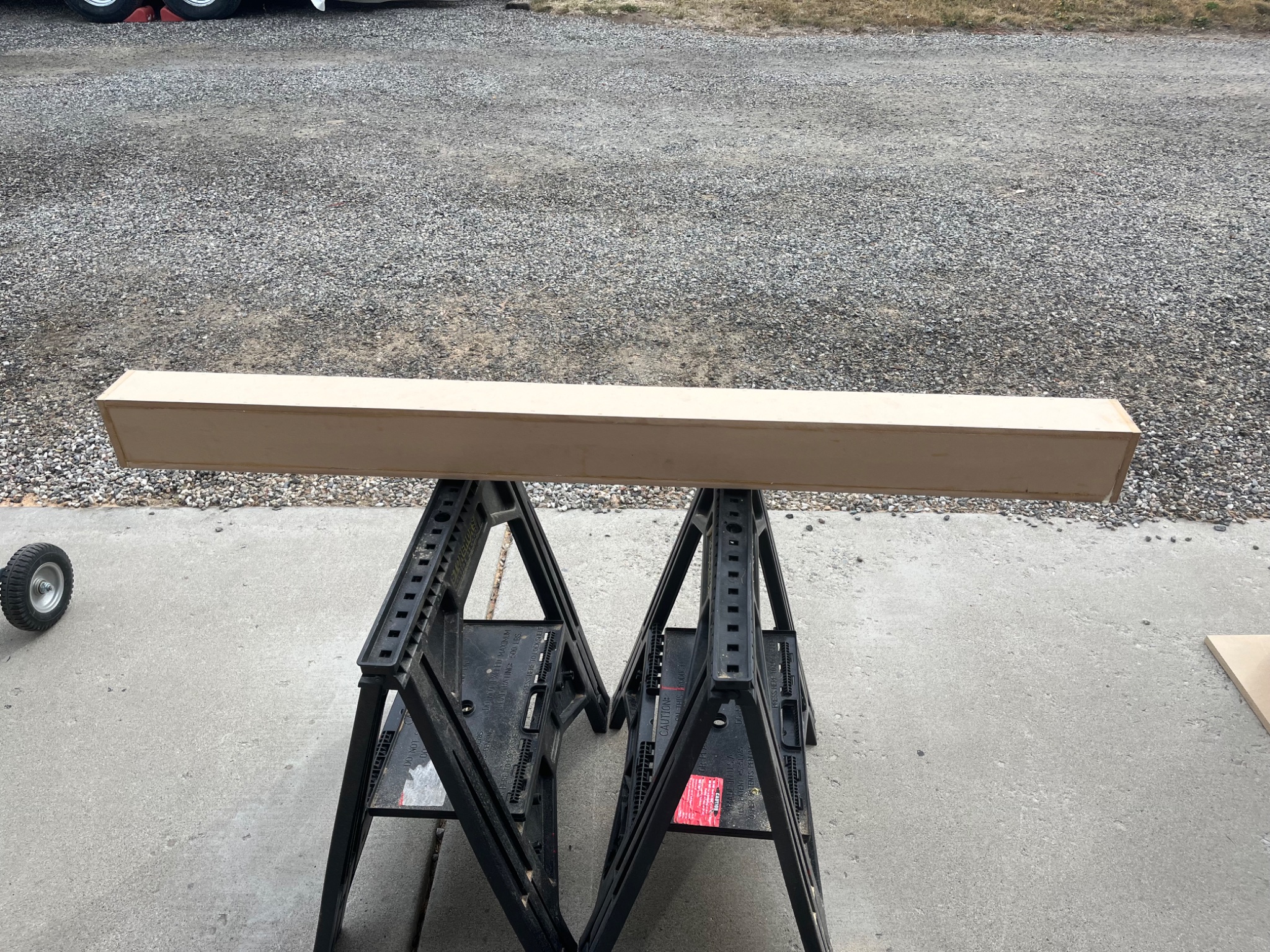

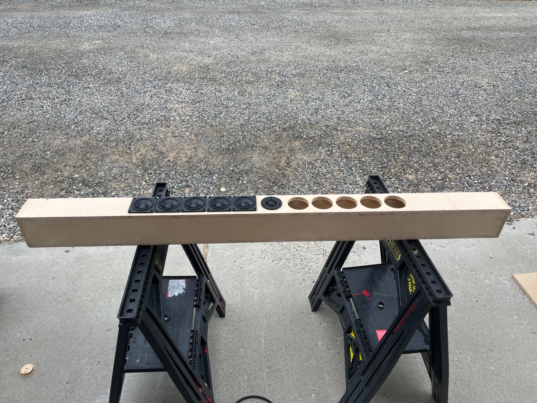

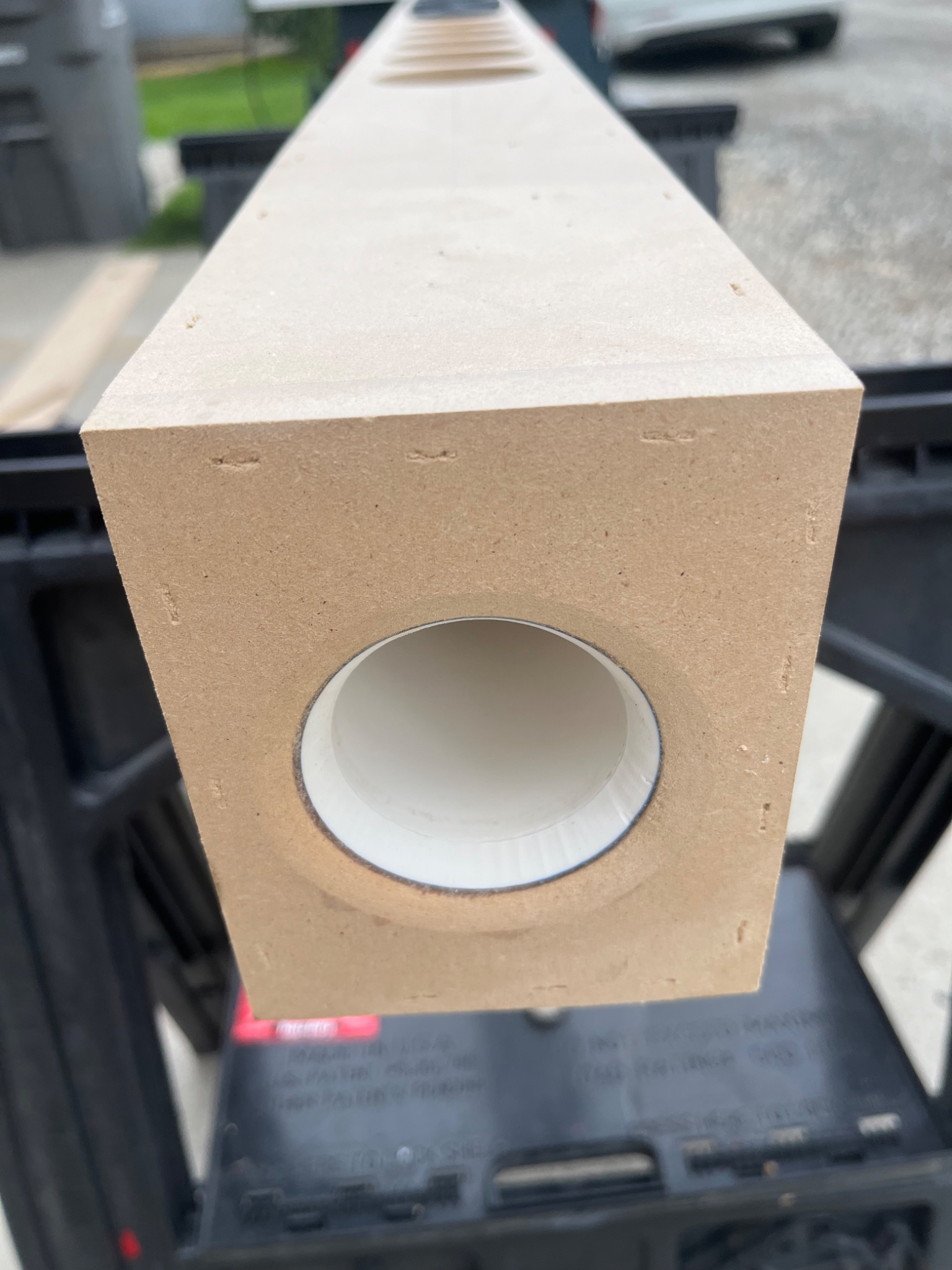

I am building a center channel channel for our living room Home Theater. I had several drivers already I decided to use, 10 3” FR drivers and a Morel 1” dome. I decided to add the 1” dome above 10k as it has pretty smooth off axis response and the FRs get a little ragged that high.
I plan on wiring each set of 5 in a Bessel alignment to keep horizontal beaming to a minimum.
My question is horizontal spacing. I have no limit up to 60”, but I was wondering if anyone had an ideal of optimum spacing with them being in a Bessel, I really don’t know where the acoustic centers will be and how...
