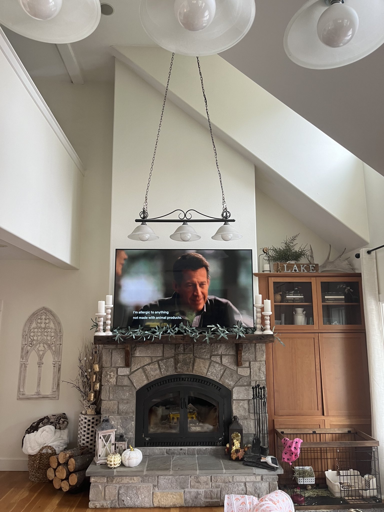

I am building a center channel channel for our living room Home Theater. I had several drivers already I decided to use, 10 3” FR drivers and a Morel 1” dome. I decided to add the 1” dome above 10k as it has pretty smooth off axis response and the FRs get a little ragged that high.
I plan on wiring each set of 5 in a Bessel alignment to keep horizontal beaming to a minimum.
My question is horizontal spacing. I have no limit up to 60”, but I was wondering if anyone had an ideal of optimum spacing with them being in a Bessel, I really don’t know where the acoustic centers will be and how they will sum. I really do not feel building test baffles and measuring and was hoping someone on here would have a tip.

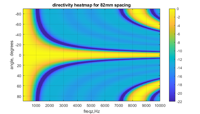

No, not what I want, and I really appreciate your model! That is why I was trying to go with 2 separate 5 driver Bessel arrays. I was hoping this would prevent that type of focused output but I wasn’t sure how the 2 arrays would combine, that was the intent of this post. My hopes were that since both 5 driver arrays would not behave like symmetric line array I could have much better horizontal dispersion.

Even if he weights the array as per the Hamming window (1:0.8:0.5:0.2:0.1), the main beam width will be only 2 times wider.

Arrays are only practical when run with DSP imho. Wouldn’t it be easier to add a passive lowpass to the outside drivers and only use the two (or one) fullrange(s) adjacent to the tweeter up to the crossover to the tweeter? So that you essentially build a 2,5 system?

Ahhh, not sure you guys caught my original post, these are being wired in a Bessel arrangement.
Where the one speaker is out of phase? That would explain the five drivers. 🧐 That would be a Bessel array, I guess. I think people though you were putting in a Bessel crossover.
OK, now that we know what you are up to, I agree with @mayhem13 keep everything close together. There is no reason why you can’t build a larger box to fit the width of the mantle. Just for esthetic purposes, but still keep the drivers close in the middle.

Also, I think I will add a defeatable high pass filter @150Hz for the 2 out of phase drivers, beaming shouldn't be as bad that low and it should just act like a Nestorovic alignment, I don't want to lose a ton of output in the 100-200Hz range as there is a pretty hefty handover to the subwoofer. It will be easy and on a toggle switch, so if it doesn't work, I can leave it bypassed...
