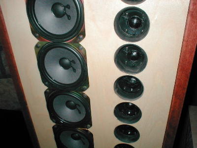

Last night I hole sawed 24 1-3/4" holes on the face of the speakers at 2.270 centers. I followed with a 1/2" radius routing bit with just enough clearance to provide bearing surface for the ball bearing router guide. It produced a very nice looking horn wave guide. I have absolutely no idea how it will affect the sound, but I have read that right angles aren't the hot setup.
After the holes were routed, I brush painted the exposed MDF with black acrylic. Looks sharp.

Prepping the tweeters.... I call it shucking oysters. Hold the tweeter face down in the left hand. Plae thumb against side of connection jack and give it one big push. Now thats gone. Still holding the tweeter in the left hand, snip off the wires of the jack with diagonal cutters. Now snip the terminal of the yellow wire that holds the cap. Move the tip of the cutters under the cap and pry upwards against the cap using the plastic case as a fulcrum.. it's loose. Wiggle the cap so it fatiques at the red terminal junction. Finish by pulling the wires out of the strain relief. Strip wires and serve on plate! ~ About thrty seconds prep time.
You can Dremel the shields off. If you are shakey, baby diagonals will clip them off also.
The speakers are in the living room and connected. I'll try to get a photo today or tomorrow. Start to finish... (who's counting a decent crossover?) about ten days.
tweeter prep
I forgot to mention on the last thread... The tweeters are first prepped by cutting off the excess plastic on the housing. Specifically, the plastic that increases their center/center distance is removed. We made a wooden jig ~(fixture/template) that held pinned the tweeter through the mounting holes. This we fed through a band saw to trim about 0.200" on each side.

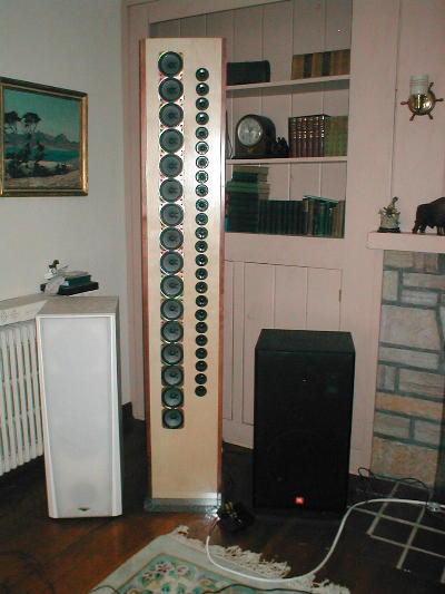

This is just a follow up to the line array questions I posed last week. Thought that you might care to see the cabinets... They are birch MDF with a birch corner stile. The cornert stile provides the strength for the glued splines. Base is 1-1/2" MDF with granite look laminate. Overall height is 81-1/2".
I'll drop in the drivers this week and start wiring. I am open for any sugestions on the type of caulk for sealing the speakers to the baffle. Suggestions?
Your cabinet look really good!
What is it made of? (I don't understand what birch MDF is)
Is the light wood simply MDF, and the dark corners are made of solid wood (birch?)?
MDF is medium density fiberboard, generally in 3/4" thickness (~19mm). It's wood chips and saw dust mixed with glue. It is available with a variety of veneers, usually with one "good" side and one "bad" side, each about 2mm thick Pretty vs. not so pretty. This one is birch, unstained and laquered. The stiles (vertical rails) are also birch, but stained. The construction is splined & glued. Both speakers are constructed from a single sheet of 4' by 8'.
