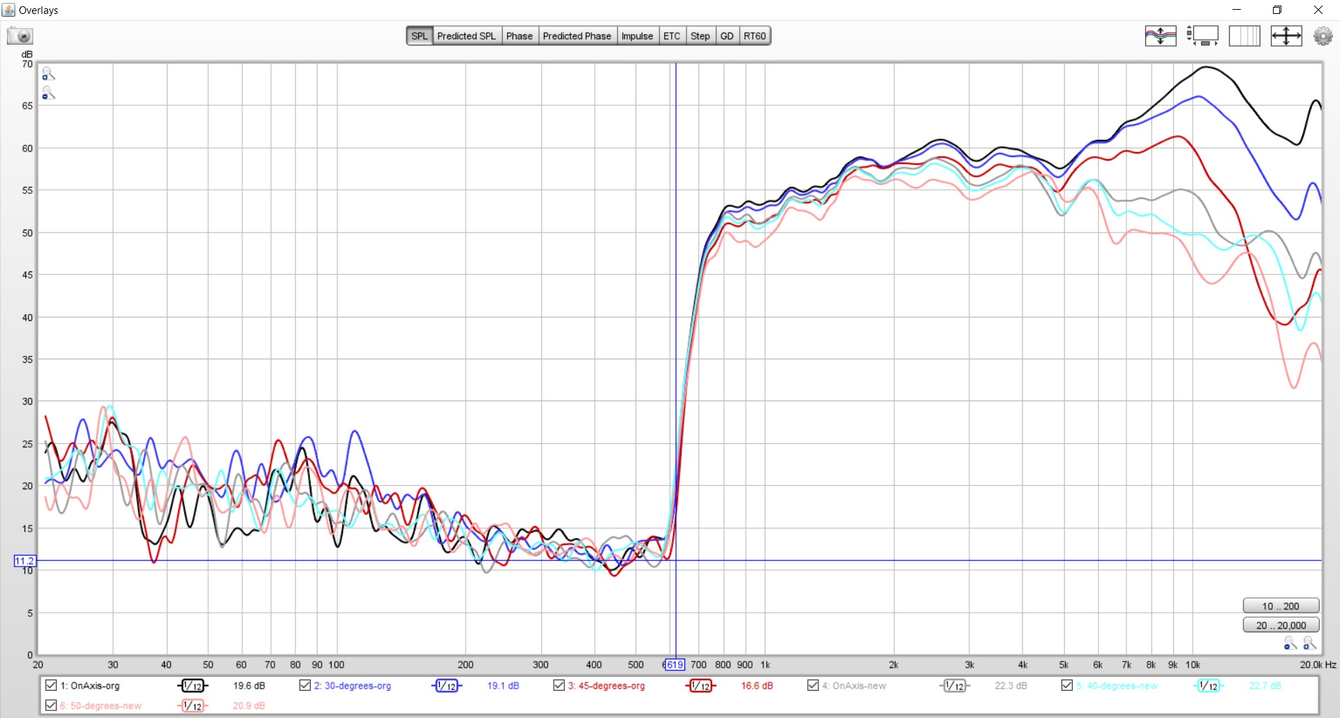

Anyways I have a pair of AMTPRO-4 and they are ok. The FR can be equalized as I'll be running active but the horizontal dispersion leaves something to be desired when compared to the NEO3-PDR and Fountek NEO X 3.0.

I took off the faceplate to the AMTPRO-4 and cut a new faceplate that had a smaller opening. Used foam board roughly 2mm thick which I picked up from the craft store. The original opening was roughly 40mm, the new opening is roughly 24mm. Attached are some rudimentary off axis measurements. The measurements were meant to be quick and dirty to see if there was a reasonable improvement in off axis above 7khz. Note: Angles and levels are eyeballed but shows a definite trend. Its a bit hard to read but........
Seems like the top octaves are reduced in overall level by what seems like a shelving filter effect. But the top octaves show an improvement in off axis drop off. Not as good as the NEOCD 1.0 but closer to acceptable. Notice the modified faceplate readings were rotated to more extreme angles than the original. I wanted to make sure I was seeing a proper trend. In fact the last reading could have been more off axis. Mic was about 1 meter away and levels were reasonably loud. Distortion did not change with faceplate opening size. Will have to optimize opening size if I'm to continue.
Question: If I make new faceplates for the AMTPRO-4, barring sensitivity, do you guys think a line array with the AMTPRO-4 is worth it based on the attached measurements? The price difference from the NEO3-PDR and Fountek X 3.0 is significant for me. Also the 3.0 is only front radiating. Are there better horizontal dispersion options for the roughly the same cost/performance that I am missing?

Take a look at the Aura NSW1 . Its a 1" full range driver that can be placed at a 40 mm pitch. I haven't heard them but they look good on paper. Use enough of them - I know that means using too many drivers but that is what it takes to do it right - and they will play low enough to cross directly to your woofer line in a 2 way config.
Directivity is simply a function of the radiator's shape and dimensions. The AMTPRO-4 is going to have very narrow directivity above 10khz because of that.
There's a few ways to address this:
1) Mask off part of the diaphragm with foam or felt, like BG does.
2) Build a narrow waveguide
3) both
Check out my threads on planar and ribbon phase plugs

The easiest way to 'visualize' what's going on is to understand what causes the narrowing in directivity:
pathlength
For instance, if one side of the diaphragm is one meter from your microphone, and the other side of the diaphragm is 1.01 meters from your microphone, you're going to get a dip at 17khz. This is because 34khz is 0.01 meters long, and when the pathlength difference is half a wavelength, you get a dip. (Due the 180 degree difference in phase between the two pathlengths.)
Hope that makes sense.
In the NEO3 PDR, all they're doing is cramming some felt into the side of the ribbon. The felt rolls off the highs. This means that only the center is radiating high frequencies.
Masking off the diaphragm with tape can work too, I've done that. The nice thing about felt or open cell foam is that it's an acoustic low pass filter.
Why do you want an acoustic low pass filter you might ask?
Well that gives you the best of both worlds:
1) it gives you the extended highs of the ribbon
2) along with the extended low frequencies of a larger diaphragm
Felt or open cell foam basically makes the ribbon behave like a crude coaxial.

I think the easiest way to deal with the AMT is to use Patricks idea. Take off the faceplate, black tape the opening to the desired width, re-install the faceplate. The faceplate is aluminium. I was toying of the idea of getting custom faceplates done to reduce the center to center spacing both horizontally and vertically but that is cost prohibitive.
