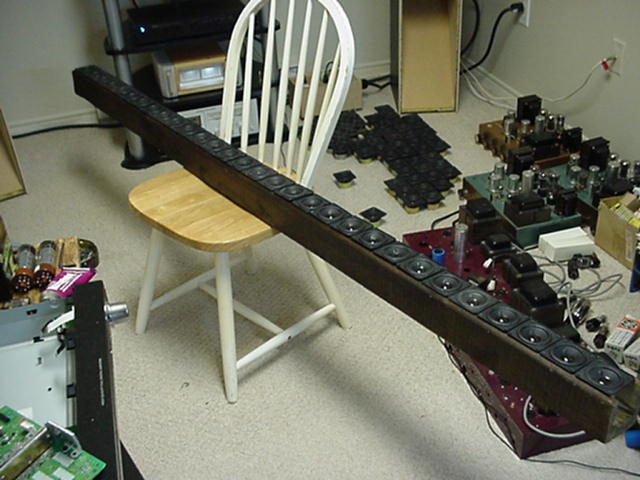

hey, do you guys know further specs of those $1 4" fullrange buyout drivers in the partsexpress catalog? (#269-734)
so far i haven't been able to find any info on these drivers except for what's on the catalog (it's not even listed online):
i want to do something real similar to the style of the Kuze3201 Line Array on partsexpress:
http://www.partsexpress.com/projectshowcase/Kuze3201/Kuze3201.html
except with 4" drivers and a bit less...unfortunently i have a tight budget.
any help would be great. thanks!

Crazy man! 30 drivers a side I love it!
With those P.E. buyouts, that's only $60 worth of drivers for stereo. Serious fun.
Read the nflawp.
Notice that the Parts Express project uses radical equalization to counteract combing.
In other words, you can't just line up a bunch of cheap drivers and expect it to sound good. You need to approach it a little more carefully.
Carefully read Jim Griffin's comment in the following thread:
http://fullrangedriver.com/forum/viewtopic.php?id=591
