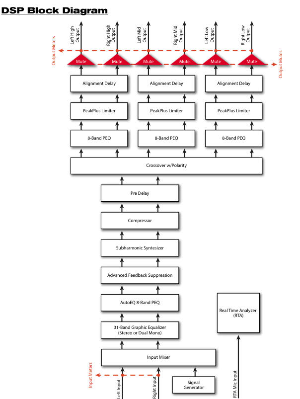

Limiter for a PA system
Never having to get near a system's limits is both the best protection, as well as best assurance for sonic fidelity.
In an ideal world yes.
Until costumers start using your floor monitors as mains, something they were never designed for. (in sense of continuous maxSPL and heat).
Which is the main problem.
You can design a nice sounding and balanced product, but as soon as the guy behind the mixing table decides to completely torture that with some horrible EQ settings, you are very happy that you build in some proper protection.
But yeah, in that case you also want to make sure you have plenty of headroom left.
They go hand in hand, therefor I always find these generic non-active speakers performing meh at best.
Reactions: stoneeh
I think the explanation is pretty clear and obvious and it directly gives an answer to the topic starter.
Except that it isn't. You're too eager to make yourself sound smart and completely missed the fact that the OP didn't ask about using the compressor in this unit he asked about using limiters. If he had asked about using the compressor I would have suggested bypassing/disabling it beause it's the wrong tool for the job and has more cons than pros in this implementation.
My response spoke to using the limiters(plural) which are on the outputs and are almost the last item in the signal chain, all points you and others completely overlooked in your rush to criticize.
