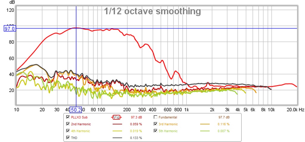

I agree that very low distortion bass can be produced by horn loaded drivers. But I disagree that you can't get powerful non muddy bass from a subwoofer. It really depends on the design. Take this one that I built with sub-percent distortion at 97dB at 1m with 2.83v drive. It's actually capable of pro level SPL and still remain clean. You certainly can hear all the bass instruments clearly when this is paired with a good low distortion top in a FAST.
Do you have any distortion measurement of your BLH?

measurements outdoors seem ok and pretty good. The DUT must develop enough power to overcome ambient noise but would be no problem during quiet times even with smaller fullrange measured at 1 & 2M. The result seems at least good enough in the bass to establish cutoff/rate, etc. Its good to do them when the temperatures are like comfortable room temps.
How do 20Hz-40Hz square waves measure with this set up?
Can you post IR.wav for this measurement?

What are test conditions?
What level of cancellation have you achieved?
Let me see if I still have the data file for this measurement to pull the IR wav file.
I am not sure how it will do for square waves. Those are very hard to achieve at bass frrquencies because it means phase flat at this frrquencies. Very few speakers are phase flat 40Hz to 100Hz.
