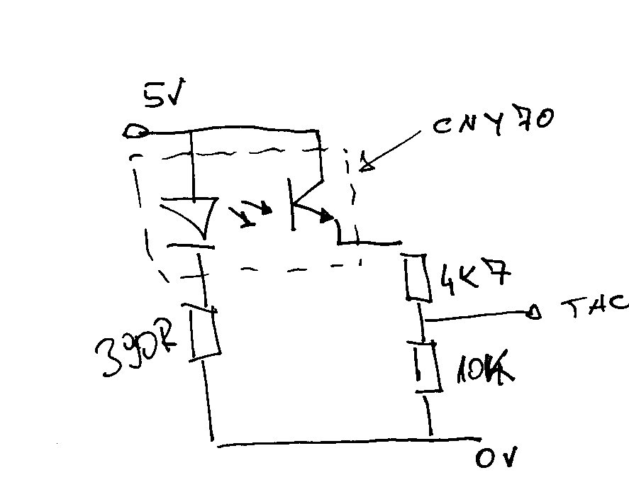

One very good thing to report is that Richards's tacho + my sensor make very precise average speed measurements (it measures time passed for 1 rotation of the platter).
I continuously checked signal from test LP on scope and display of Richards Supaspin, the speed always matches exactly. Also very nice is that Supaspin adjusts frequency for 0.01 Hz by one click of rotary encoder, utmost sufficient to fine tune TT speed with ease!
This is very simple diagram of sensor. CNY70 is brought to about 2 mm from platter and on platter I put just a piece of black electrical tape, it works aplomb. Reflection difference between white stone and black tape is good enough, for testing at least.
4k7 resistor should be replaced with 3k3 or similar to bring trigger TAC voltage to about 3.3 volt, but Supaspin doesn't seem to care, it registers change in V as it is.

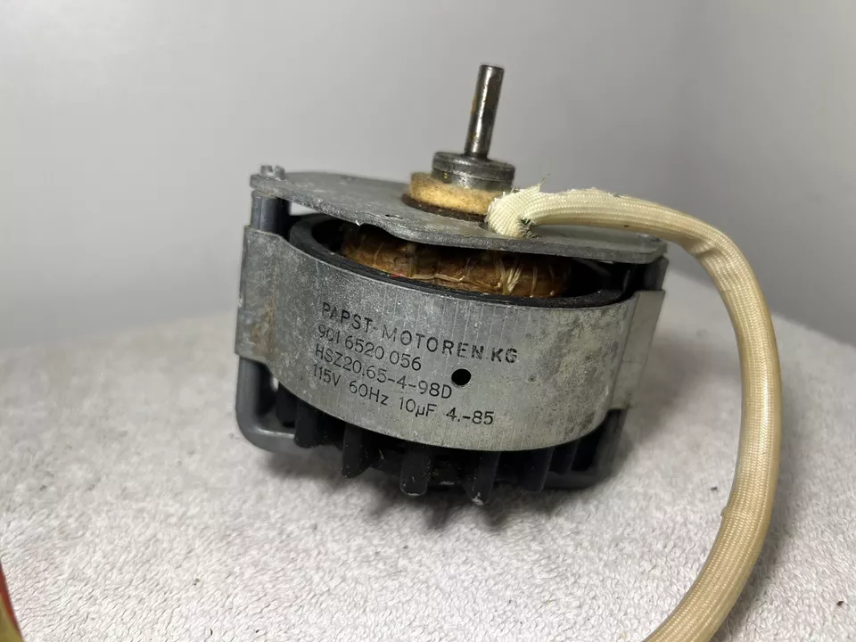

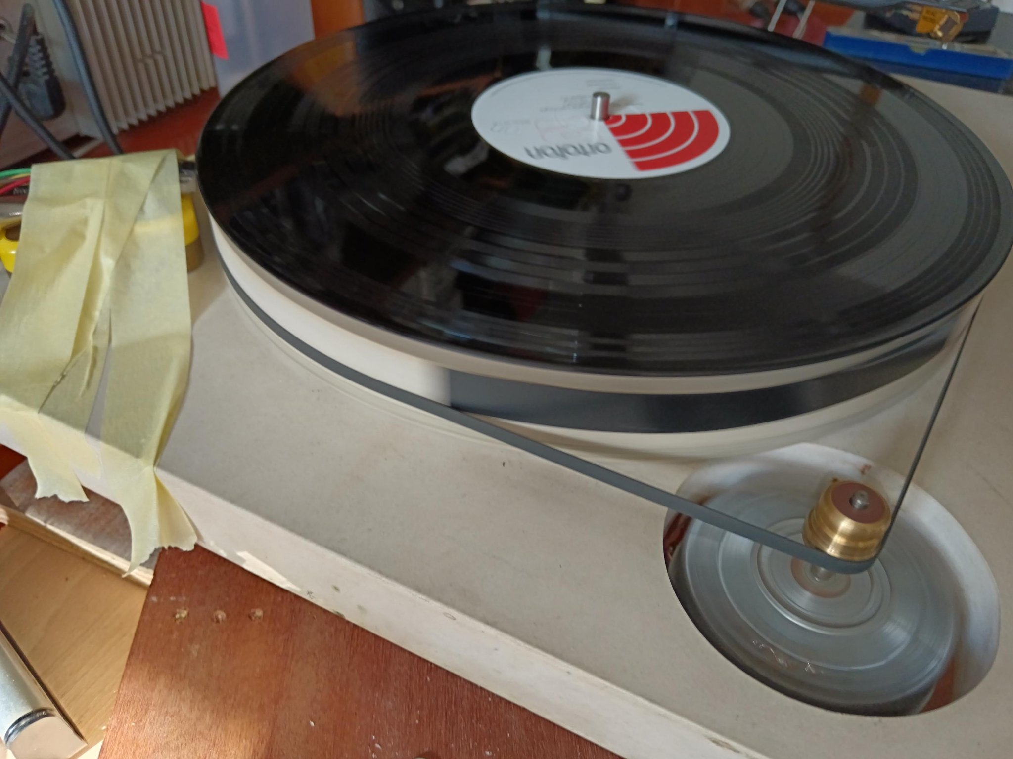

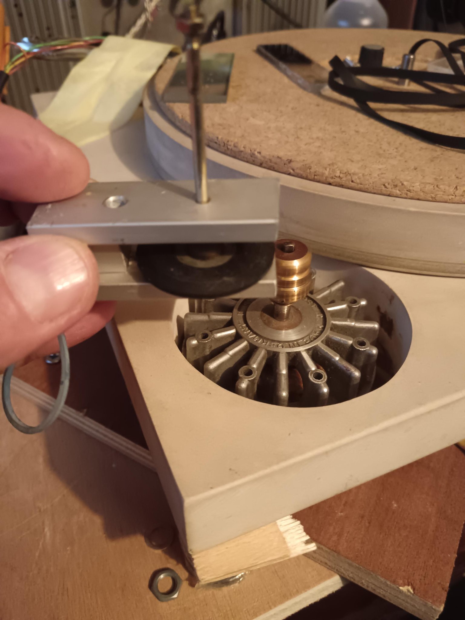

Next I connected vintage Papst asynchronous outer rotor (picture in post #55 and elsewhere), also this one is now running with flat 5mm belt and much smaller pulley (18mm vs 40mm with previous motor).
Papst is very stable and vibration free when holding by hand. In order to make it completely silent I run it at 40V RMS 3 phase (it is made for 165V) and only 20 and some HZ. It is big enough to manage such huge reduction in power, after all it was made to fast rewind big tapes, that takes much more watt than TT.
However, even this looks like more advanced solution, measuring "dance" when playing 1kHz signal stays almost the same, about +-4%

While old Papst has slight improvement, still super cheap capstan motor from Philips VCR is better:
  • Small improvement could be due to better belt too.
  • Papst needs about 40VRMS, small Phillips I run on just 5VRMS which allows for cheap chip power amp for cars to run it. For paps I would, or need to invent high voltage amp, or add 3 transformers.
  • With Papst being asynchronous, setting exact 33.33 RPM becomes a continuous hunt. Speed depends not only on frequency, but also supply voltage (which is admit-ably easy to make fixed). It could be solved with servo feedback, but it would open another can of worms (kind of worms that are not good for fishing).
As next step I will continue with small VCR capstan motor, cut unnecessary parts off and machine pulley for flat belt.... Then we will see...

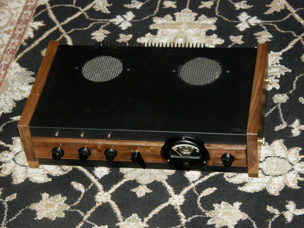

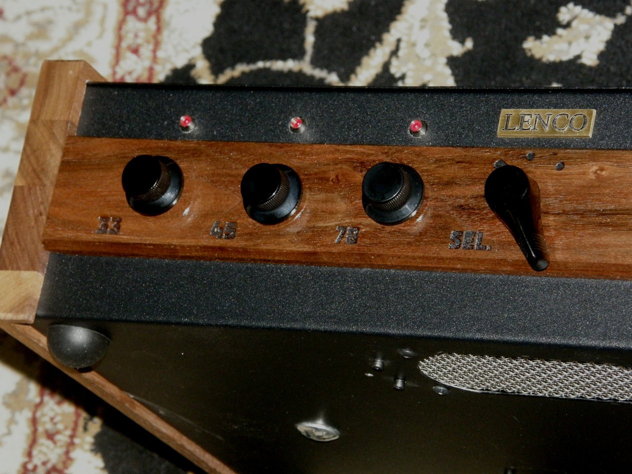

I just can't help myself. Years ago, I made a speed control for Lenco TT. It wasn't cheap, and yes, I made all the wood parts myself which can be nerve racking. The end result is something that is well worth considering on such a high end TT.
Guess what? I had to look all over for a lever that 'matched'. It is indeed an old radio lever of sorts, and not a Lenco. I just really don't like the 'modern' plastic ones. No thanks. Now the Lenco name plate I don't recall where I got it, but it too was a bit (understandably) pricey.
I also got pretty nervous drilling two large vent holes in the top panel. One slip and everybody knows it.

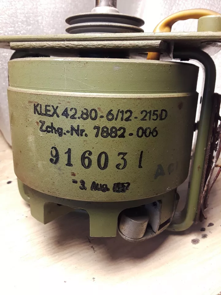

In the meantime I run also capstan motor from rare Sony HD digital video recorder, No 4. from post #50.
While it is much more robustly built and more powerful than cheap VCR motor, it does suffer from vibrations and noise. It can be heard and felt in the hand. When pressed against work bench it rattles the bench. Not very much but it is obvious and not observed with VCR motor.
Is it because ball bearings it uses, or something else, I don't know, but it is discarded.

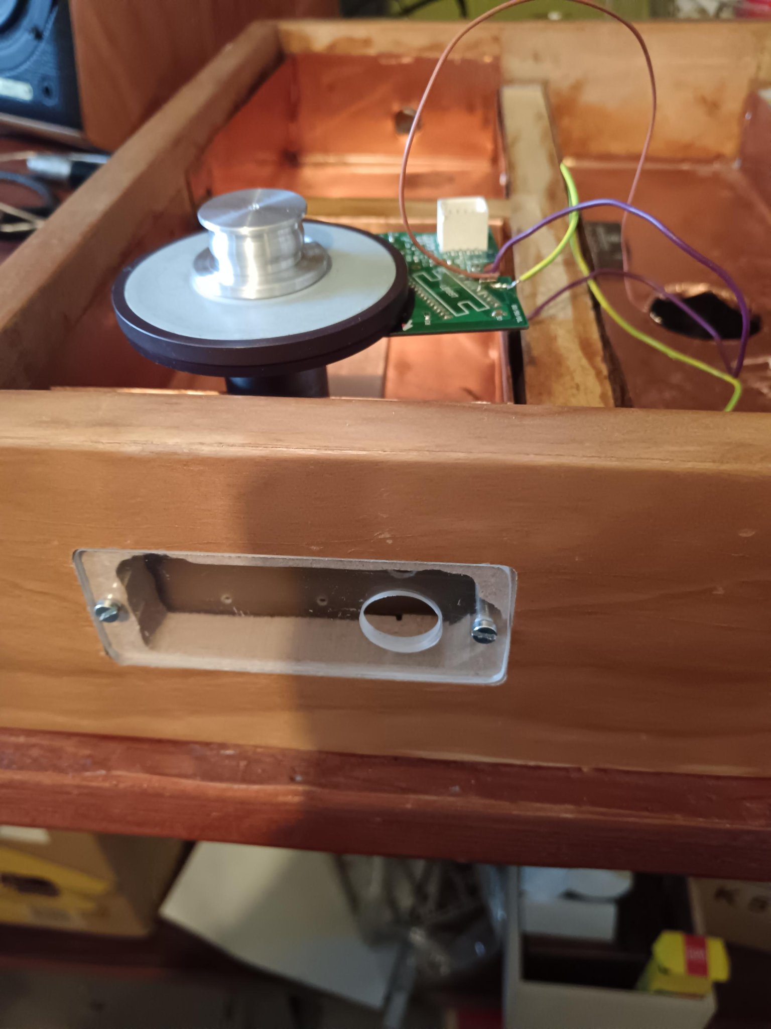

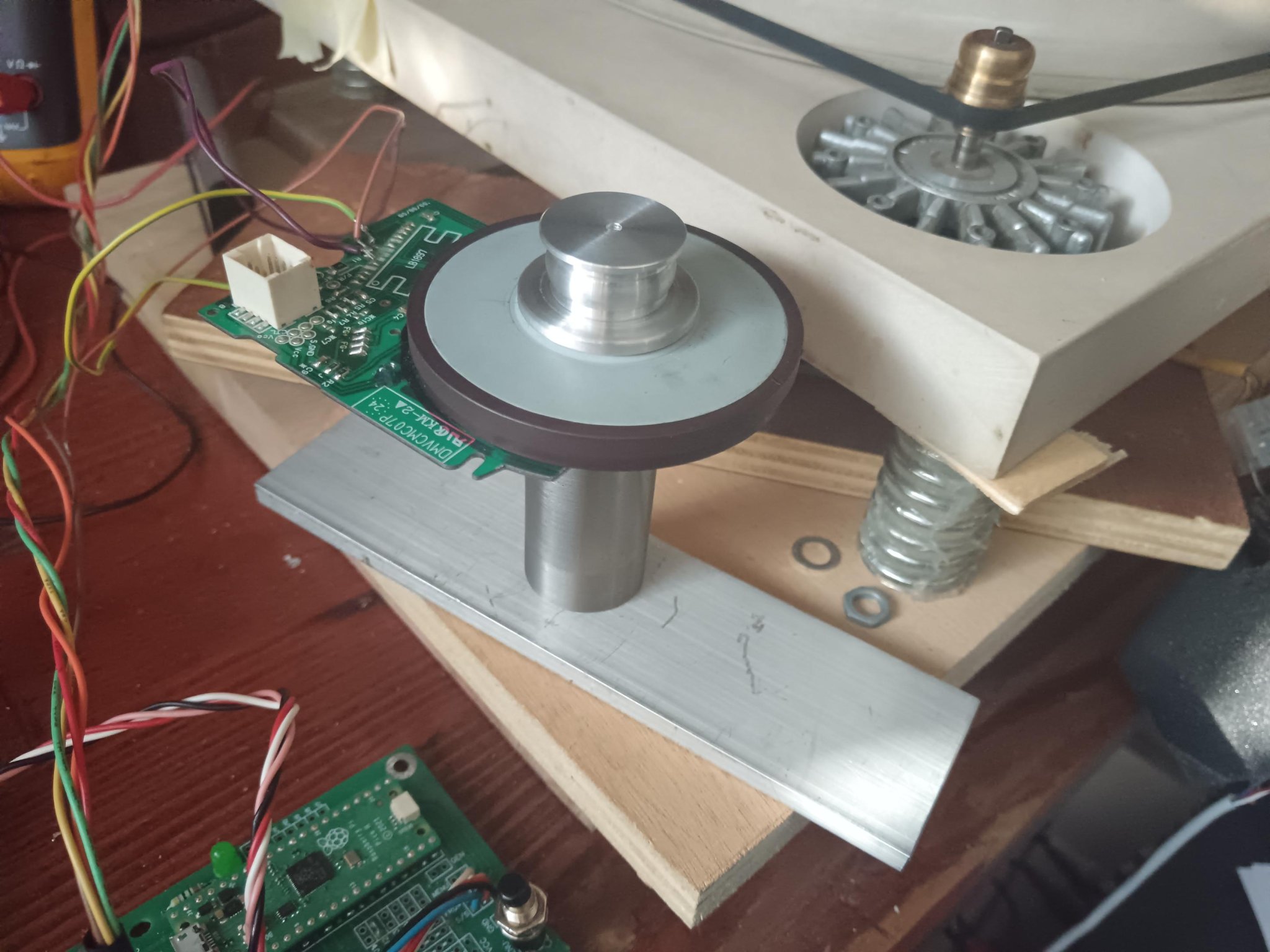

Finally pulley and motor base arrived just before holidays. Mr "next week" did not become Mr "next year" 🙂 Ill play with this when back home.
For the record, this pulley and base cost me 50 Euro, I think complete motor, Supaspin with Rpi and OLED, amplifier.... altogether did not reach 30 Eur...

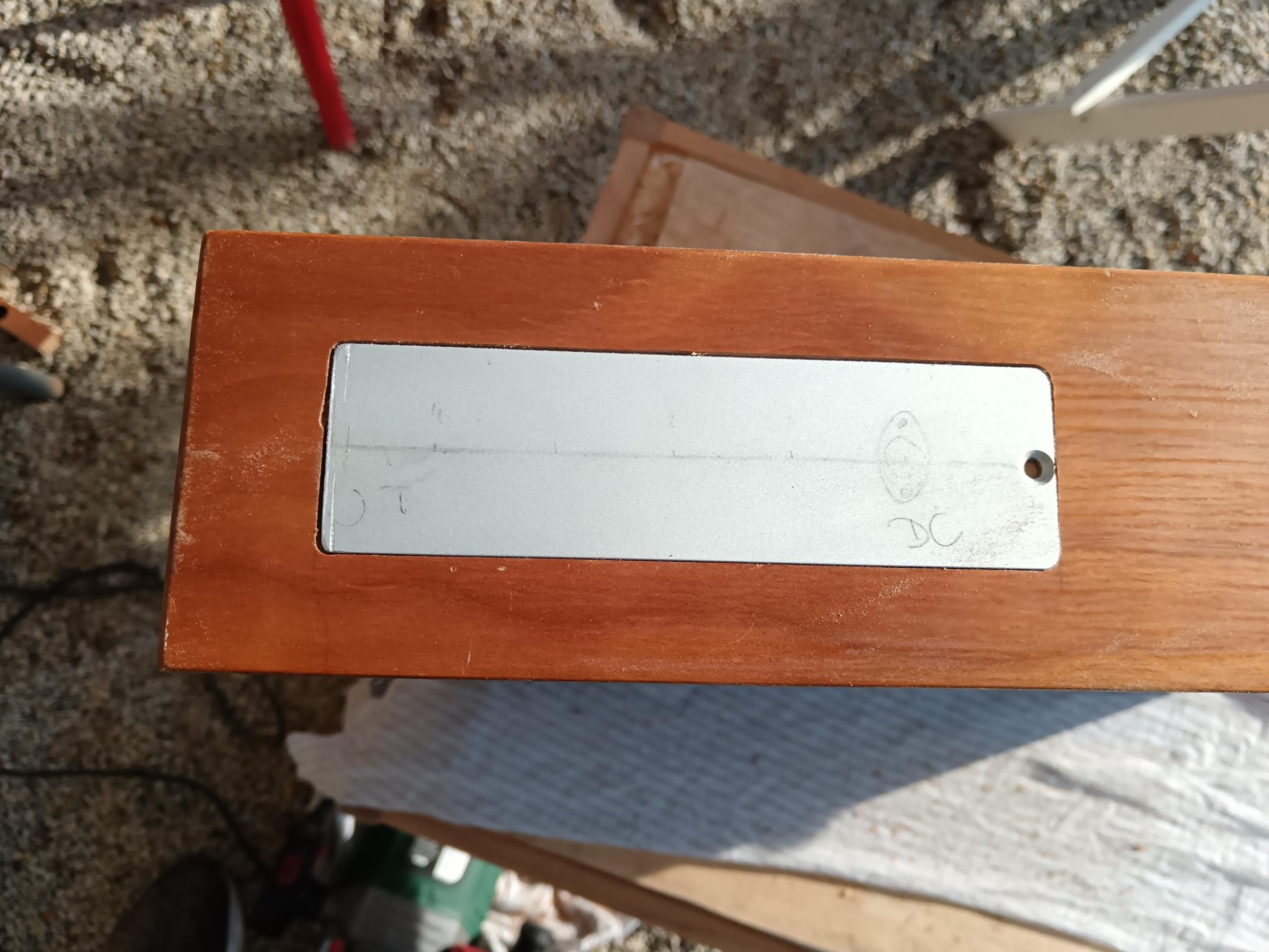

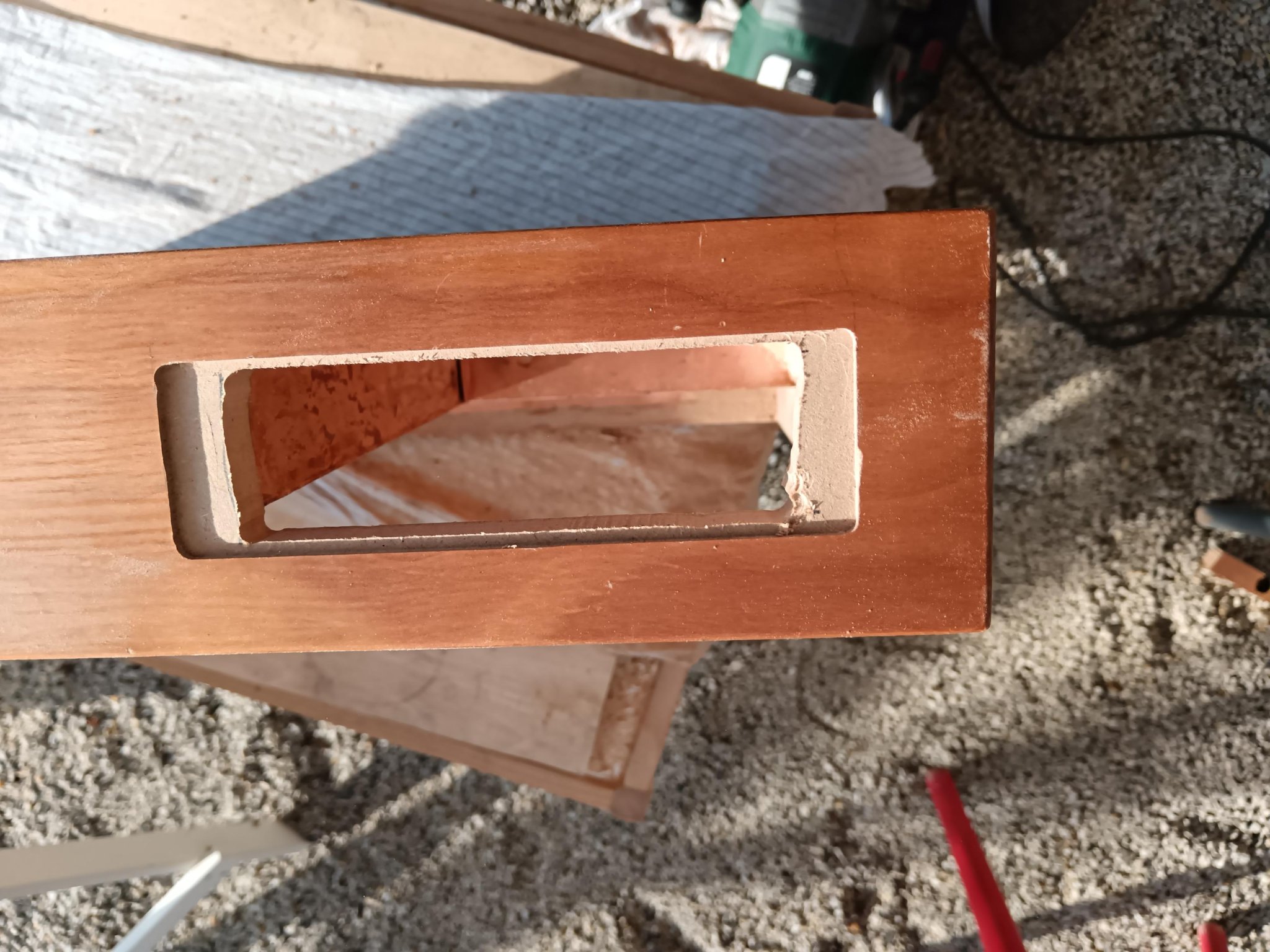

What I managed to do, and I was avoiding for long, is to slot my TT chassis to accommodate new parts.
I was so afraid that veneer will spline and I will have to do it all over again, but luckily it survived routing.

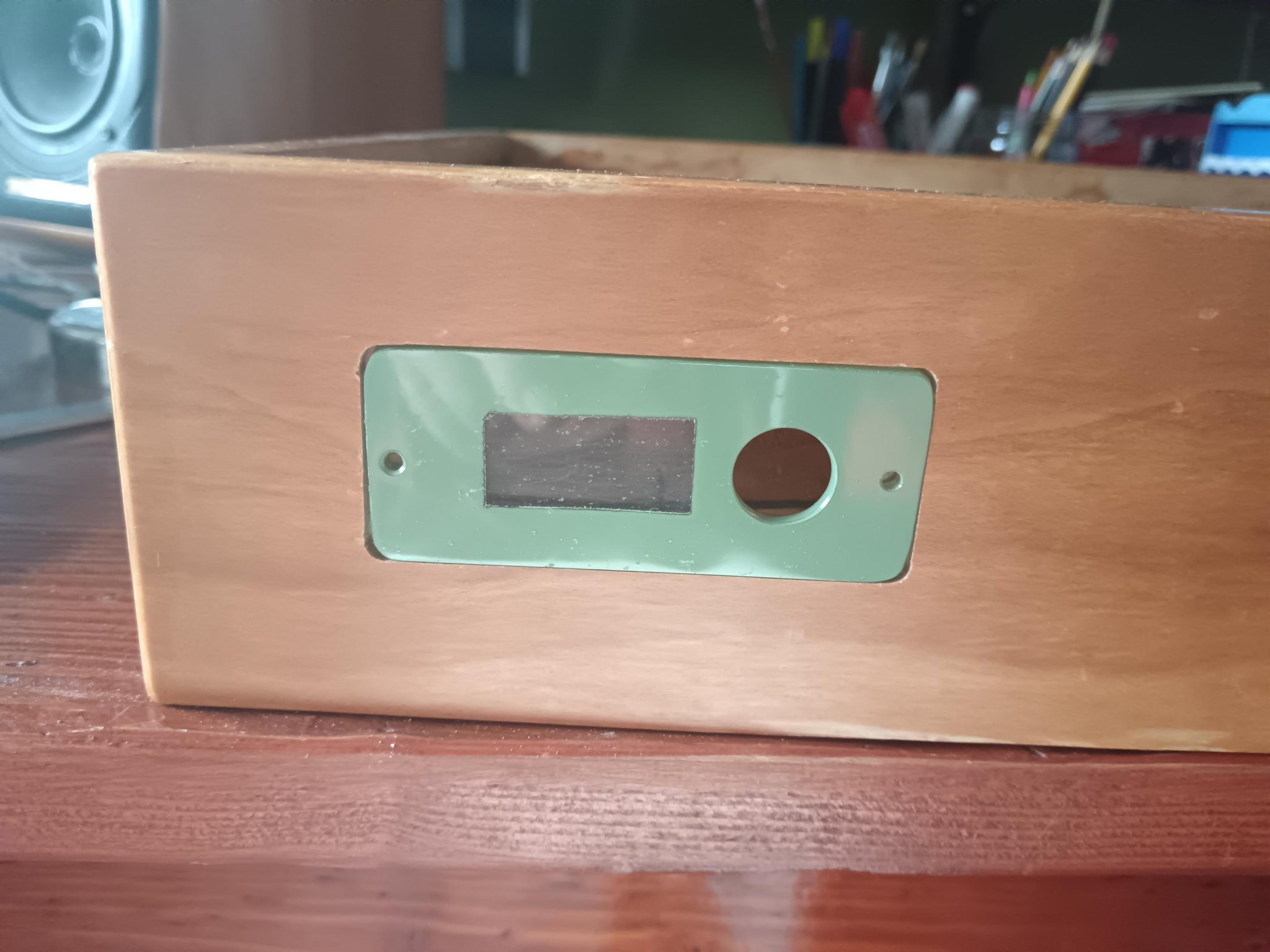

On front side I opened window to accommodate SupaSpin display and rotary encoder. The setup push button I will put on the backside near PS input as it is not used daily.
I will make new plastic window to fit slot perfectly, this is just trial. I'm choosing color 🙂

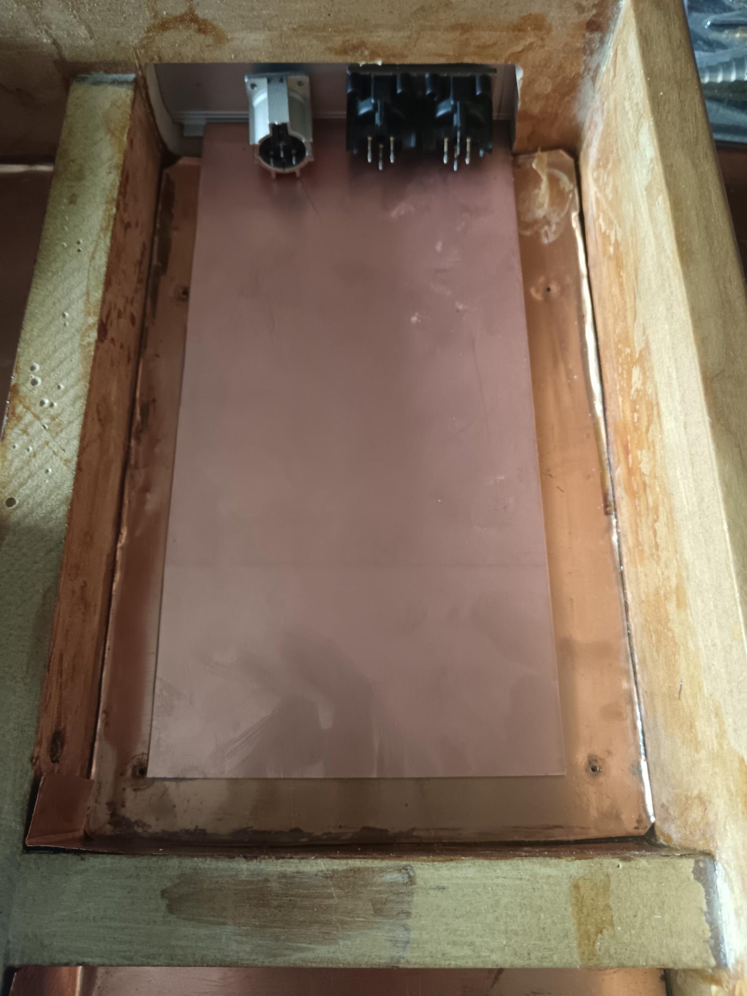

On the back side I opened bigger hole that will accommodate amplifier in drawer fashion, so I can pull it out and modify when needed:
This will carry large 10 X 21 cm PCB that will serve as base for preamp and 3 x XLR jacks, 2 for signal and one for external PS.
