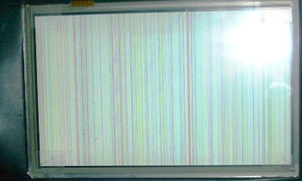

first, be careful w that lil brown ribbon cable. maybe there ist the fault.( broken )
try to fix it w some scotch tape in the position its lays originally.
second. check the other ffc-cable on proper adjustment on the controller-board as well as on the lil pcb.
do not move the lil pcb as far as not unconditionally necessary.
hope that helps abit.

thanks for the ideas.
will try to carefully set the small LCD board in place and hope that i haven't broken the brown cable
when you saw the stripes. was it fixable?
yes it was fixable coz the harm on the brown cable wasn't too hard.
where the brown cable is bent some cables were broken. under pressure of a sticky tape the contact came together and a picture was seeable. if you fix it this way, never touch it again ;-)
sticky tape around the brown cable and afixed in the original position

sticky tape in the original position (no tape on brown cable)

not wrapping.
put the brown cable in the position it was before and put the tape on top of the brown cable and stick also on the lcd wher no pixels are.
sorry, for my bad english. i havn't got another explanation. ;-)
i understand,
stabilize the connnection between the lcd and the brown cable by taping the cable to the LCD.

Sup guys, i have the lilliput 7" XGA,
i have a slight problem, i opened it up to look inside, took the 2 ribbons out, and the mains to the backlight,
i put it back together and now it dont work, i get power, it turns on, i can get audio through it played from my pc, but no picture, i can use the buttons on the front, but cant even bring the built in menu up, any ideas, i've just ordered a new ribbon, hoping its that,

@ the matza,
in case of no harm due to static discharge, try to adjust the ribbon( 40core) in the plugs. that often causes no picter. it is important that the ribbon ffc is right aligned w the according pins of the belonging plugs. it's abit tricky.

yea i'm kinda hoping thats what my problem is, i've ordered a new one, so that should be here soon, a lot longer so easily to mess around with,
