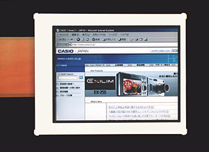

330000 pixels
Somebody should get one at that price. I rather doubt the 330000 pixel claim. That would be much higher than you would need for such a tiny display showing video. Most non-technical ads for small TVs and monitors for your car overstate the number of pixels by counting each subpixel. So they count one RGB pixel as 3.
If you see a value for the pixel size, and it is exactly square (or close to square), then it is probably real. You can calculate the true native resolution: You just divide the horizontal and vertical dimensions by the pixel size.
2.1 inch, 640x480 resolution
