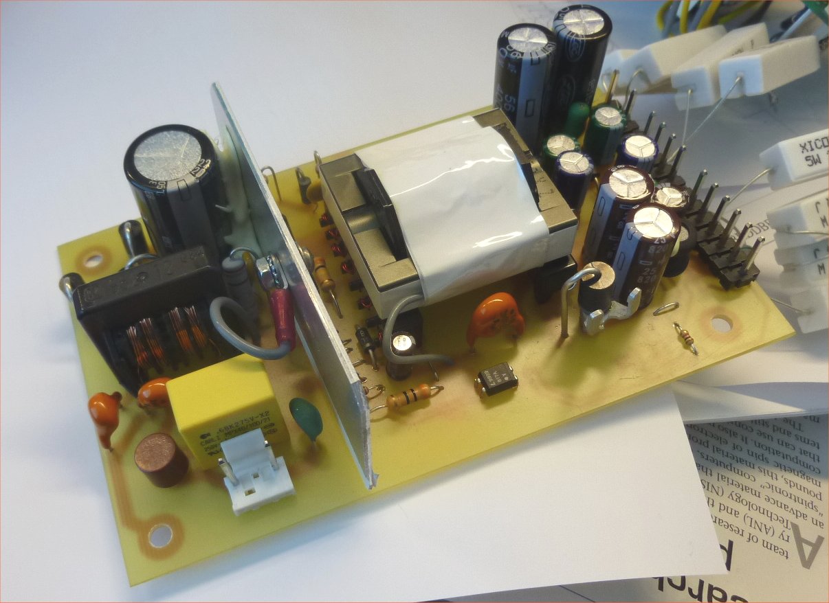

Here's the SMPS I ginned up for the Devil, a quasi-resonant flyback using the ST L6565 controller chip. I need to figure out how to best incorporate the rest of the below-decks components before this amp will come together.
You might consider the use of a ground plane in future designs, it's critical for high frequency circuits.
Ground plane is anathema for SMPS. I've advised customers over the years (30+) that built their SMPS on ground plane thinking it was the be-all and end-all, and it isn't. You need to tell the currents explicitly where to go, especially in the secondary circuitry.
Making the comments you have, it's obvious that you don't do SMPS for a living. The majority of designs out in the world are on a single-sided PCB, and a competent designer can get them to work just fine - its the "competent" that can be a problem...
When I get to it, I'll show the back side of the SMPS board in question - not that difficult if you know what you're doing. Having said that, there's some undocumented features that won't be divulged involving magnetics design among other things - don't want to mess up retirement income...
