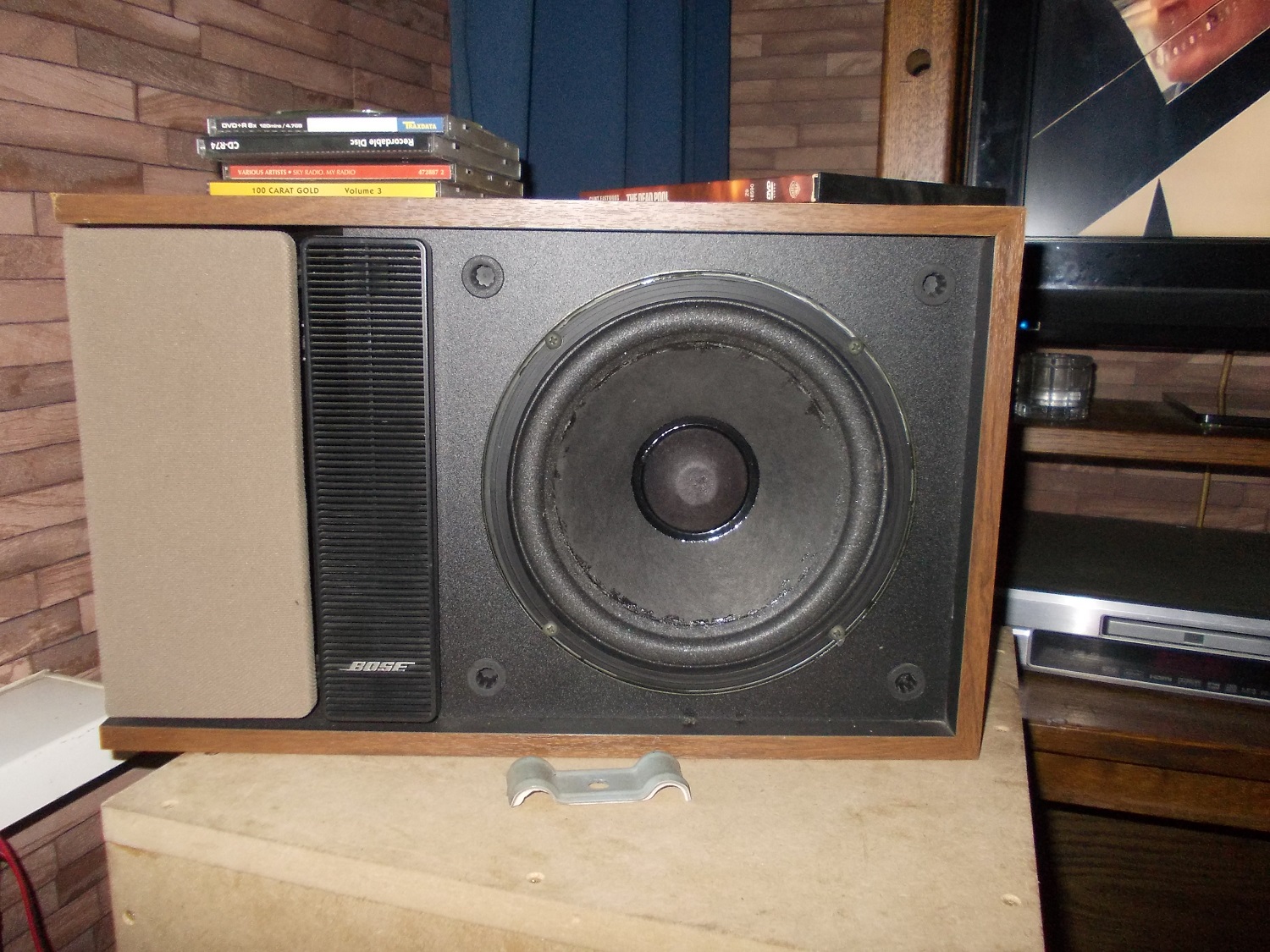

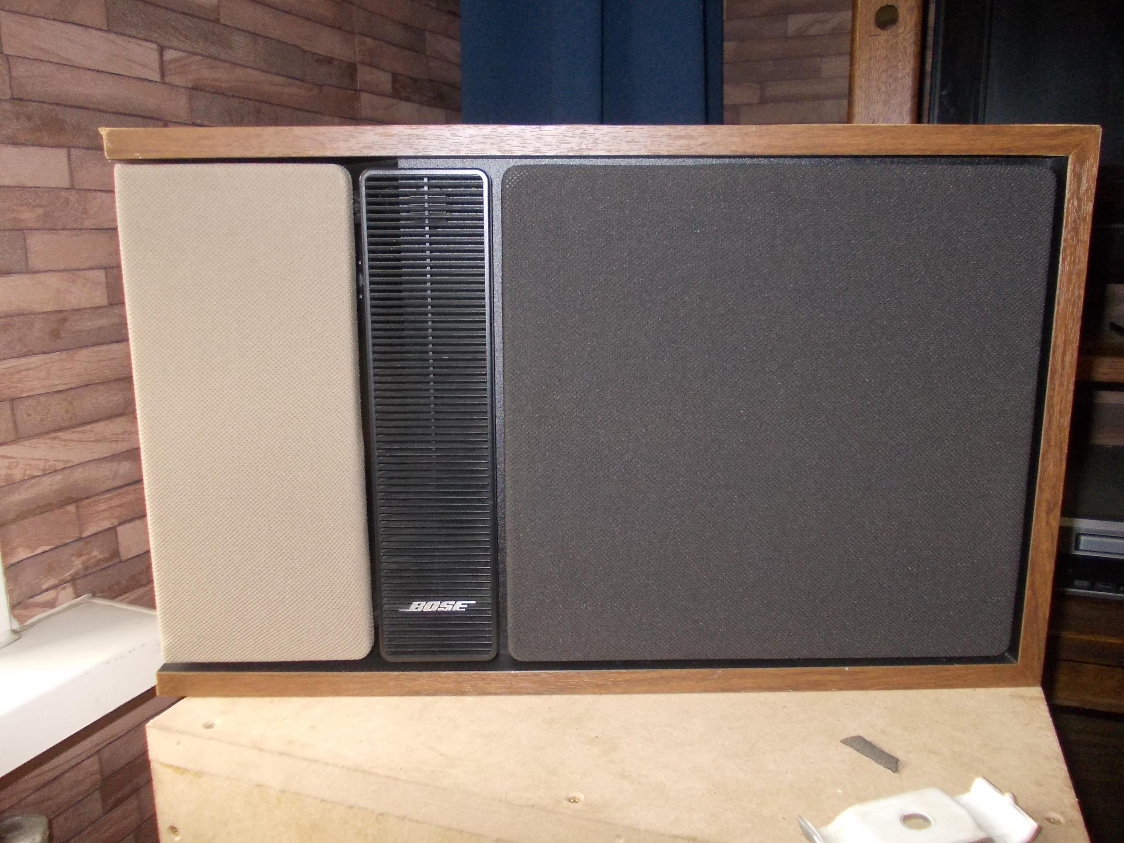

Did buy these old bose 301, getting start to restaurate, woofers need to be refoamed, old one is complete gone.
These do sound nice, I did always like them, from 1975 so very old.
Like the good old days, better for environment.
regards

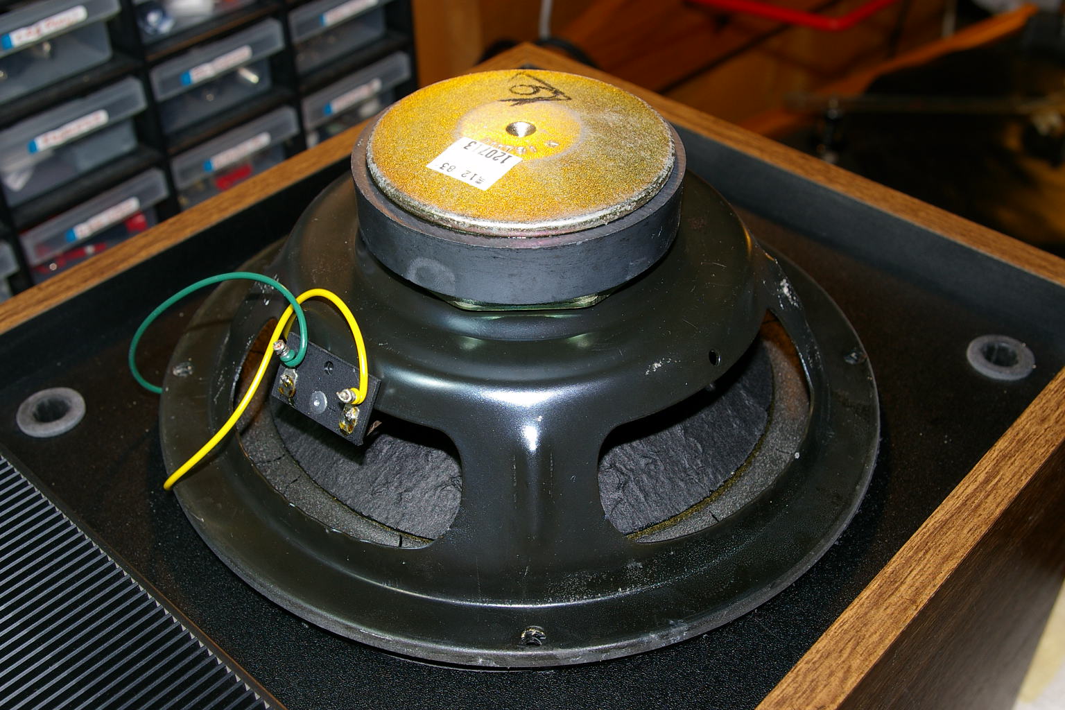

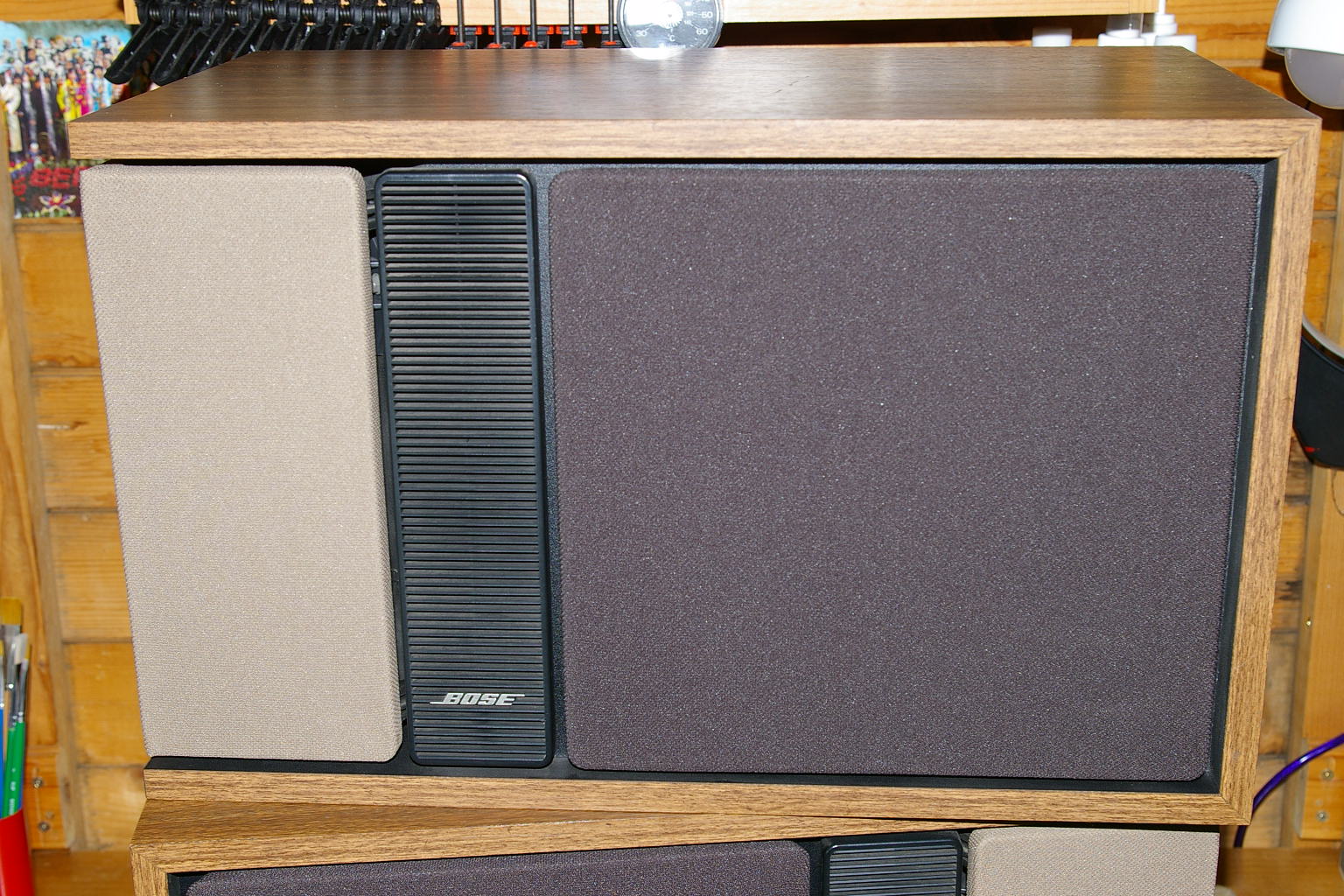

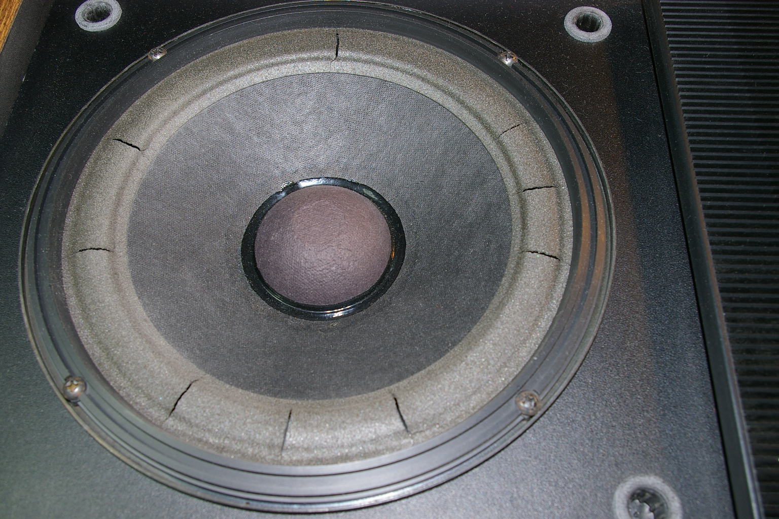

Installed new foam surrounds in these for a friend.
Easy job as the bass/mid cone self-supported firmly on its rear suspension and I had no need to remove the dust cap to use shims.
Sounded excellent when finished. P.S. I left the tweeter's series film capacitor and ceramic resistor alone!

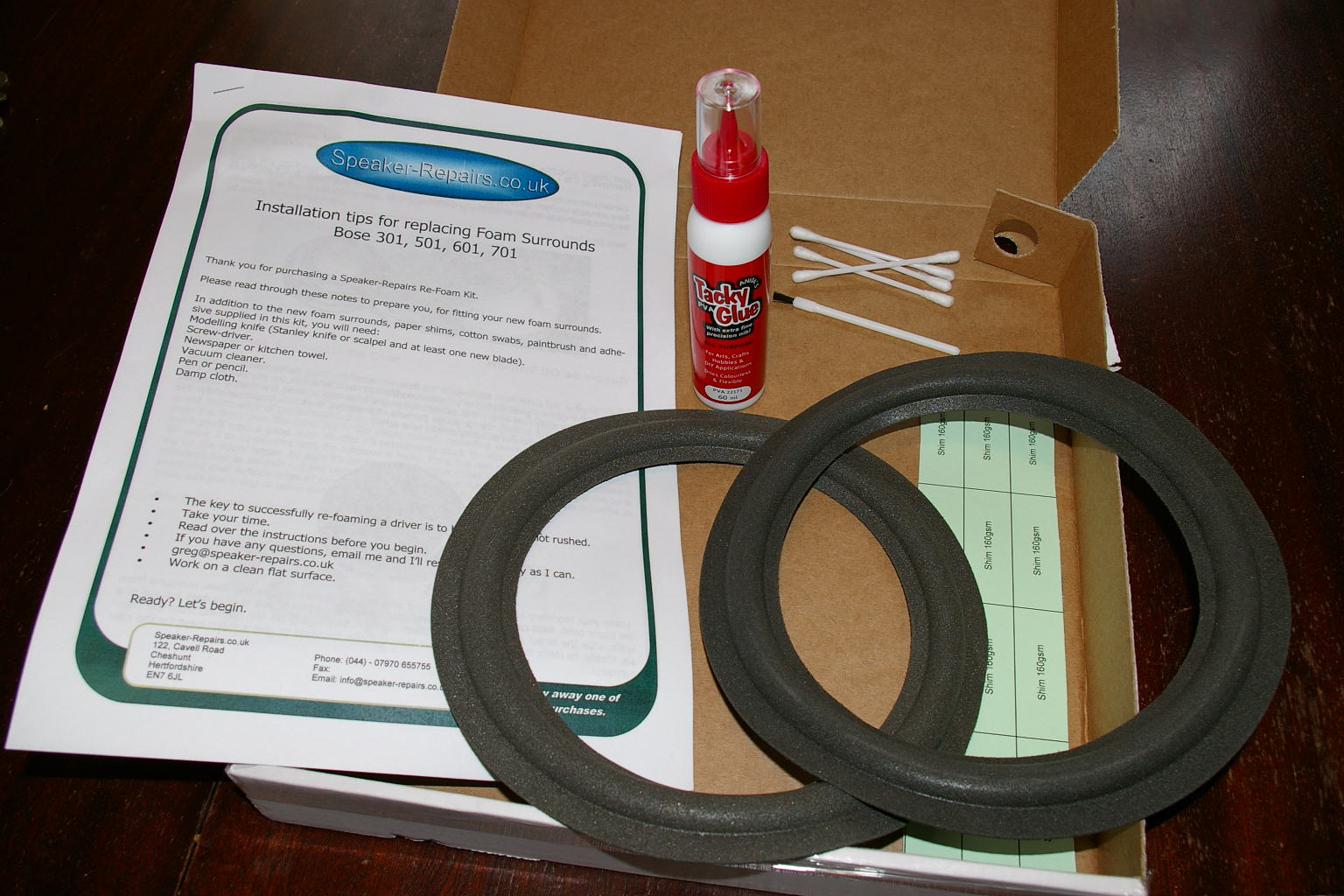

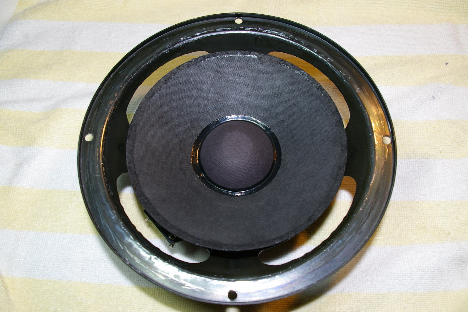

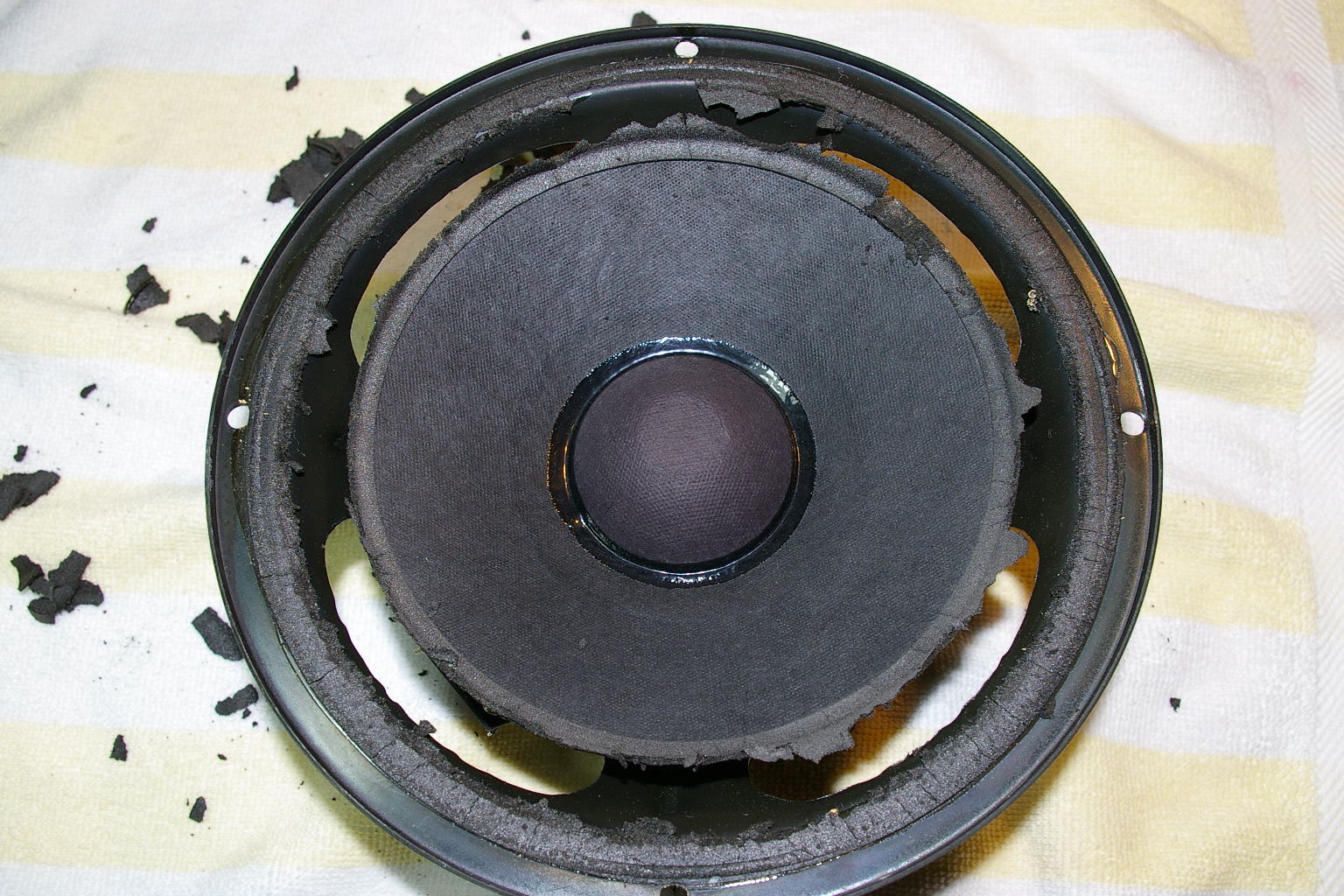

Here are some photos of the re-foaming process to inspire you. 🙂
