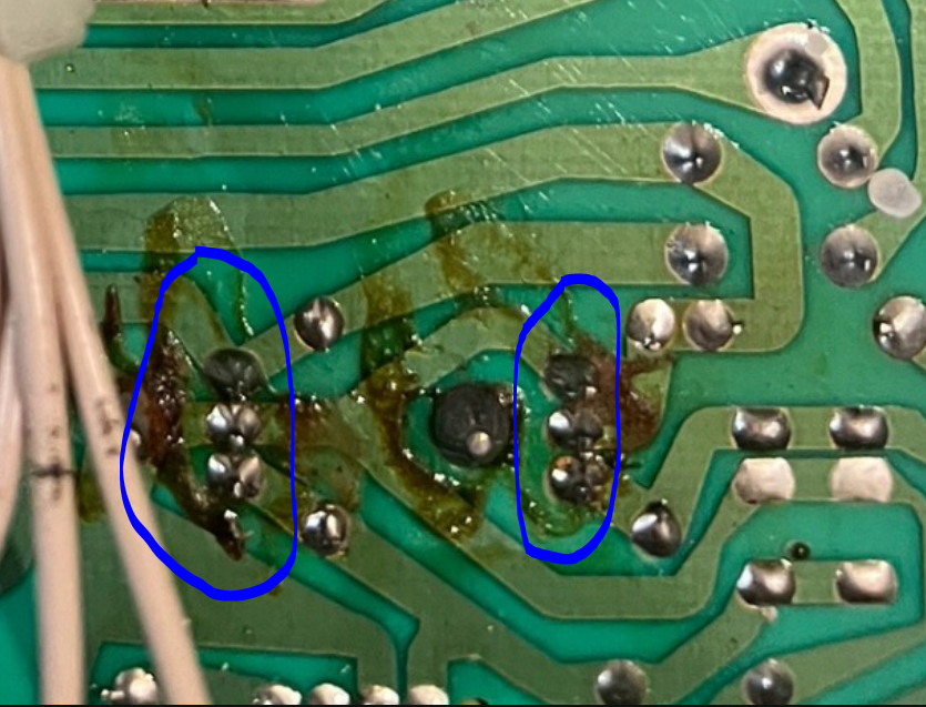

Like New old stock NAD 2700 - works in 4-8ohm setting - stays in protection mode at 8-16 ohm setting
I think they are TO220 transistors... someone replaced them at some point...
