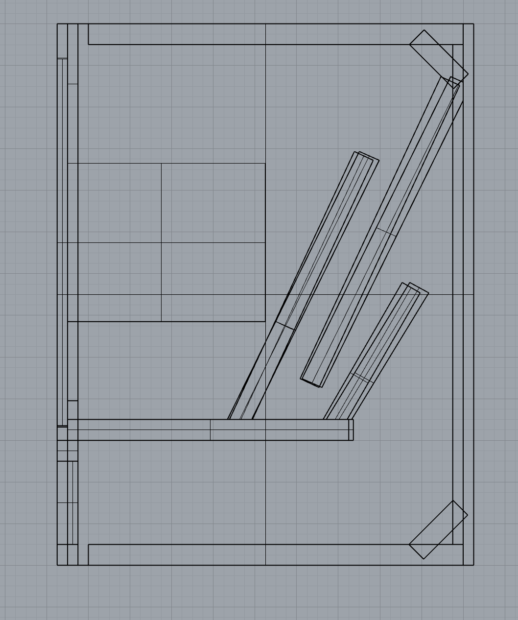

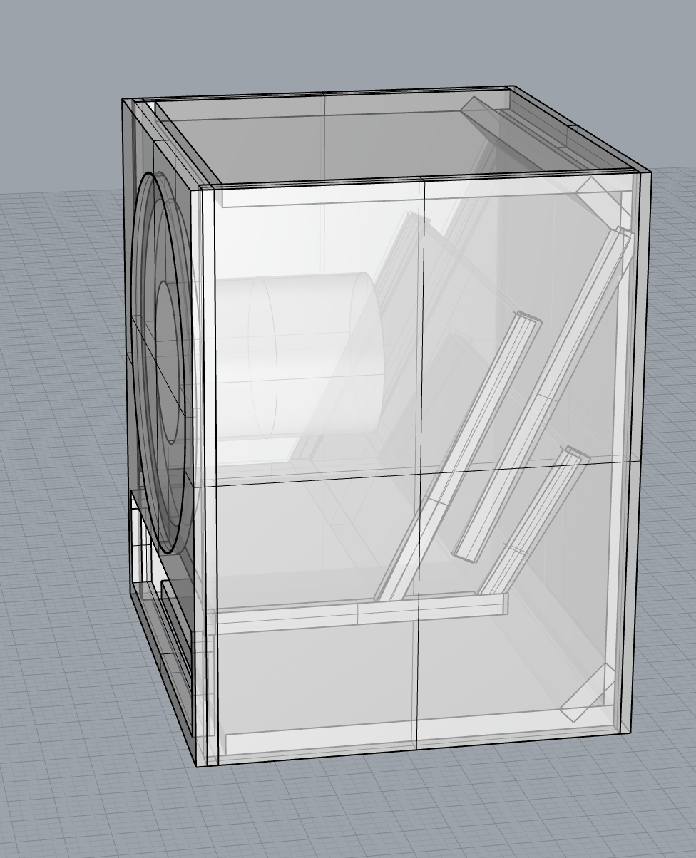

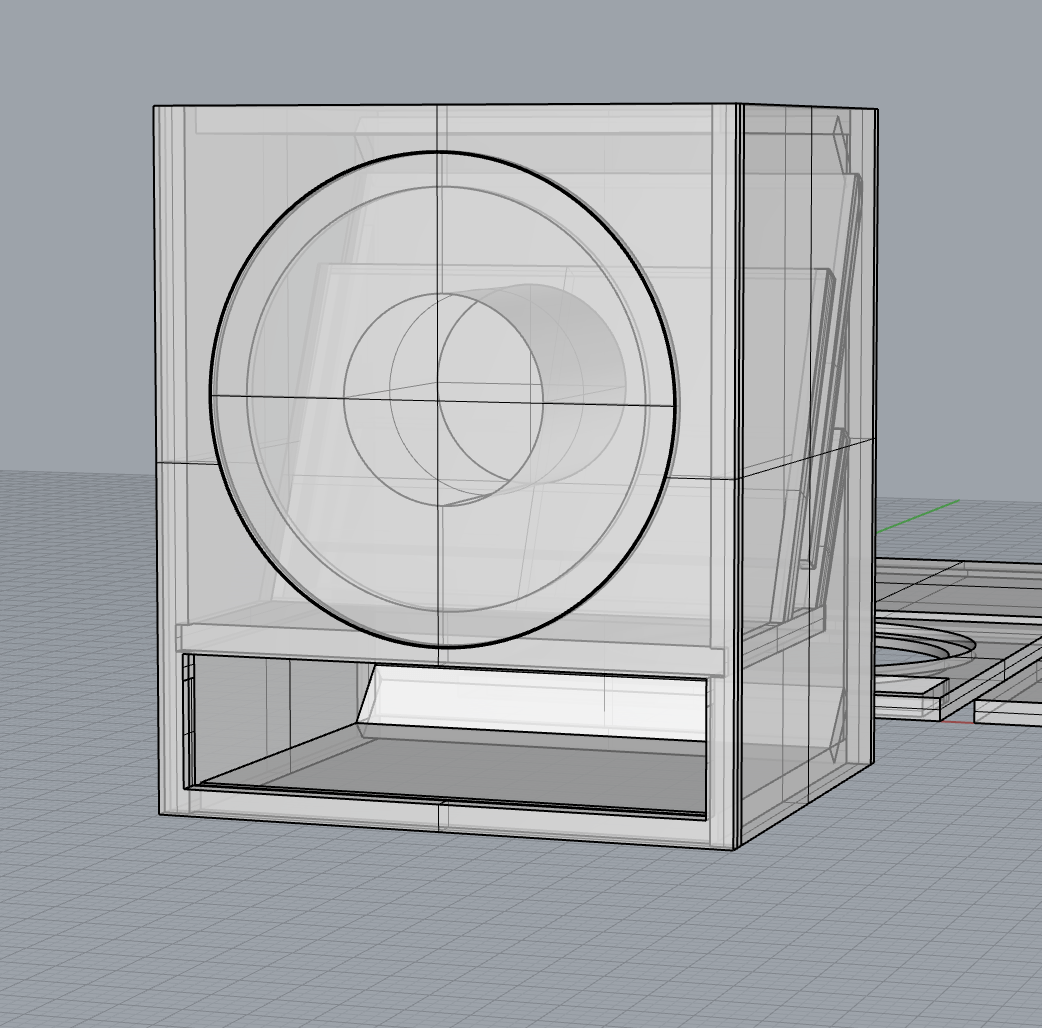

The smallest ported box that I see, which will yield a fairly smooth bass response is 22 liters, with a port tuned to 50~52.5 Hz. That tuning could be accomplished with a 3" diameter x 6.63"~7.5" long port. The F10 will be 41.6~42.6 Hz.
Most of the specs I used are on the top of this page
https://www.lii-audio.com/product/one-pair-new-8-fullrange-drivers-premium-level-sound-silver-8/
Other parameters are on the Notes section at the bottom of the SPL/Z plot.
The 8.5 L / 70 Hz vented has a slight (2-3dB) hump in SPL between 125-250Hz, which may or may not be desirable.
The 22 L box / 50Hz doesn't show a hump above the tuning freq.
I usually try to avoid any hump in the raw box sizing, but 2 or 3 dB may not be a problem.

Hey!
This designis 22L ... how does it look to you?
13 H x 11 W x 10 D

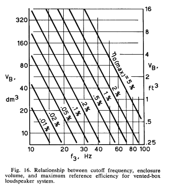

OK, I just used the requested 8.5 L as an example WRT max available system efficiency.
