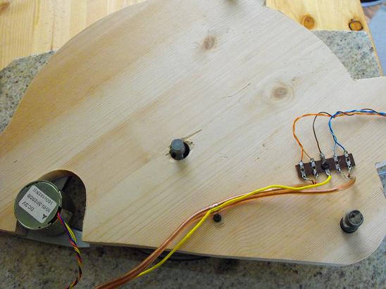

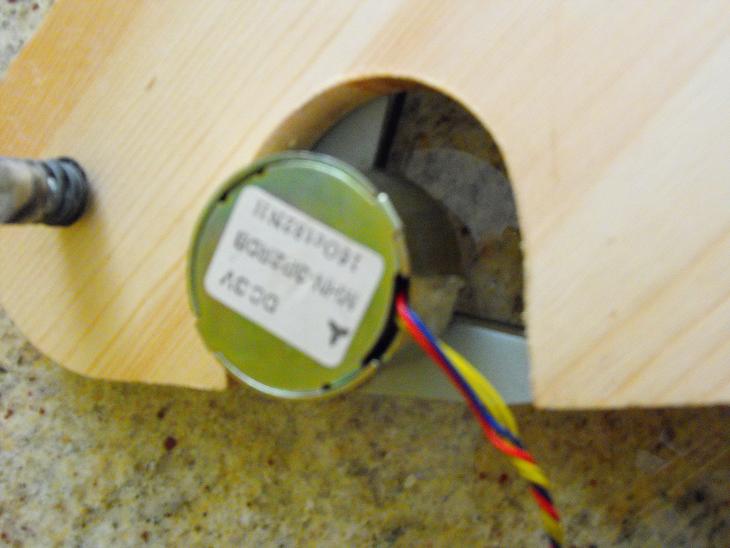

and one of the motor cutout - first from the top...

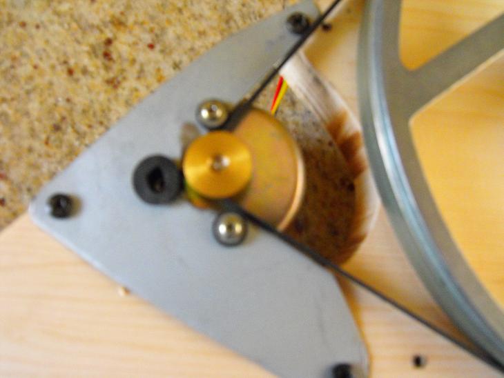

The grey mounting plate is, in true flyweight fashion, a peice of thin sheet steel cut (with scisors) from the bottom-panel of a cheap receiver.
The mounting gromets are the originals from the B&O table.

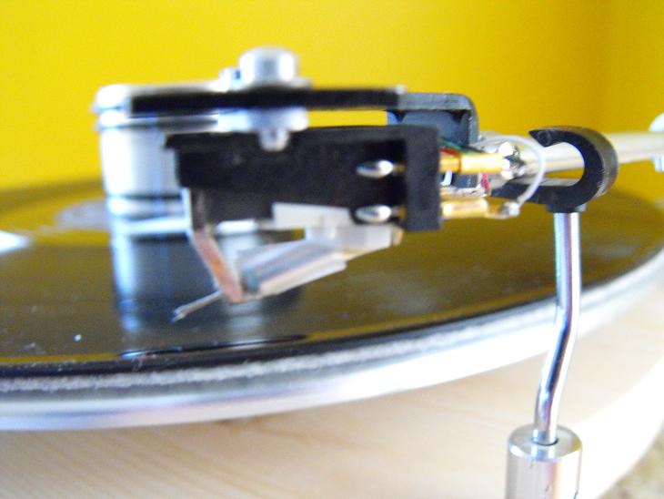

and the last refinement (Ok, I might varnish it - or I might not
) happened today - I mounted my nude Denon DL-103. How does it sound now? Even better!
I got to do about 3 hours of critical listening today and ran through the whole gamut from Jazz to Rock to Classical. This little table realy cooks - amazing detail, very stable soundstage, excellently musical. And I don't know why the DL103 has a reputation for being bass-light - it sure isn't here.
