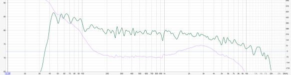

I'm building a lightweight, portable variant of Scott Hinson's 'MEH' design that he shared on his DIYRM page on Facebook (https://www.facebook.com/DIYRM). The PDF is here: https://drive.google.com/file/d/1nE...lkT3rECpb8WYPMgiS_8pSvRAGxZkbaGmzzkCrsYXF9w8o
Looking to swap the B&C 10nw76 drivers for 10cl51 (saving nearly 2kg per driver) and the DCX354 in place of the DCX454 he uses, saving another 2kg... a total of 6kg saving!
I used his parameters in Hornresp, but with he 10cl51 specs, and got a plot with similar or better SPL from 55Hz upwards. See image below. Left hand side is the plot from Scott's instructions with the 10w76. Right hand side is my plot with the 10cl51 specs.
I know the 10nw76 has more power handling, but I'm limited to 150watts, which is the max my battery powered TPA3255 amps will supply per speaker. I'm happy to pair with a sub and/or use a bit of DSP to fill in the bottom end (with boost, or psychoacoustics)
Am I missing anything? Any issue crossing to the DCX354 at 400hz, instead of the 300Hz possible with the larger DCX454.

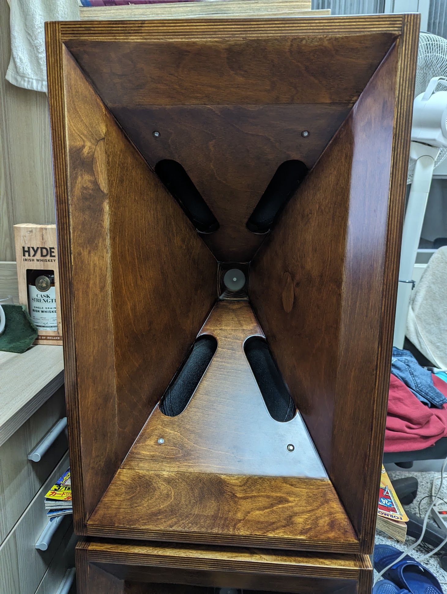

310hz from woofer to MF on the DCX, then 4k between MF and HF on dcx. I had the latter point at 3.5k originally but I saw a post suggesting 4k was better. After DSP the results were similar. I do have protection caps on the DCX. Btw the 310hz crossover is not ‘negotiable’ if you want to retain the benefits of a single apparent source in this synergy horn in this design… the separation of the woofer ports in the horn are too far apart to cross higher. (Same reason I had to go with the 464 instead of the lighter 354 I’d hoped to use)
Reactions: bitinhvi
Not sure where you’re getting 380hz from, but I measured the maximum distance between the centres of woofer ports in the horn as approx 28.5cm on my build which gives a minimum crossover to the compression driver of 300hz for a maximum of 1/4 wavelength spacing according to omnicalculator. My measurement is diagonally from the centre of one port to the other. I may have that wrong but it seemed to make sense to me.

View attachment 1253445They’re beautiful @yys310! Love the antique looking natural wood finish! Amazing you can drive them from the headphone amp, but grab something more potent because these really sing as you push the volume up… to my ear there’s so little distortion at higher volumes it’s kinda addictive 😍 I’m a big fan of the tpa3255 boards from 3e audio - recently reviewed by Amit on audio science review and measured brilliantly, especially for the price! Did you use the B&C dcx464 crossover?

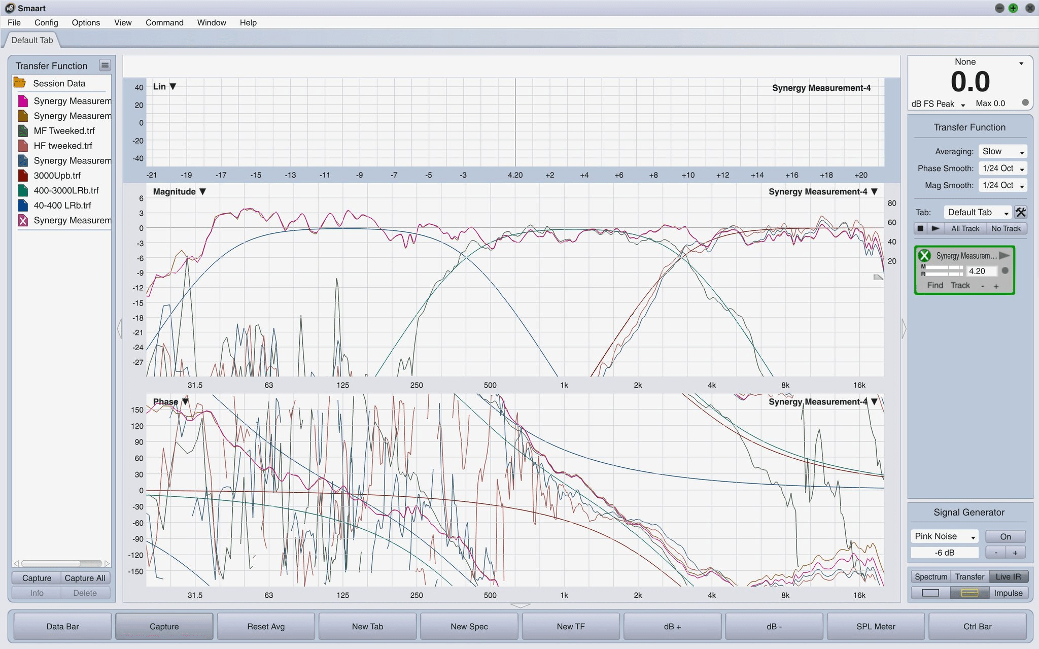

I was just guessing from the graph posted on DIYRM, not a accurate value. From the graph it seems it's crossed at 400Hz, previously I use another app with similar scale to guess the crossover frequency by Scott.
If we calculate between 250Hz and 500Hz the 2nd line should be 250*2^(2/3) ~ 396.85Hz.
The 1/4 wavelength concerns me also for the tap port, not sure if that's so strict. Maybe I should try to cross lower in the future.
The original crossover setting from Scott has 2 2nd order high pass filter at 310Hz.
