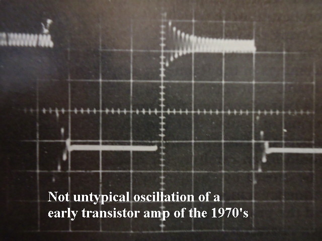

In the 1970's car light bulbs were often used in series of HF crossover networks to protect the tweeters from the oscillatory effects of the new Solid state amps, and there were alot about. pic encl.
Every amp builder should be aware of such nasty effects.
richy
