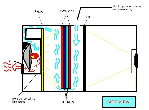

Im having trouble, i think, in understanding the airflow i n the PJ, i tried drawing a diagram of what i think you meant, so tell me if this is correct.

Your drawing has the general idea, with air flowing over the LCD, fresnels, IR glass, but it is not flowing over the lamp surface.
It is a better idea to enclose your lamp with a metal box (where ever possible), so you can push or pull all the airflow through the box right past the lamp surfaces. Of course, you do need a hole for the light to get out, but you can put a pre-condensor lens or IR glass over that hole. The metal box limits light leakage, and heat getting transferred to other parts of the projector. The free air outside the metal box and the high airflow inside the metal box keep it fairly cool. (Don't make the mistake of lining a wooden enclosure with sheet metal: The metal heats up and burns the wood.)

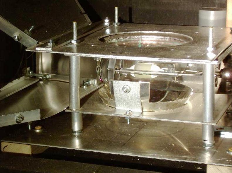

Here is a picture of my light engine, with the front piece of the duct removed. (It would normally cover everything you see.) There is a fan over to the left that pulls the air through the box formed by the top plate, front & back duct pieces, and the plate holding up the reflector. So all of the air flows past the lamp surface. There are multiple layers of metal and free air space between the lamp and the bottom of the wooden enclosure. That is my IR filter right above the lamp. The larger cutout above that is for a pre-condensor lens.
I have seen many light boxes that are much simpler, but they all do the same thing: Hold all the optical parts to keep them aligned, and control the light and heat leakage.

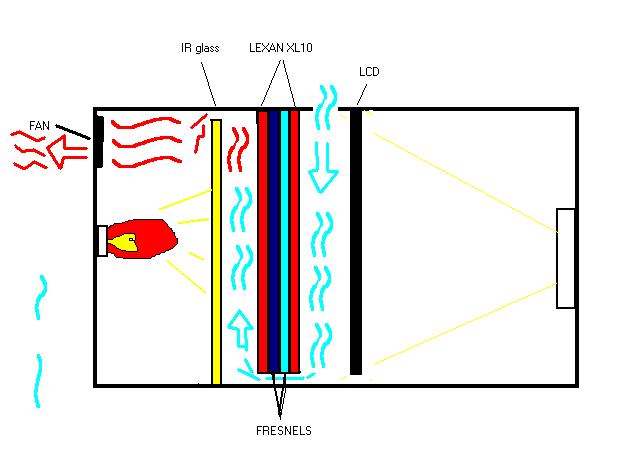

Ok, i re-did my picture of my airflow setup, tell me if this is better. I know its not accurate but the basic idea is what you have to look at. Any improvements or comments are very much welcomed by anybody.

That looks better. I suggest you try it with just the one fan, to see if anything gets too warm. Then you can add a pusher fan if you need it. (Fewer fans = less noise.) Like I said, I make do with one 65 CFM fan in my 250 Watt projector with a standard inductive ballast.
