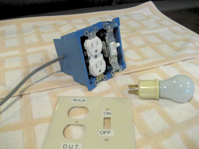

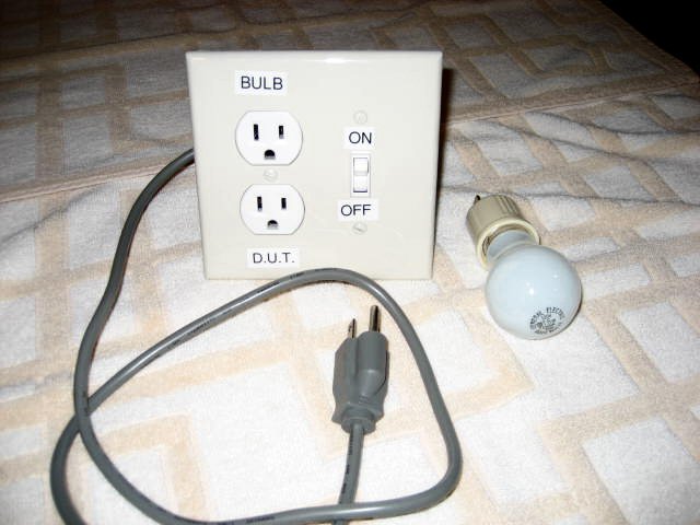

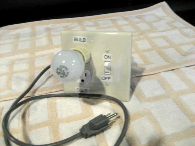

Here's mine; most parts were bought at a Home Depot store. I bought a plastic junction box, extra deep, for insulation/safety. There are no exposed conductors except for the AC mains receptacle. The photos show a 25W bulb; I bought several other wattages for testing purposes.
Before you ask: D.U.T. means Device Under Test. That's a new amplifier or other piece of DIY audio gear, which is being tested. Its AC mains plug goes into the DUT socket.
_
Mark-
That looks excellent!
The bulb holder you found covers the bulb base well.
With the one(s) I bought, some bulbs had part of the metal base showing, so I added some tape to cover, after getting a bit of a 'buzz' one day.
Just a FYI for folks reading this.
Great little tool for the shop; every builder should have one. Keeps some of the excitement away!
Is that mains rated cable?
It looks more like low voltage cable.
Yes, it's part of the new electrical code in NL to use that color coded stuff. My uncle is an electrician, and this is some left over stuff we used to wire my dad's cottage. 🙂
Looks like audiophile grade speaker cable to me 😛
Lol, it sounds "warm" and the bass transients are "deep".

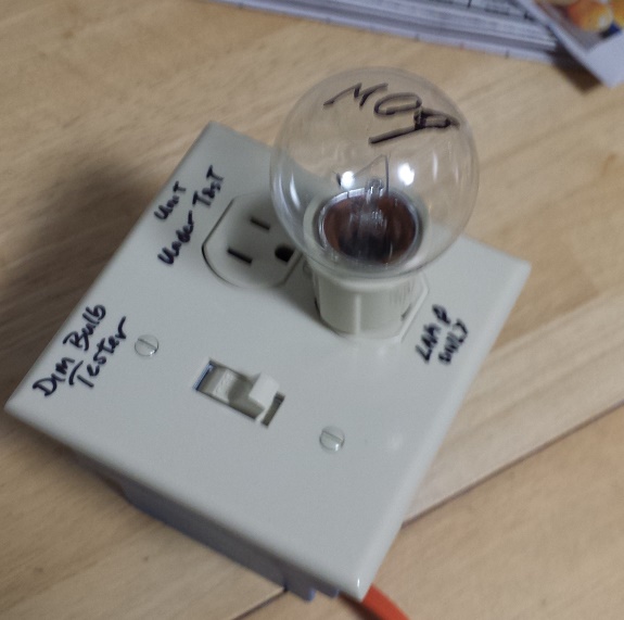

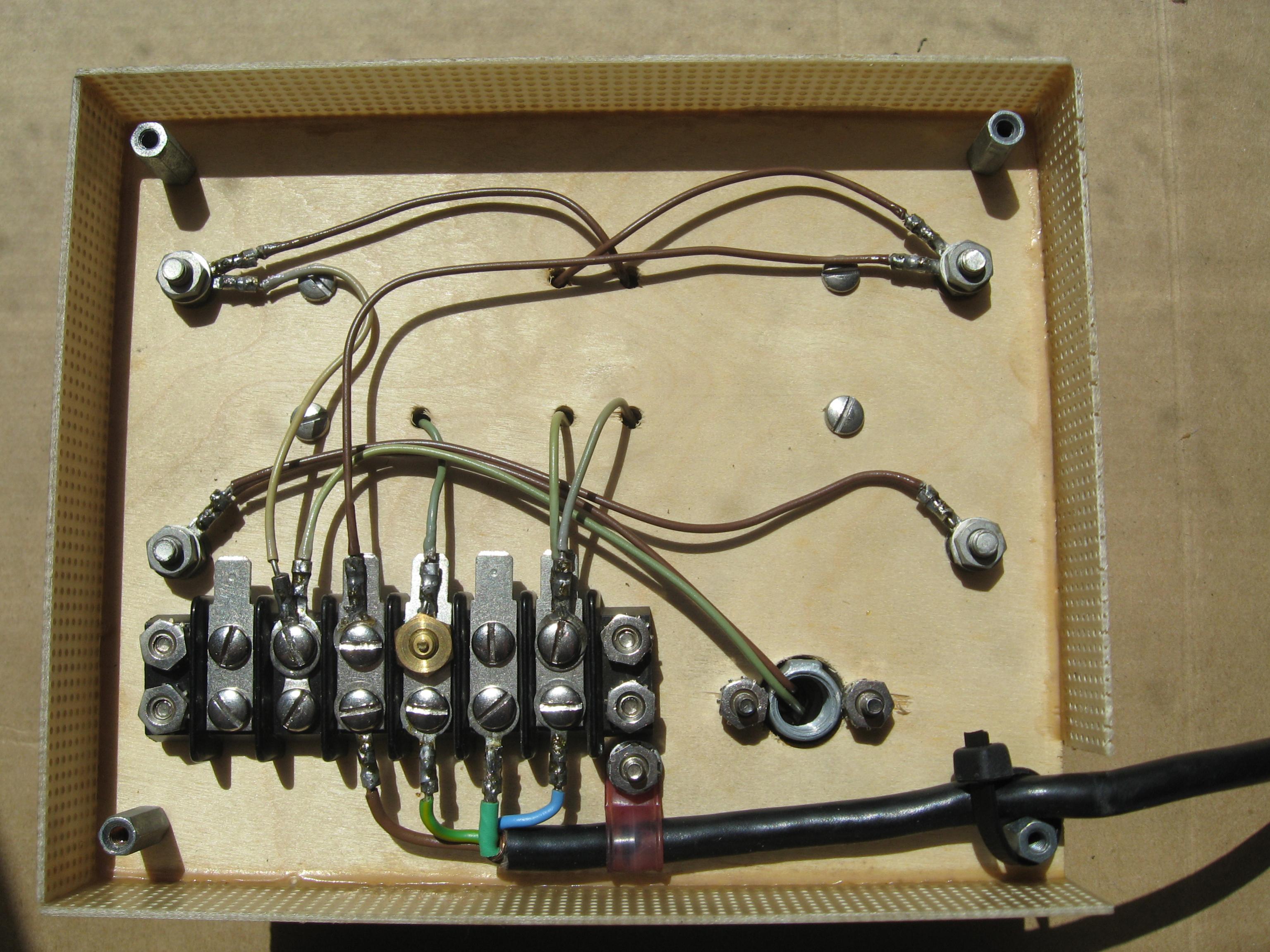

Light Bulb Tester. Showing a Tiny 40W Euro bulb for maximum protection.
