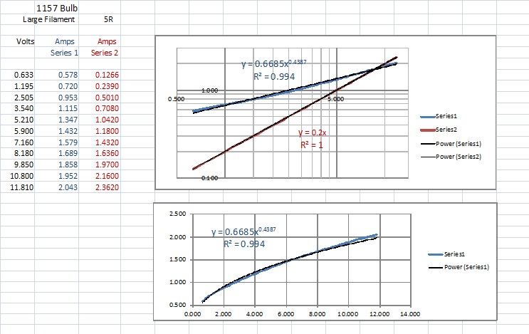

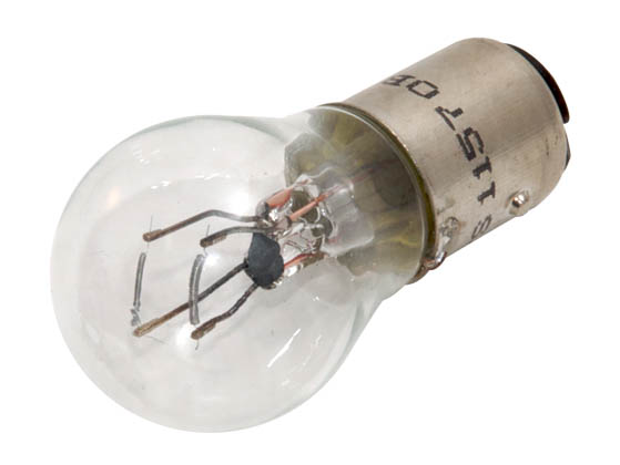

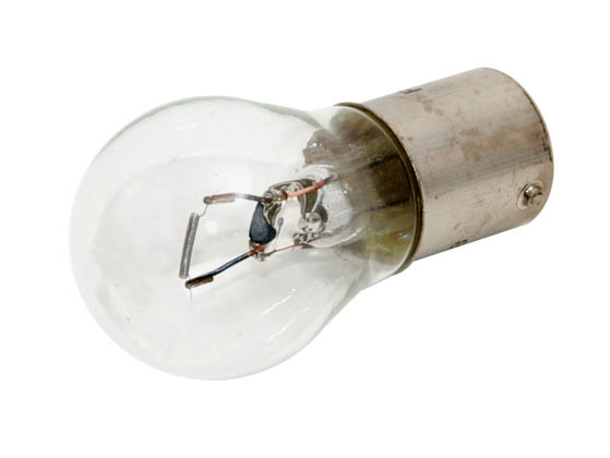

The 1157 was a very common automotive bulb used till about yr 2000. It has two filaments, a low power used as a running light & a higher power for the brake light.
The attached compares the high power filament to a 5R resister. On a log-log scale resisters appear as a straight line with a slope of one. The 1157 shews up here with a slope of less than 0.5, typical of tungsten bulbs. the R2 value is a measure of how well the resulting curve fits a power series. Better fits result using quadratic or cubic equations, but in this case doesn't mean much.

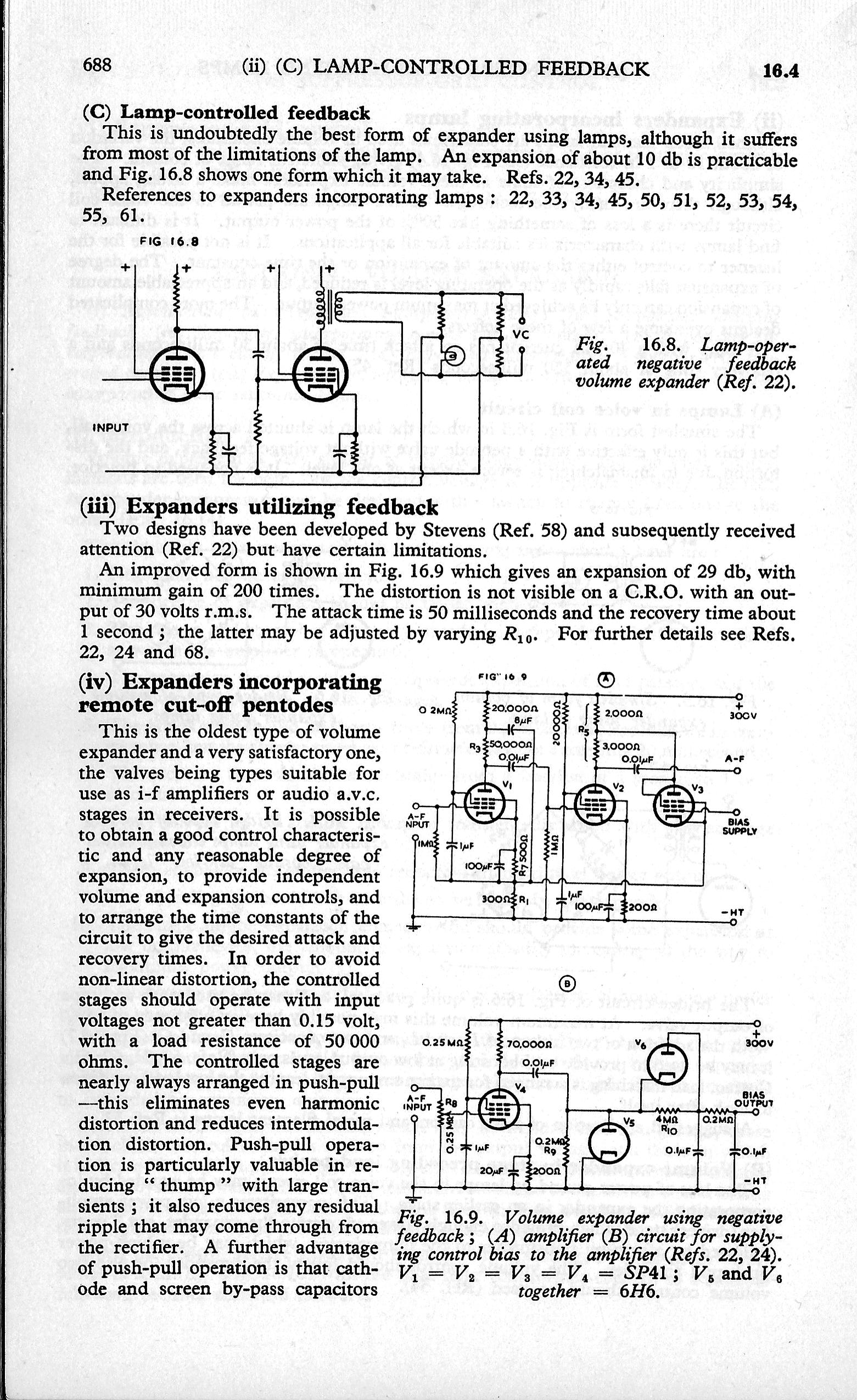

Bill Hewlett of HP found a very useful application for this property of tungsten light bulbs. It stabilizes the output level of Wien Bridge Audio Oscillators better than other techniques in use at that time (1938). The first large sale of HP was to Walt Disney Studios who bought six HP 200A Audio Oscillators.
The other info is lifted from RDH4, light bulbs in audio circuits.

Maybe it's different countries terminology, but that sounds like a standard stop and tail light, which I've always known as a 380 bulb.
And I spent half my life selling them.
The 1157 was common in the Americas. Read Ford, GM & Chrysler. There is a more recent version with a different connexion. Stiff wires backed up by plastic, the 3057, And it is a standard stop & tail light. Perhaps it is compatible with the 380 family.

All my life I have kept a drawer of 1156 1157 lamps. I can't believe anybody would doubt that.
1980 All Makes All Models Parts | *XX102 | 1980 Emergency Bulb Kit -
And yet, NONE of the cars in this house: 1991, 1996, 2002, use the 1156/1157 types. Which explains why I have not re-stocked that drawer in years.
1156 is one filament. 1157 is two filaments, two back blobs, and only goes in one way. (Oh, you CAN get it in the other way, but it works wrong, and getting it out is a pain.)
No, these don't work on 120V, but are dandy for hot-wiring car accessories. A transistor car radio will light and may whisper on the fat side of a 1157; if the radio is a short you just have a bright lamp, not a pfft-fuse or a wire-fire. They are also dummy loads for 12V power supplies. (Switchers may not like the cold-load.)
I never sold incandescents but rather LEDs by the million while with HP!
Having looked it up, it seems it's the same bulb, just different numbering systems.
The 1156 mentioned is a 382 in the UK.
