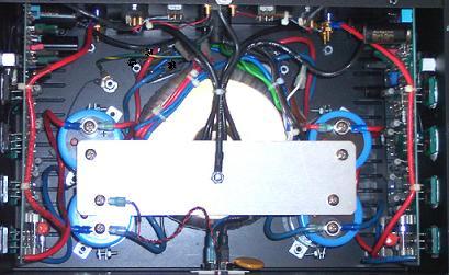

You sound like an experienced technician... I'm a bit curious about what kind of "motor drives" you're referring to(industrial)? What have you experienced with large (>5,000uf) can caps in power amps?
I have a few amps over 15 years old that still have original PS caps, which is why I'm looking at replacements.
