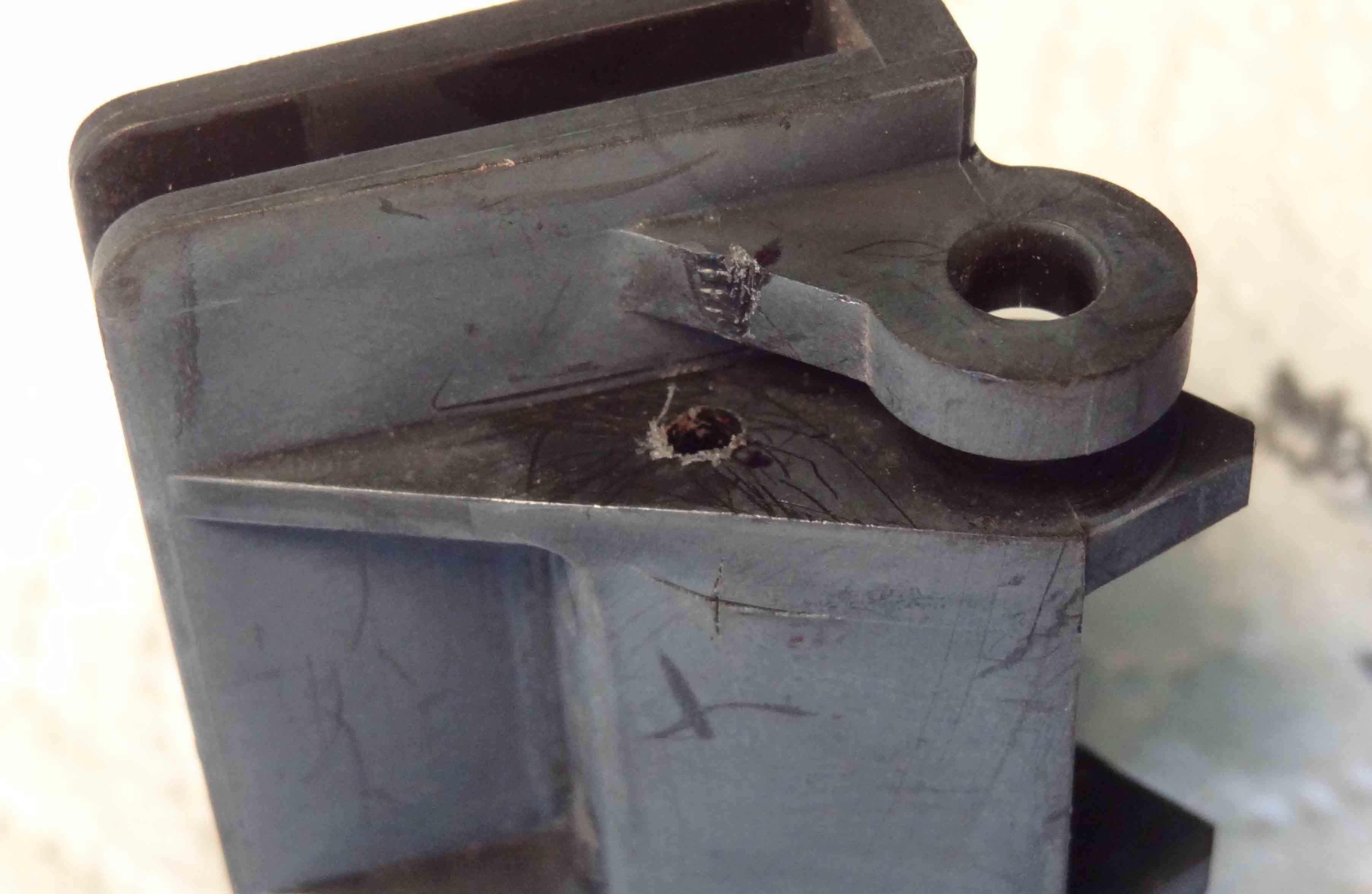

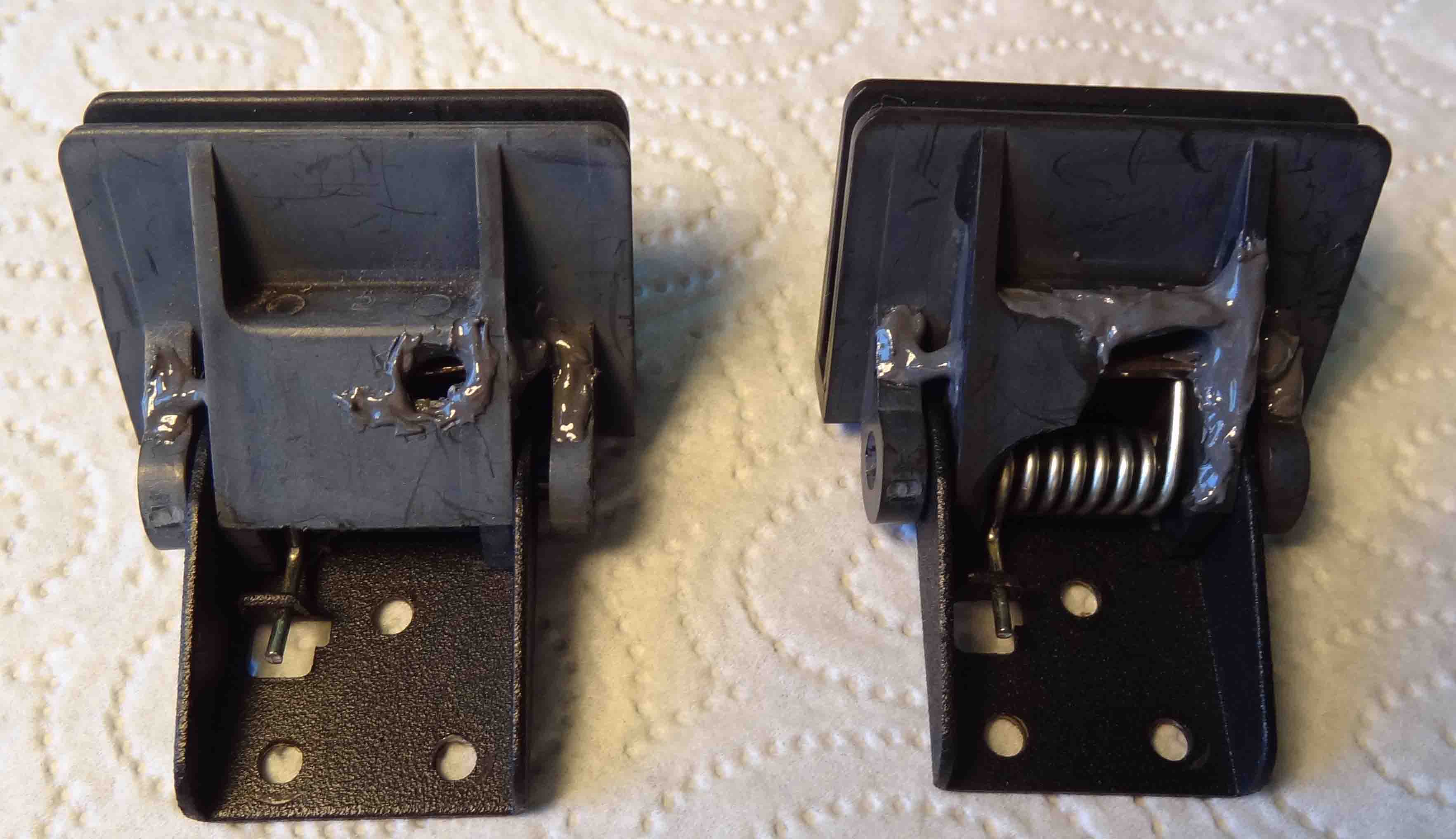

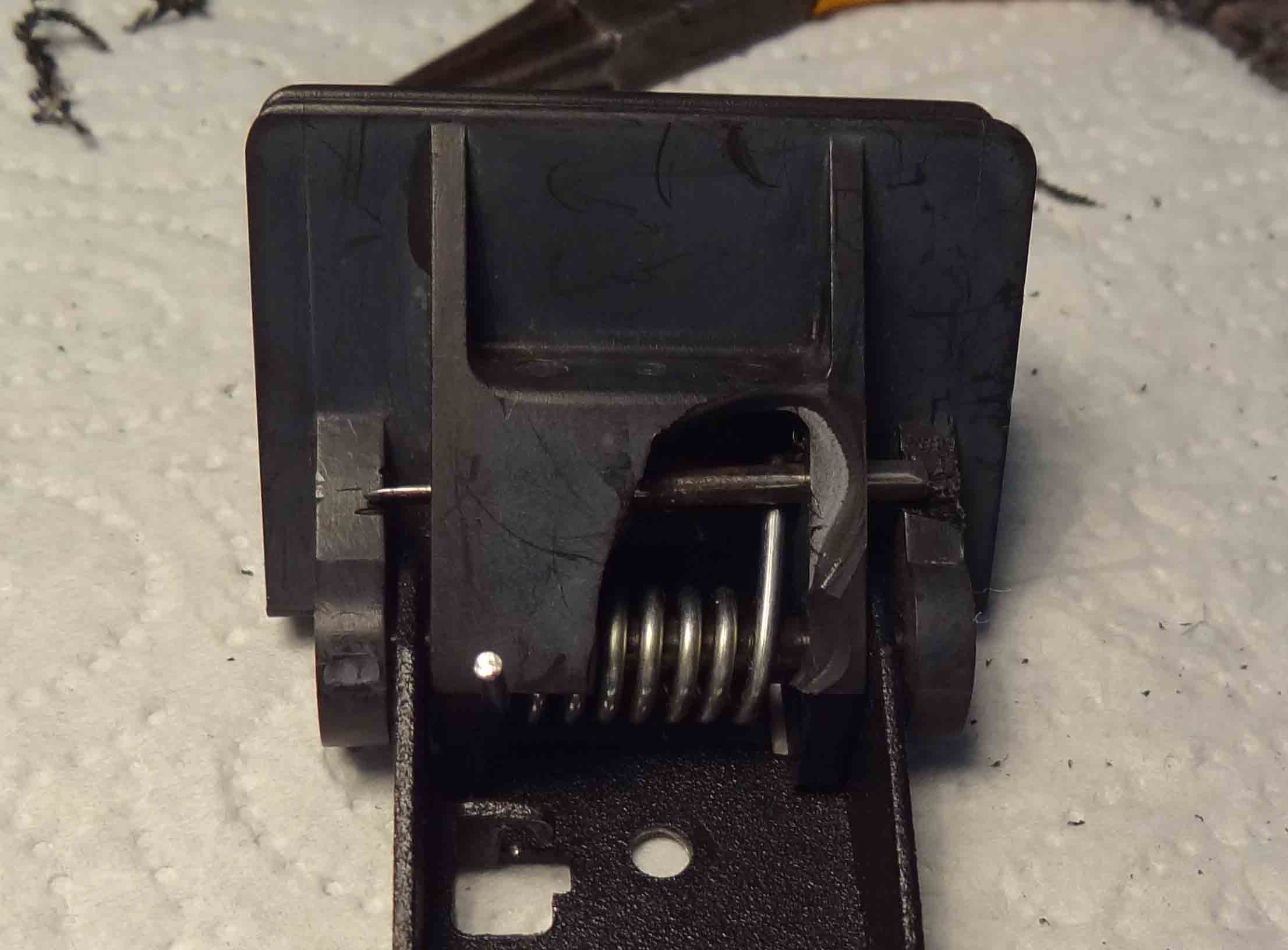

I "repaired" mine a few years ago. Guess this will laster longer than originally.
Note that the spring has cracked off the entire backside. In fact I made the two holes using the nail itself as a drill. So it fits perfectly with no tendency to slip out. And no way the spring will ever work through the nail as it did with the plastic. 🙂

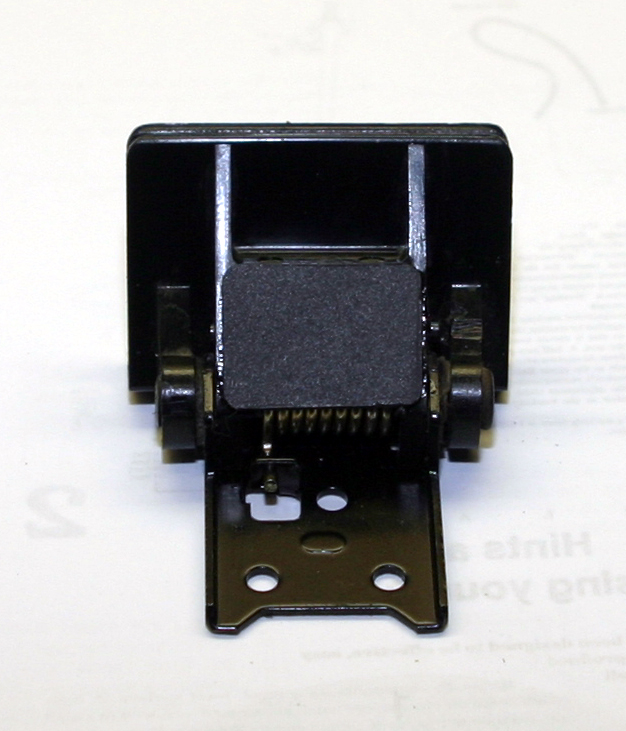

Nice repair GeorgK. Back in 2007 I repaired a pair of Linn hinges. I had some used, dull 3/32" drill bits I cut the shanks (the smooth part) off of. I had some old black 3.5" floppy disks I cut up and glued to the hinge to cover the broken area.

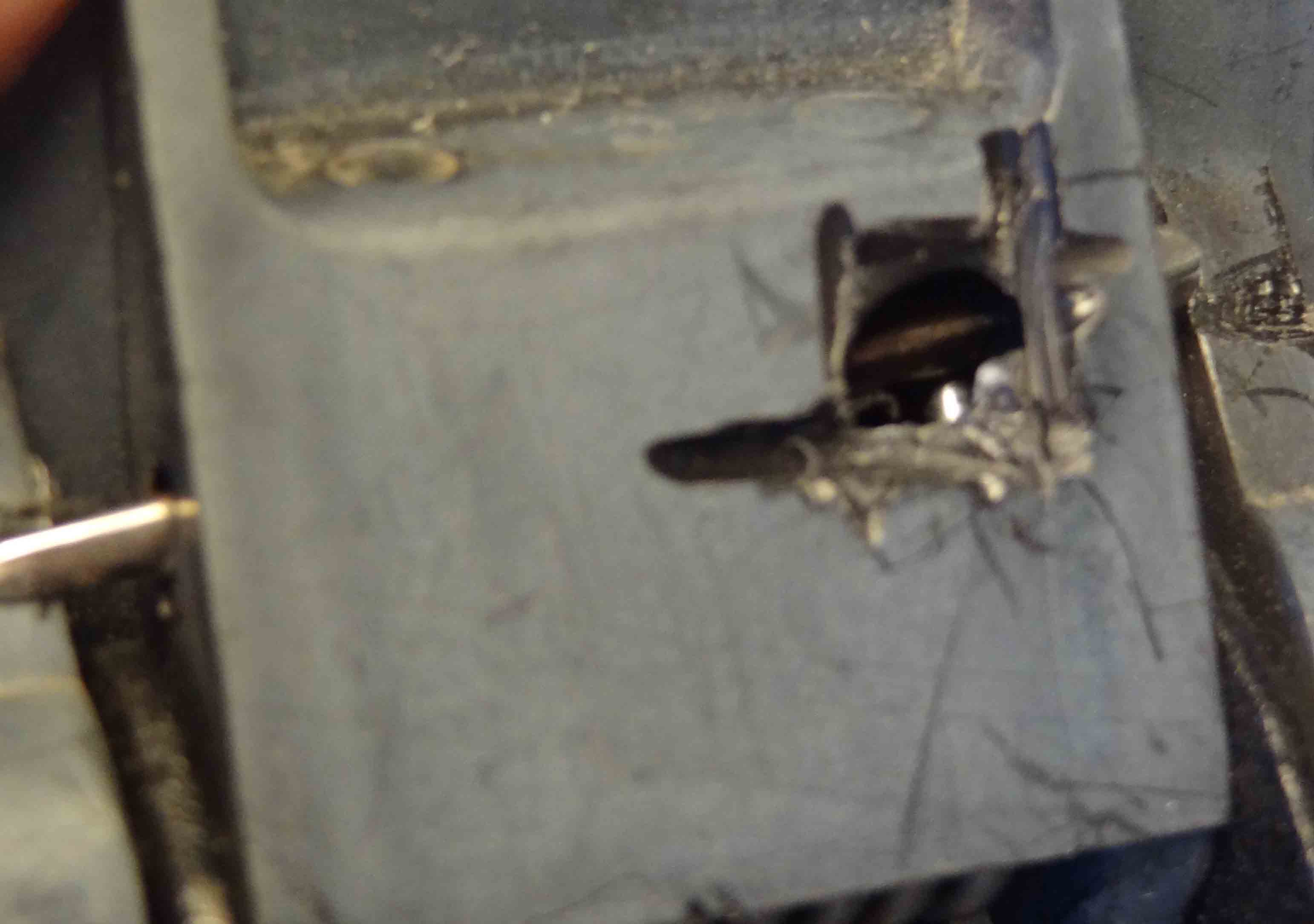

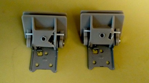

My Sony turntable (PS-LX3) has the same hinges. I discovered a fairly simple fix for you do-it-yourselfers. Drill a hole on each side of the plastic portion just above the pin and insert an additional pin that retains the spring.
Photos at Sony Hinge Fix - a set on Flickr
(Ignore the hole I drilled in the center of the hinge, that was a fix that was unsuccessful)

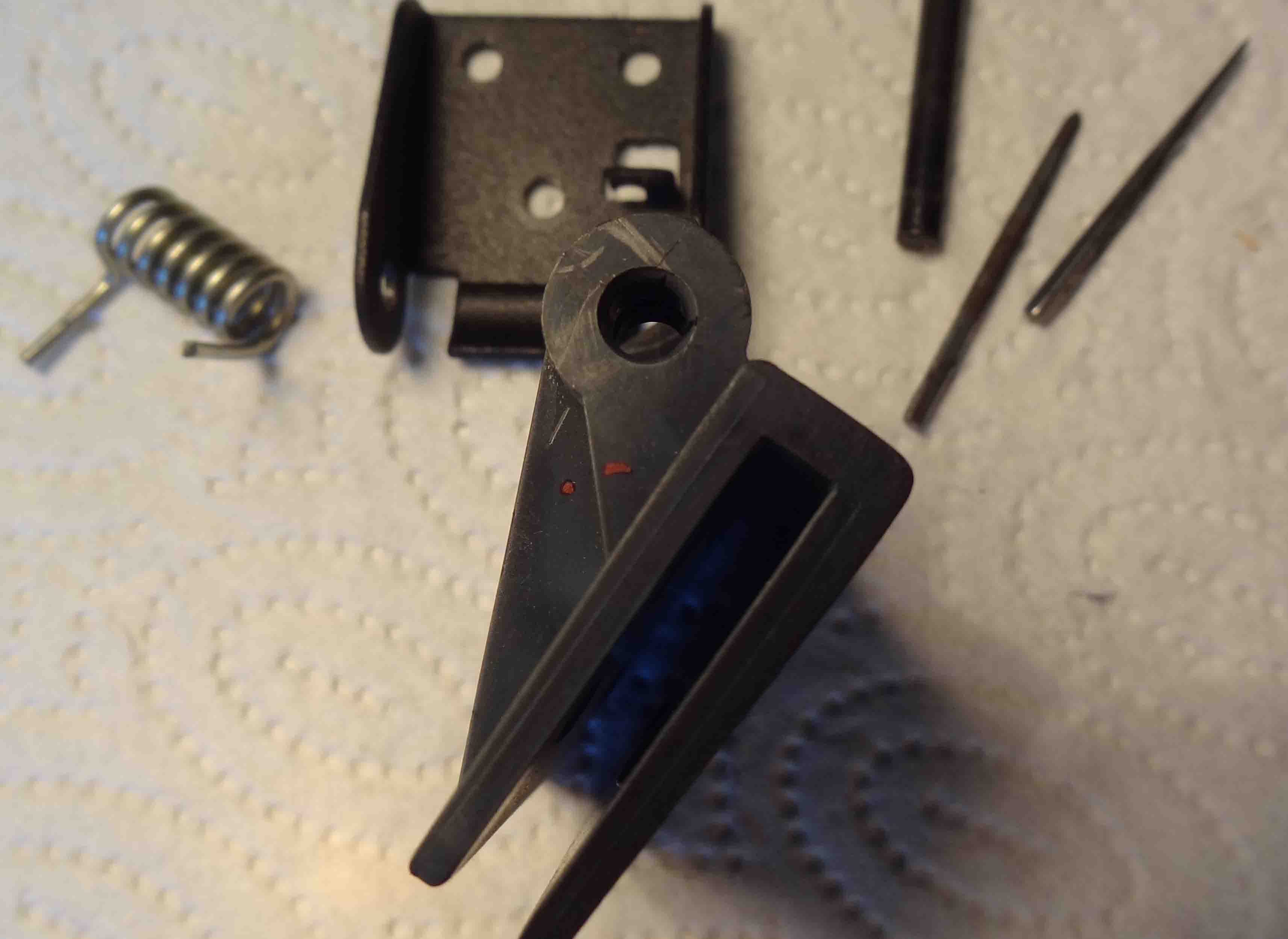

an additional picture series:
TIP:Turntable Dustcover Hinge repair for Linn NAD Logic TEAC- Vinyl Engine
Same dustcover hinges was used also at follow record players/turntables:
AKAI AP307, Linn Axis, Logic DM101, NAD 5020, TEAC PX-300, TEAC PX-500. Sony PS-350, DUAL CS 130 + 505 and probably many more
