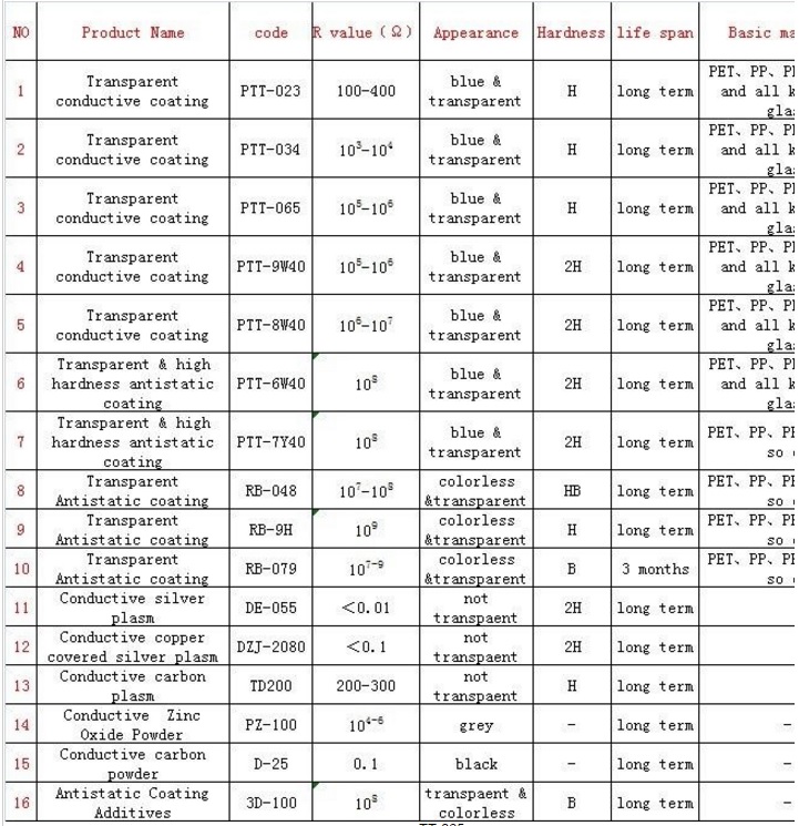

Details of the Coating (RB-048) and ATT-065
Product Introduction
With conductive nano-material’s ultra fine particle size, it has a better transparency, especially the use of nano-inorganic composite conductive material make it with good surface hardness, strong tolerable of high temperature and long-term efficiency advantages. It can be widely applied to the materials for electronics, information, packaging, transport, transparent light emitting.
Product Name:Transparent antistatic coating
Huzheng’s new anti-static coatings, based on the technology of electroactive polymers, provide a safe, long-lasting solution to electrostatic charge problems. RB-048 is compatible with many different materials, work in dry or humid environments, and dissipate static charge buildup in milliseconds, when grounded. They can be applied by spraying, spin coating, or brush application processes that ensure uniform, thin films.
Huzheng's anti-static coatings are customizable:
Huzheng’s unique anti-static coatings can be customized to meet your needs. Potential applications include electronic packaging, metal, marble, textile,PP film, PET film ,air-dry or clean room systems, window or screen displays, or even aircraft canopies. Our anti-static coatings work equally well in dry or humid environments.
Coating Types:
Transparent colorless anti-static coating: RB-048
Transparent conductive coating (blue): ATT-065
Coating 1: RB-048
Product Name: Transparent colorless anti-static coating
Code: RB-048
CAS No.: 2588-1237-78
Appearance: Colorless and transparent liquid
Other Names: conductive paint
MF: ATO
Main Raw Material: ATO solution
Major ingredient:High polymer
PH value: 5.5
Density: 0.88g/ml
Conductivity: 1 x 107-9Ω.cm
Solvent: Alcohol
Surface drying time: 4-5 minutes
Average particle size: 5-10 nm
Curing temperature: Room temperature
Adhesion: 0 level
Application fields: Electronics product packaging, anti-static coating, synthetic fiber, Kraft paper, plastic molding products, plastic sheeting, polycarbonate, vinyl chloride, methyl acrylate, ABS plastic plate.
Application: brush- coating, spray- coating and roll coating
Coating 2: ATT-065
Product Name: Transparent conductive coating
Code: ATT-065
Appearance:Blue liquid
Major ingredient: Nano oxide
PH value: 8.0±0.5
Density: 1.45g/cm3
Conductivity: 1 x 104-5Ω.cm
Solvent: Water
Surface drying time:10-15 minutes
Average particle size:5-10 nm
Adhesion: 0 level
Main Applications: It can be applied to the producing of of transparent electrodes and soft circuits, compartment glass, walls, floors and other surface coating treatment of electronic information room. Other fields of electronic signal shielding, electromagnetic wave shielding as well as anti-static.
Environmental performance:Safe and environmental protection

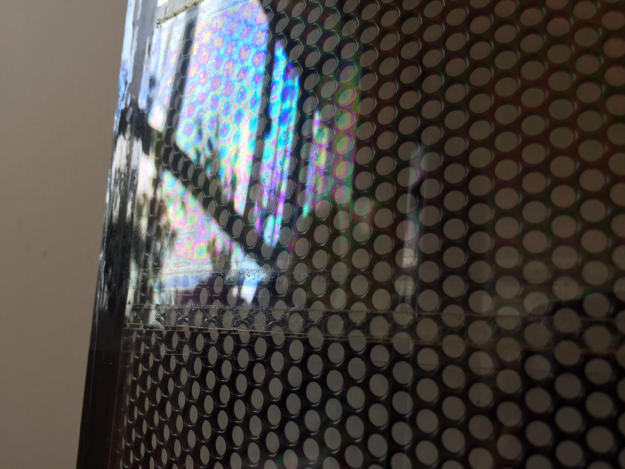

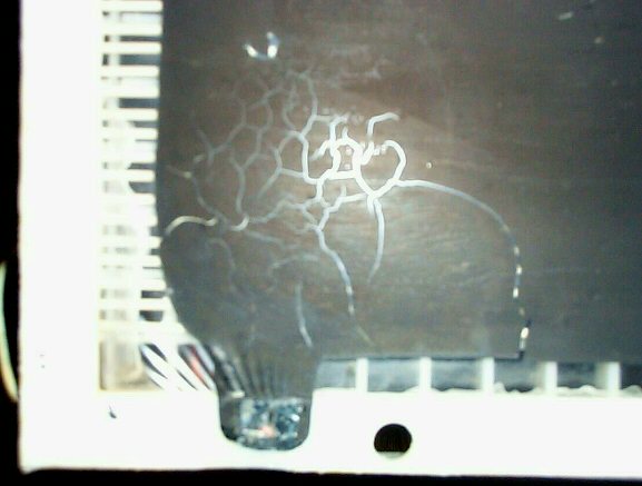

well, i re coated them and added the traces that connect to the aluminium strips...2 months back
i am NOT PLEASED! i had them all nice and assembled. but again losing output 2 months later. i get sick of this crap. in my opinion licron sucks. a freshly panel i got a reading of 80 to 120 M Ohm. just 2 coins on the panel and measure. it is not a proper square/ohm reading and not with high voltage.
After 2 months some panels dont have a reading at all on the 200Meg setting..... but on a original panel i get 6-20 Mega ohm...... pretty low. but its not the true resistance. it is just a comparison. if i want to replicate original panels i should get the same resistance with the same measure method and meter. regardless of measuring method. since i use the same for both. i might be moving to another city but then i will conduct some tests for a coating, since i get sick of the magic randomly vanishing licron, witch cost a pretty dime as well. i go back to what quad used either carbon or combination of carbon and graphite. at least there coating stays for 30 years.
i recoated oen panel with carbon (to low resistance) but output is higher then any panel coated with licron.... the vanishing goes ever so slightly so i did not even notice it on the best sounding speaker. but now i know they did lose ouput since my left speaker is playing as loud as the good sounding right speaker with 1 panel less, and there is even a difference in output between the panels on the left one, i can hear that without even measuring. so the one coated with carbon makes up for the shitty ones and still sounds louder then the right speaker.
i do have to admit this test panel has way to low resistance (<1 Meg)and when driven hard it will flash over to the coating. so upping that is a must, not only because of migration, but also power handling. since the old ESL63 does not have a coating on the copper clad

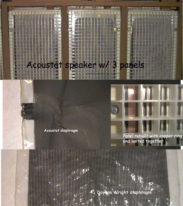

Jim Strickland Acoustat....used Ampex magnetic coating...it works..last...we got get some...yes no maybe...... see pic from heating.....with a hair dryer...
panting it on....Wow.....I think that's Roy E....an Jim in front of whit I wish I had a new pr of M3s..............................
