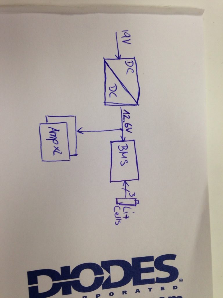

So I've been reading up on it and watched that video (great video, thanks for that). Looked at a couple of datasheets for the chips, too.
I found this CC/CV:
Free Shipping 5A Adjustable Power CC/CV Step down Charge Module LED Driver Voltmeter Ammeter-in Integrated Circuits from Electronic Components & Supplies on Aliexpress.com | Alibaba Group
This works just as well as the other, right? Just with displays. I do have a multimeter, but it's a cheap one.
So my plan now is to power the portable system with an old laptop charger of 19v. I have a 150w step-down module lying around, which I will put before the TA2024 and step it down to ~13v.
Then the CC/CV in parallel with the step-down module to charge the batteries through the BMS while the speaker is powered by DC.
One question from earlier:
The BMS says it required 15v CC/CV input itself. So shouldn't it be powered by 15v and not 12.6v?
ideally the BMS board wont intervene if your charger, and load don't exceed the safety parameter of a single cell in the string (see BMS spec) given the cells are well matched in the beginning. E.g. set up the charger to match your cells. (Use 3 x 4.1 max) how well your BMS board works IDK, buy one and test all the functionality. Note By testing these BMS thingys, you may weaken some cells by stressing them near the limits esp if they don't work as advertised.
