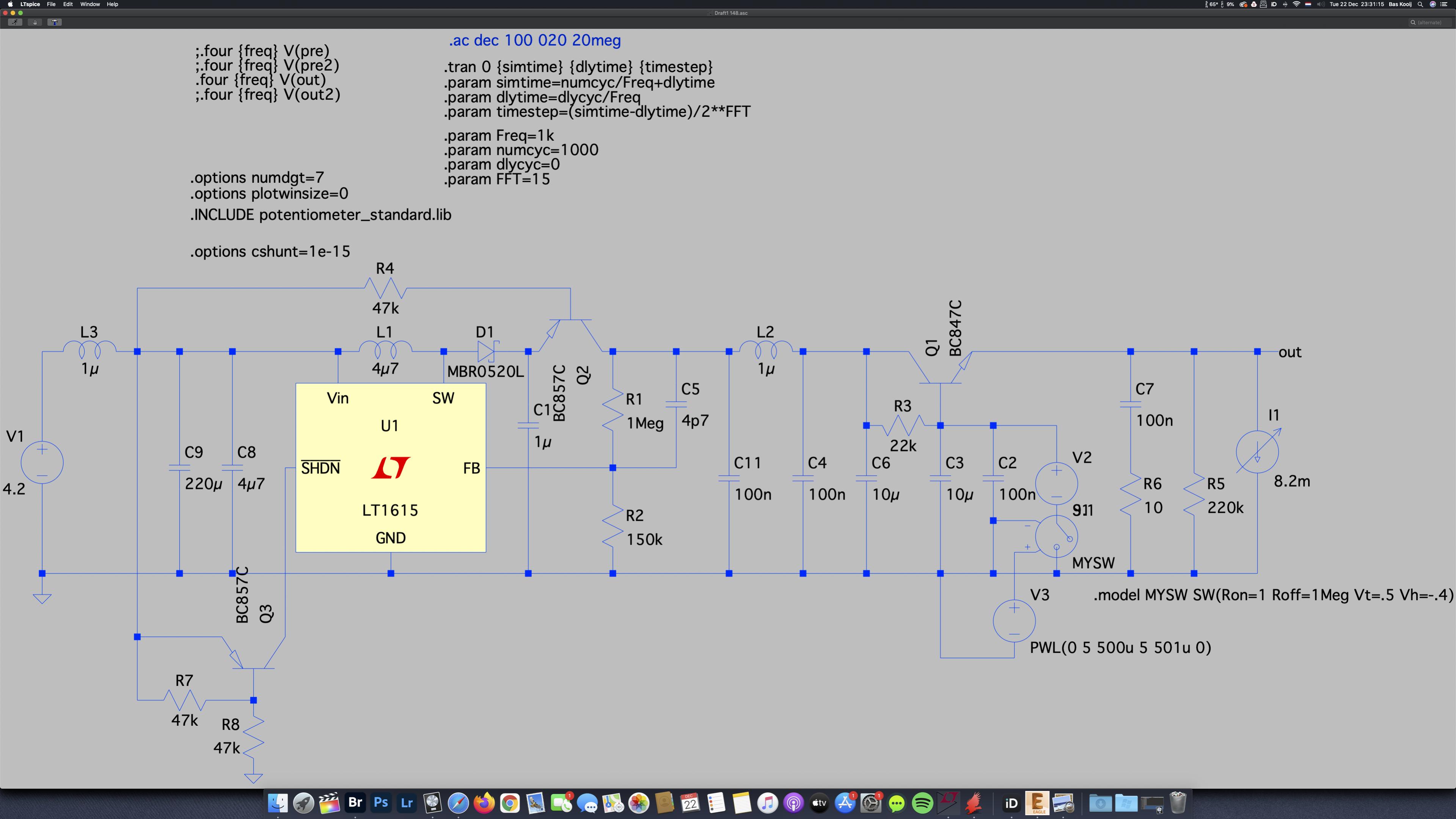

Here I am again. I did some more research into making a simple dc converter silent enough for active pickups. Fishman applies some tricks to their stuff. Those include extra input and output filtering with inductors, a cap multiplier, load disconnect, switching enable signal. The base of the input disconnect should be tied to the ring of a stereo input jack. When plugging in a mono jack, the transistor and thus the converter turns on.
So, does it work? Yes, it does. I did a test on a breadboard, a simple Ali converter and an output filter like in the attached schematic. The result? Dead silent, as in as silent as with a 9V battery. And this Ali converters hissed like mad before.
