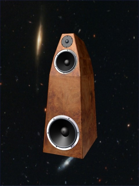

Amazing work Shin,
You seem to be having fun and must be putting in some late nights modeling.
Here is a render I just did tonight in Inventor of a concept audio/video 3 way that I want to build. I already have the mid/bass and tweeter. Just need the 12 inch woofer. This is an unusual design using a Vifa 8 inch midbass instead of the usual 6.5 or 7 inch. The speakers are not exact replicas but are more for just visualizing the finished product.
Thanks to Sigurd for letting me barrow a few of his IGES files. It saves me a lot of time!!!

Hezz,
my pleasure
I'll try to add some nice Scanspeak Tweeter models during Easter.
Sigurd

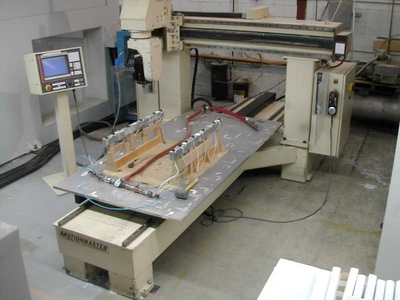

The above movie shows how cool those five axis machines are. And there are others ones even cooler than that one. However, just to bring everyone down to reality, there needs to be some input here. That process is not cost effective for anything except one-off prototypes on which tens of thousands of dollars are spent. Even the big car manufacturers do not use those methods for making engine blocks for several reasons.
Programming that engine block would take a week or weeks depending on the skill and experience of the programmer. This would drive the cost very high not to mention the fact that most machine shops would not even consider doing wood on a machine that was not dedicated to that purpose because it will damage the machine. The sawdust gets into the coolant areas and creates a mush that will require the whole machine to be cleaned out.
It doesn't even make sense to approach a DIY speaker project in this way as you could build up a fiberglass/carbon fiber/epoxy cabinet by hand for less money than it would take to get the MDF machined. And you would have a far superior speaker cabinet.
However, if you were to do it CNC this is the kind of machine you would want since the machine capacity needs to be designed for the size of components that you are working on.
Here is a 5 axis router with a 4 x 8 foot bed. This used machine is selling for 50,000 USD.
