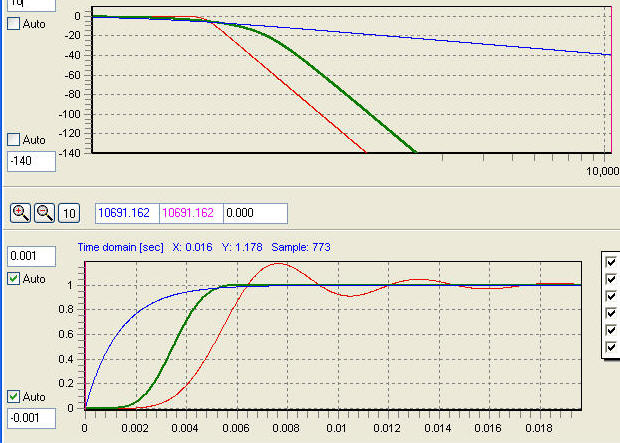

I like to show some reason why a XO of a lower order my sound better than a higher order. See appended picture.
The picture displays some lowpass XOs at corner frequency 200 Hz. The blue curve is a Butterworth order 1. Of course the amplitude response is quite flat. The lower graph shows the time domain behaviour, here as minimum phase step response. We can see that the blue curve starts quickly (it introduces less delay) and it has a soft transition to 1.
The red curve is a Butterwort order 10. It may be desired to select if a steep slope is necessary to suppress e.g. resonance frequencies of a cone. The tradeoff is its ringing behaviour which you can clearly see in the step response display. It also creates a bigger time delay.
The green curve is a Bessel filter of order 10. So the slope is the same like the Butterworth of 10th order. You certainly will notice that it looks like a compromise between the other curves. The transition for the amplitude response is more smooth. An interesting point is the step response. It has no overshoot despite the high filter order. But it also shows some delay.
Here we get to a point where we can see the advantages of the digital world. Now we are able to design crossovers according to our needs, it is not mandatory to follow the old tradition of analog passiv crossovers. We can compensate also for the delays. We can use linear phase crossovers. No problem to design crossovers with an subtractive approach.
At the end we find a way to use the best part of a given driver and to integrate it with other drivers in a proper way. This is my understanding of "cooking" as a method of synthesis 🙂

Thanks for the pictures! Can I ask you if we can compensate this ringing with linear phase filter and your substraction XO method used in Acourate. Does it still matter whether we choose Butterworth or Bessels?
The ringing of filters which you can see in a lowpass step response is a property of the filter type. So filters of order 1 do not ring and also filter of Bessel type. All other filters introduce more or less ringing. This is independant if it is a minimum phase or linear phase filter.
A higher order means a steeper slope. The Neville-Thiele filter is a filter which has quite a high slope but less ringing than e.g. a Butterworth with the same slope steepness.
So I prefer to use today either Bessel or NT filters.
