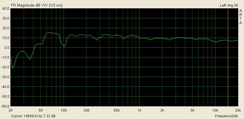

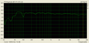

Also bought a few huge bass traps to try and do something with the bass issues I'm having. Just finished putting those up so will have a measure and see what sort of difference its made.
Huge difference with the 6 bass traps and side wall panels:
Before:
After:
I took the measurement at 7dB higher than the 'before' measurement time so as to clear all the background noise from measurement.

Fantastic measurements, finally real life graphical representation of bass traps at work. I will now have to buy some for me.

Gee Shin, the CSD graphs really show the effectiveness of the traps.
Most try and use waterfalls to see a before and after difference, which you of course can to a degree, but to my eyes the difference is much more easily seen with the csd presented in that format.
