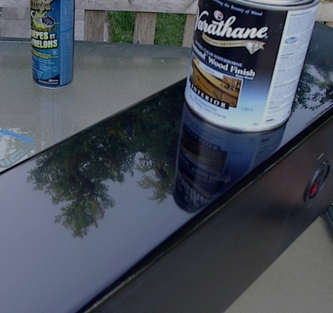

I've also switched over to water based finishes and I have to say they have come along so much. Quite expensive at £63 for 1.5ltrs but it dries in minutes, seems tougher then celly finishes and the gloss is high.
Fast colour Ant! Very spiffy indeed.
Oouch! £63 for 1.5ltrs? That's robbery.
Results look good though. Do you think you'll be using that product from now on?
MJL21193 said:Results look good though. Do you think you'll be using that product from now on?
I think so, the price is a bit daft but its given me the incentive to look at other brands of waterbased and hopefully find cheaper and similarly performing ones. What surprised me the most is how quickly it dries, I left it out baking in the sun with a mild breeze and came back 30 or so minutes later to see what what happening and I could easily handle it without wrecking anything. That's something that was impossible with 1k. Seems pretty tough too although I wouldn't like to test it.
The clearcoat is still 1k acrylic though. Only the basecoat is waterbased. In fact I don't believe you can get a waterbased clear, is that right? I did ask my supplier but he said 2k is the way to go and commented that waterbased isn't tough enough to withstand the crud that a car bodywork endures. Since a speaker is going to live a rather sheltered and cared for life maybe this isn't an issue?
Remember over in Sploo's thread I posted results of the clear waterbased urethane? That clear is very tough, tougher than the solvent based poly.
The final finish needs to withstand daily cleaning of slimey fingerprints from all of the awestruck fans, not so much road crud.

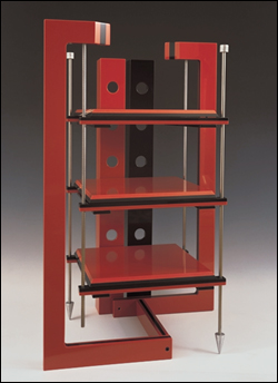

They go well with this rack..
http://www.particular.com/products/inferno.htm
