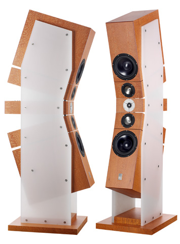

Design
The current vision of your project reminds me of the Sonics Passion.
http://www.sonicsonline.de/produkte.php
I must say that it is a fantastic undertaking.
Congrats,
C
Congrats,
C
