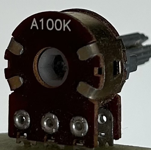

I need to have the volume pot replaced. I talked to LFD and asked if I could have something better quality as I think LFD has this volume pot issue apparently. I was told that LFD only recommends this pot. The designer insists that this one is used. I will probably go with the OEM but would still like to know if anyone knows the specs for this pot. All it says A20K on it and looks like it is Bourns brand (at least that's what Google Image search tells me). Thanks.

It could be a Bourns PDB18, Alpha RV16, Alps RK163 or something else. At least in the case of Bourns, Alpha and Alps, A20K means it's audio (log) taper.
Edit: measure carefully just in case but that's a pretty standard pot package and, as long as you select the right thread and shaft, there's no reason why you can't replace it with one of your choice.
