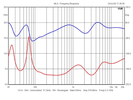

I am thinking of using Lifeforce 55 or new Naksa 70 to drive pair of 2.5 way loudpeakers with minimum impedance drop of 3 ohms. Since room is not so big, loudspeaker sensivity is also high (91db) and I like to listen to normal listening levels, so at least theoreticaly there should not be any issues with these two amps, but I would rather ask before doing any decisions..😛
I got also impedance curve of this speaker:
What do you think?
What do you think?

For this load, where impedance is around 3-4R for the passband 200-800Hz, I would recommend two output pairs rather than one. For this reason I would suggest the NAKSA 100.
That would give you the reassurance needed to routinely run sub four ohm speakers.

But remember, Hugh - I have LF55 modules powering my 3.2 ohm Maggie mid panels. (They're basically all resistive, so it doesn't change much across its frequency band.) 🙂
Andy
