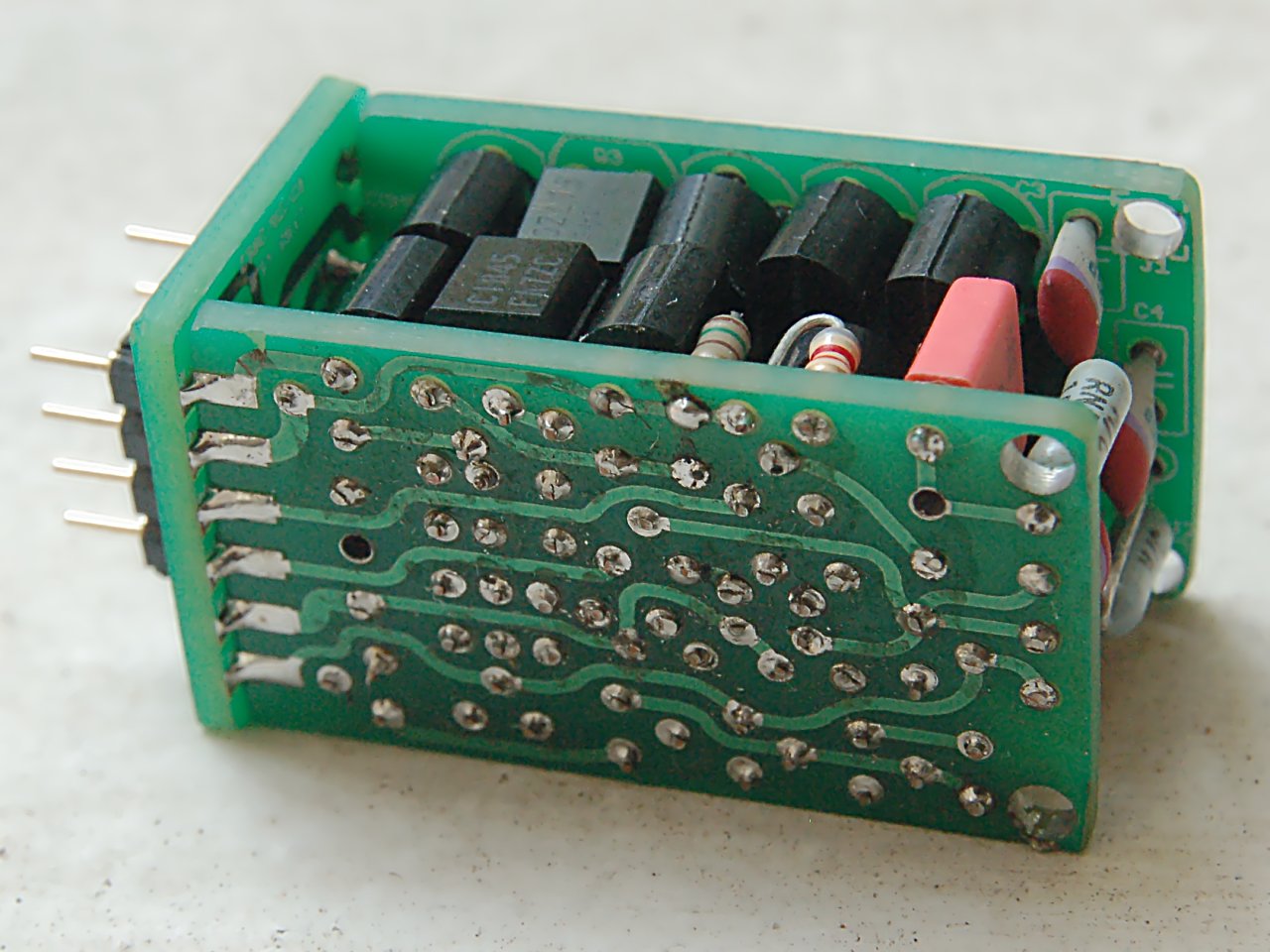

The first prototype LF03 is built, functional, and sounds very good as the line amplifier in a Marantz DV-4400 DVD player.

C5 is located on the base PCB, i.e. the one where the DIP8 pins are soldered and the individual opamp daughter-boards are mounted. There's not much clearance or space at that location, and the pitch is 2.5mm, but it's enough for a pair of C0G axials or ceramic plate-type caps to be mounted. The DIP8 pinout doesn't include compensation for a dual-opamp (obviously, shortage of pins), so this is the closest that can be managed.

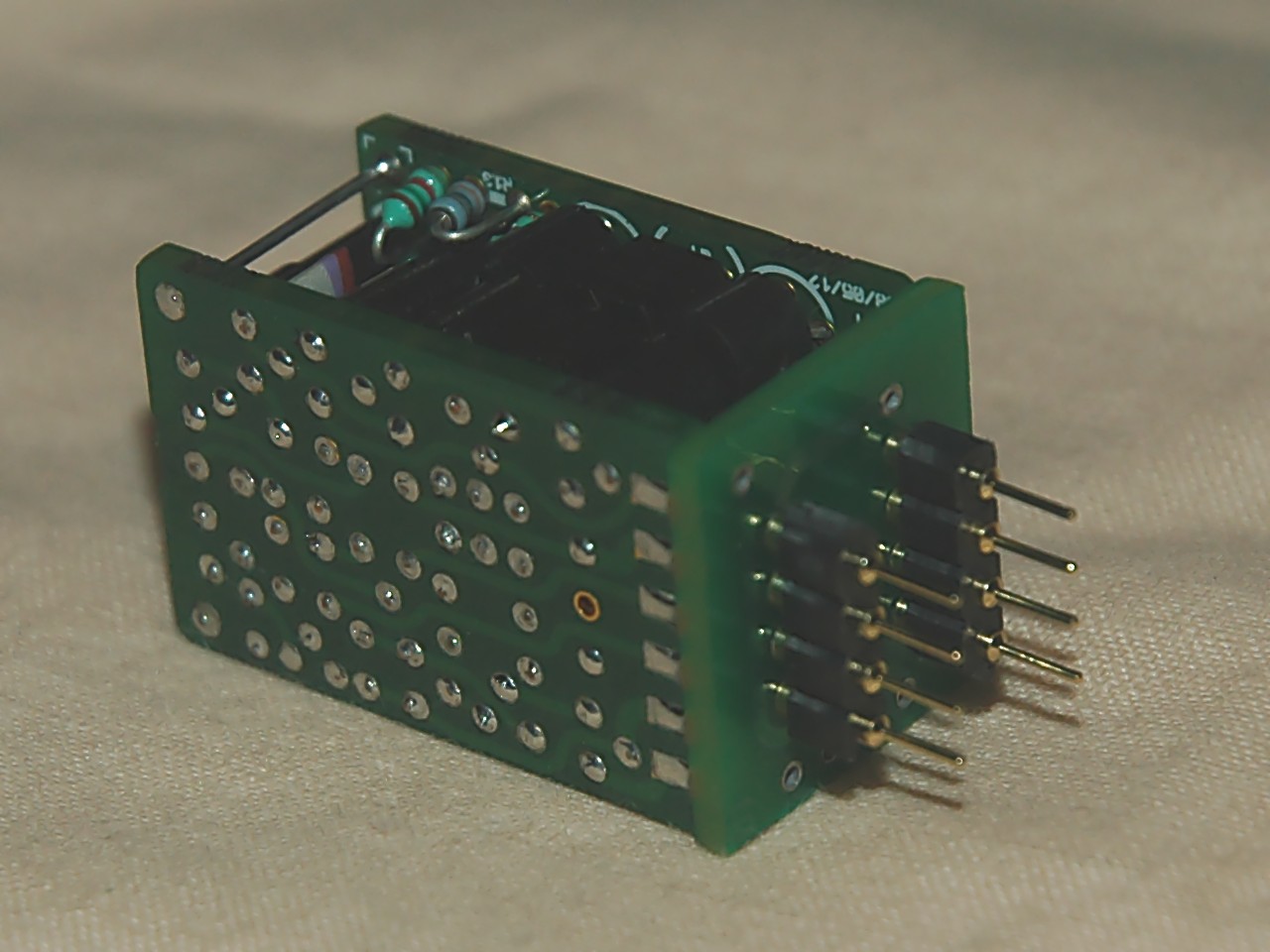

Looks very interesting. What are the dimensions of the base PCB? It looks considerably larger than a chip and might not fit into many existing PCB's with tight clearances. Could it be made more compact if the daughter boards were reversed with components mounted on the outside surfaces with an insulator between the two boards?

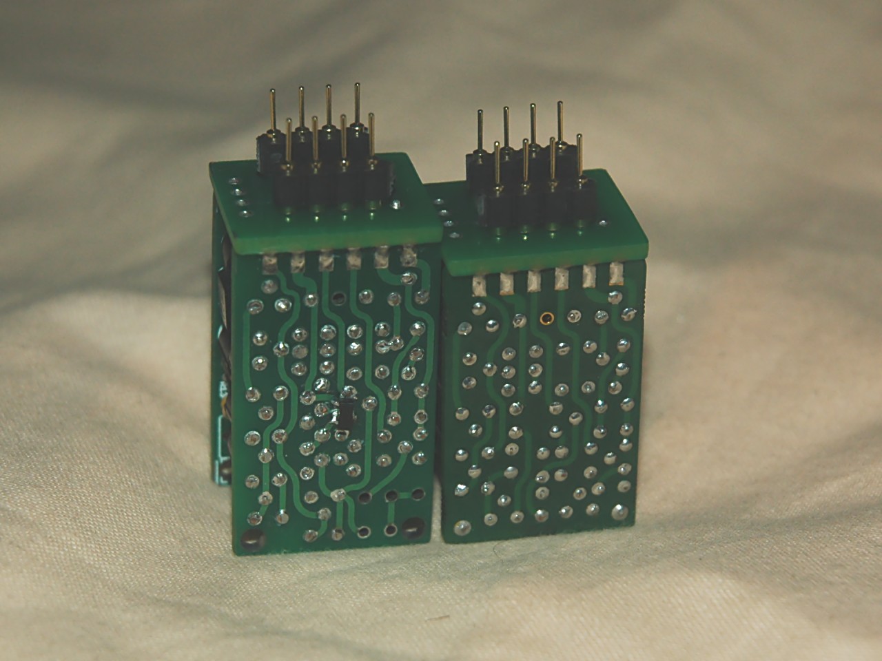

Thanks, Tom. The dimensions of the base PCB are ~19mm x 17mm (~3/4" x 11/16") and the height, including pins, of the entire assembly is 40mm (~1 9/16"). It's larger than a DIP-8 chip - whether it will fit depends on clearances to adjacent parts. It's possible to use one or more DIP-8 sockets as spacers to raise the assembly above adjacent parts if there's interference.
I thought about the reversed (back-to-back) assembly of the daughter boards (which is used presently on the Burson HD discretes), and it slightly complicates the assembly on the base PCB. In principle, it is possible, but requires a fresh base PCB layout (or something like a perf-board).
Supply voltages are +/- 9..15V on the first prototype. I got some initial feedback that there's interest in using it in PCI sound cards, which often run the analog section on regulated +/- 5V. I'll be testing a mod (requires one track cut and one diode mounted on the solder side, or no track cuts but two diodes to be squeezed into the component side) that will allow operation on a wider range of supplies, say +/- 5..18V if possible.

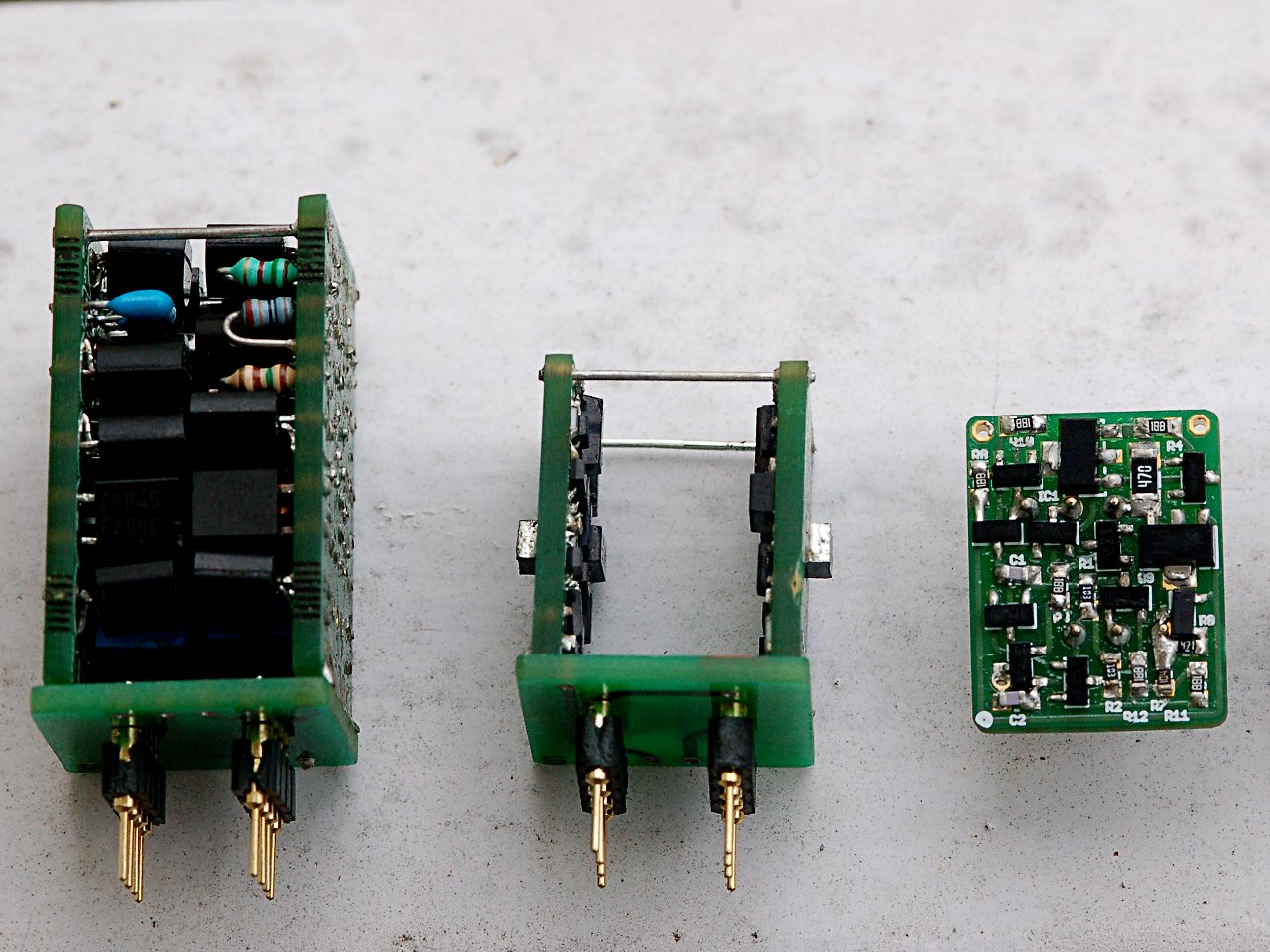

Update: SMD LF03 versions have been prototyped and are fully functional - I'm evaluating the audible sonics, which seem to be similar to the previous through-hole version, the LF03c. The SMD single, the LF03s has been tested working in a MyRef Rev C in place of the LM318 monolithic opamp.
Pics of the different versions of the LF03, including the latest SMD version(s) - from left: the LF03c (through-hole dual), LF03d (SMD dual, derived from the LF03c topology) and LF03s (SMD single, which is the same as one channel of the LF03d and shares the same PCB):
