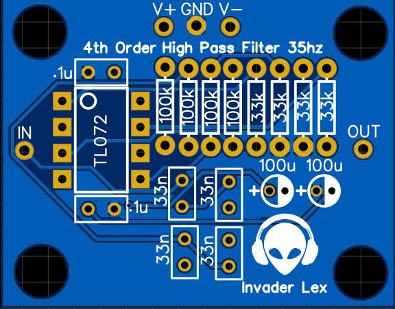

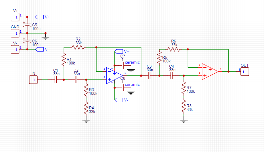

Nice Work 🙂 It might only be a nominal marking but I'd say use an alternative to TL072 eg OPA2134.
For that application TL072 is fine. The SWR redhead bass amp, use the same IC for the tone control circuit.Nice Work 🙂 It might only be a nominal marking but I'd say use an alternative to TL072 eg OPA2134.
Yes. TL072 is fine there. Many well loved desks of, say the 90s, are full of them with bipolar input NE5534/2 in more noise critical positions. It's the classic fet input audio opamp of its day.
But better is better. And the OPA134 series is better. fwiw I had some of the first samples of these on my desk when searching for a balance between the expensive OPA627 and performance in an ADC front end.
There are arguably better options now but 134 series is a safe bet wrt not being critical wrt layout / stability esp on a two layer PCB.
But I wouldn't suggest dumping TL072 if you have a tube of them in stock.

The next stage is another TL072 with JFET input and High impedance. Both (2134 and 072) driving that load are happy and performing optimal and so similar that the improvements are negligible and costly.
Not sure of your point here. Obvs don't try to drive too low an impedance from a typical opamp. Let's say limit it to 1K0 including feedback impedance. You generally need a higher current output stage arrangement. But in like for like situation then better than TL07x
(Or eg LF351) is generally available looking at SNR / THD / IMD. But yes - 072 etc will be okay.
Although tbh if driving that from a low impedance source eg OpAmp output, then a lowered voltage nose bipolar input might be better.

use a socket. I think any dual opamp will be fine. Use high quality if you desire, make it boutique.Not sure of your point here. Obvs don't try to drive too low an impedance from a typical opamp. Let's say limit it to 1K0 including feedback impedance. You generally need a higher current output stage arrangement. But in like for like situation then better than TL07x
