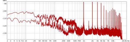

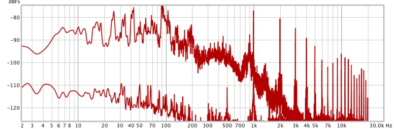

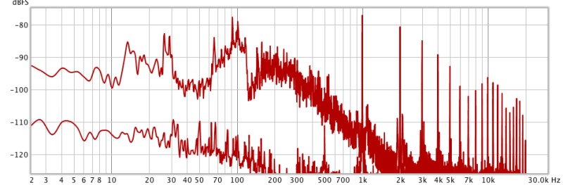

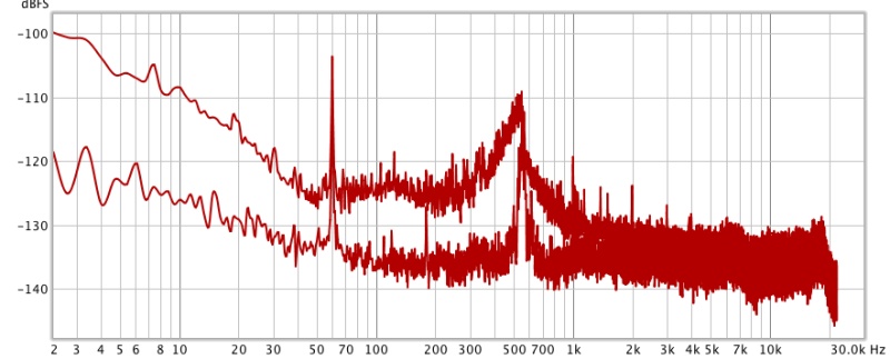

.... and here's the real electric RTA picture. Fireworks, train starting, coal train, and neighbour's Harley.
Each picture shows the noise level of the system and the DUT. Sorry about being the same colour! But there is also some ambient "noise" (like from wind, mic movement, and trucks driving by) that is in the "signal". Quite a bit of content below 20 Hz although best sustained only in the train-starting clip.

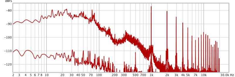

Burgio 2018 is better SQ than Tom Danley's Wisconsin (?) backyard although similar in kind. Fun to see the explosions and then to hear them. The super low sounds that appear on the RTA do correspond to the fireworks instances.
The RTA is for the full 8 minutes although a sample of just the first 2 minutes measures about the same.
Who knew YouTube delivered 2 Hz vibrations? Or is it an artifact of my system?
BTW, this RTA is done with USB input to a Sound Blaster DAC and USB output. So digital start to finish. (Some earlier RTAs might have been "headphone" sourced to a DAC, although that's as good as you can measure anyway on a MacBook Air. Anybody know how to do an REW RTA without using an external DAC loop?)
