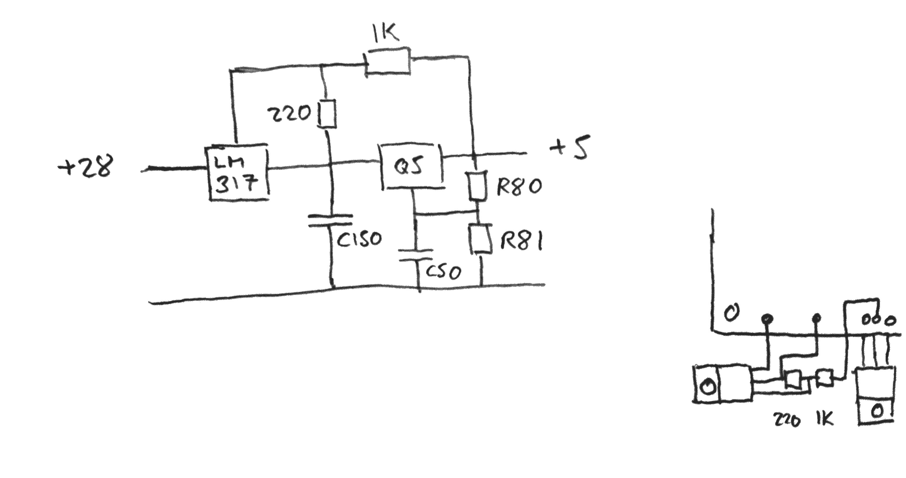

Here You go.
I strongly suggest You modify the 5V according to the included circuit.
Also change c60 to a larger value (I used 470uF) and I recommend You use a input gain of 1.0 (22K for R3, R4, R43 & R44).
Good luck with Your build!
You're welcome 🙂
The reason for increasing c60 is to avoid turn-on "pops".
Replacing R100 with the above circuit avoids turn-off "pops" and gives a better regulated 5V.

@xrayspecs Sorry to hi-jack the thread - but re: the Amp10 Basic and the Muting/Relay and the instructions:
I previously modified by Amp10 Basic to follow the altered directions in the PDF - it's possible I did something wrong, but basically with my 18VAC transformer something didn't quite work properly and I ended up spectacularly nuking a TA2022 and melting a few traces off the board (between the bridge rectifier and the big resistor R100 next to the LM317). I managed to replace the TA2022 and repair the traces - and it seems to work - though I'd love to have the speaker muting work properly.
Pic: https://lh5.googleusercontent.com/-...ZRRJDqI/w1125-h844-no/IMG_20130127_202205.jpg - I cut the chip off with side cutters, hence the mess.
Does the modified +5v circuit you've provided totally replace the existing LM317 (which I think is also in your picture?) or work along side it?
Is it discussed anywhere else - I'd love to get some more detail so I can understand what it changes. Should it be done in conjunction with the changes to the time delay resistor R2?
The R2/C60 modification is made to adjust the turn-on delay.
The LM317 (and the 2 resistors) replaces R100 but is used in conjunction (cascade-coupling) with the original regulator. This is done to keep the 5V from collapsing to early during shut-down and thereby producing problems with the turn-off protection.
An added benefit is the better regulated 5V 🙂
Hope this helps.
Hope this helps.
Interesting! I hadn't seen that set up before - but I see it's actually on the LM317 datasheet as a "tracking pre-regulator" - http://www.diyaudio.com/forums/solid-state/18906-lm317-337-tracking-preregs.html

Remember that both regs should be mounted (with isolation pads) to some kind of cooling device, case bottom works great.
