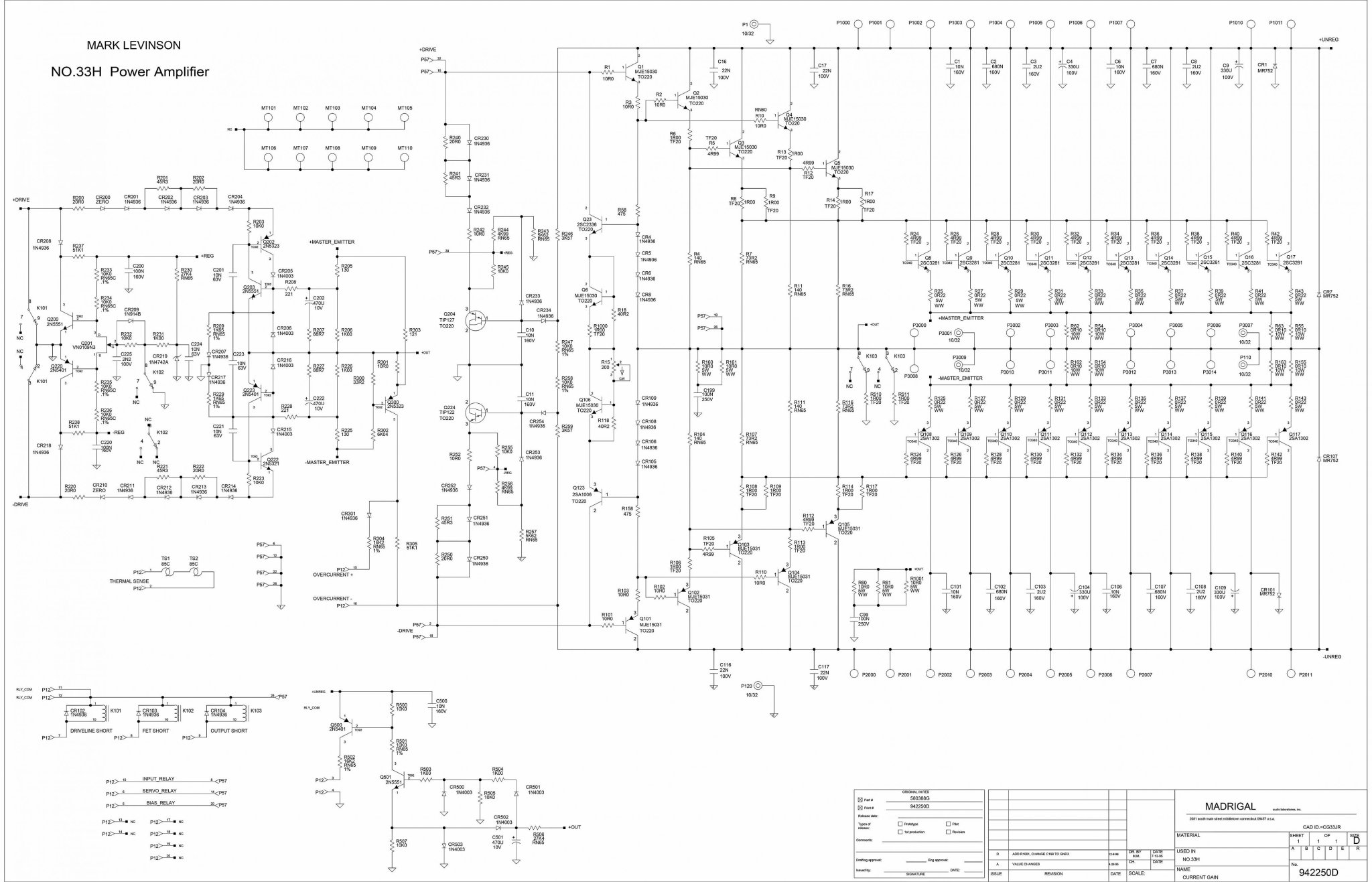

YOUR PROJECT IS TO GET USED No.33 AND REBUILD IT BETTER THAN WHEN IT WAS MADE WITH USA CORNELL DUBILIER USA MADE UCC BIG CAPS AND CORNELL/UCC USA MADE NEW SPRAGUE RADAL AND AXIAL CAPS.
24 UNIED CHEMICON 39000uF 100V AT 95C . DIAMETER 76mm AND 117mm LONG . LEAD TIME 24 WEEKS OR LESS (NO OTHE DIAMETER AND LENGTH WILL WORK) REPLACING 1994 ORGINAL CAPS WITH SAME CAPS.
HARMAN IS NOT ORDERING ANY NEW CAPS FOR 300 SERIES.(33 OR 33H)
1900uF 150V REGULATOR CAPS 4 PCS REPLACE WITH CORNELL 1900uF 250V DCMC192T250AJ2B IT HAS BETTER SPEC THAN THE ORGINAL SPRAGUE.
330uF 100V AT 105C YOU NEED 24 OF THEM ULTRA LOW ESR HIGH RIPPLE RADIAL DIAMETR i1 INCH HEIGHT CANNOT BE HIGHER THAN 1.5 INCHES. 301R331U100JE2 CORNELL DUBILIER MADE IN USA VERY EXPENSIVE. REPLACING URZA UCC NOT MADE ANY MORE.
THERE IS YOUR POWER SUPPLY 52 CAPS FOR POWER SUPPLY SECTION. LOOKING AT THE BOM THESE ALSO NEED TO BE REPLACED.

LONG WAIT FOR THE BIG FILTER CAPS 39000uF 100V AT 95C 32 CAPS MINIMUM ORDER 26 WEEKSTO MAKE IT.YOU NEED 24 OF THEM.
ALSO 330uF 100V AT 105C ULTRA LOW ESR HIGH RIPPLE . YOU NEED 24 MINIMUM ORDER 100 CAPS CORNELL DUBILIER.. YOU CAN USE NICHICON 330uF 160V. LOWER SPEC.
TOTAL PRICE FOR ALL 158 CAPS OVER $3000.
