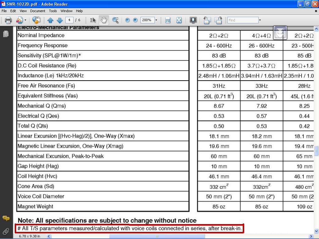

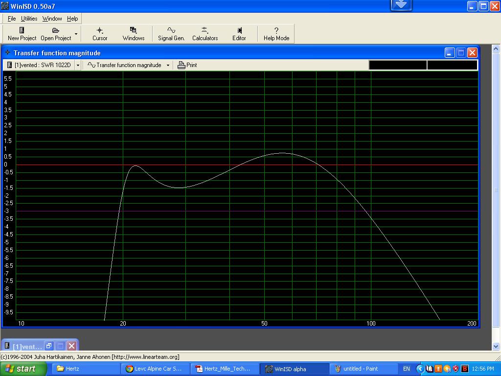

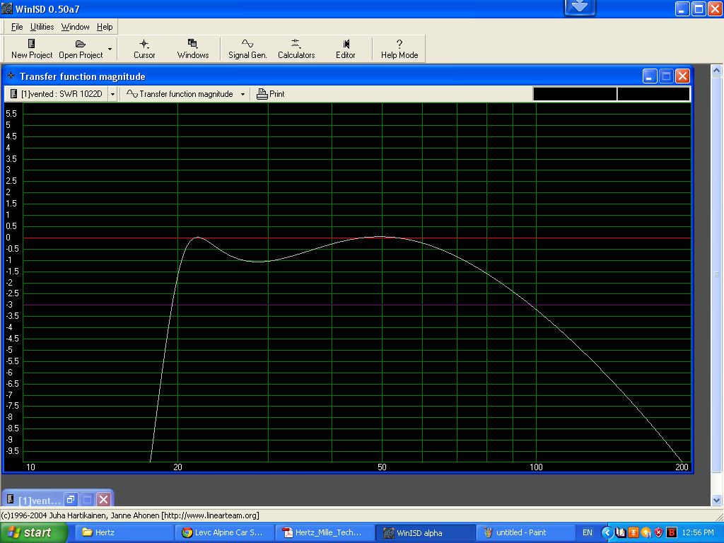

Does anyone know that Levc Alpine subwoofer is measured for single voice coil or series dual voice coil? 😕
It is very important for my design with SWR-1022D
The data provided is not for the individual coils, but for the total inductance of both coils when connected in series or parallel. Is this what your model is based upon?
1.06mH is measured at 20kHz and 2.48mH is measured at 1kHz and it is not for parallel and series connection.Looks like the value is 2.48mH with the coils in series and 1.06 with the coils in parallel.
