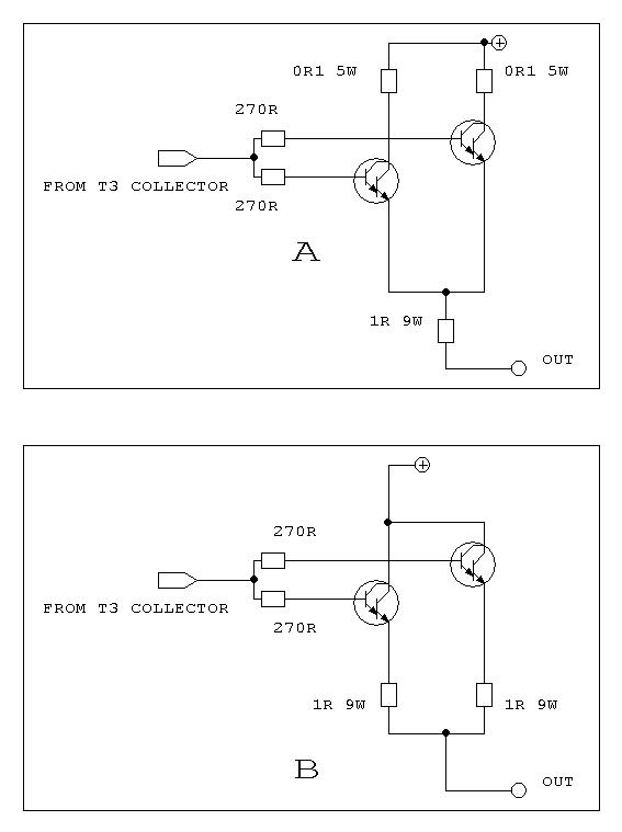

I think that paralleling output transistors there is need of a forced current sharing, how i can do this? simply doubling emitter resistors(one per transistor) or leaving that resistor and adding 0,1ohm 5w collector resistors?
i attached the 2 configurations...
then A or B (or others)
