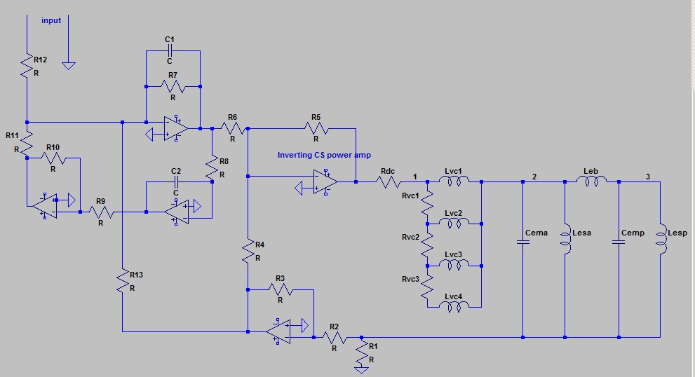

From the mechanical-electrical analogy it is immediately obvious that electrodynamic speakers are current driven. Using a current source amplifier as drive requires a compensation of mass compliance ... i.e. of all mechanical properties of the speaker.
The attachment shows a circuit patented by AES for vented woofers, which is however
applicable to midrange and tweeter as well. The elements at the output of the power amp are the electrical representation of a vented woofer.
Thus current driving makes only sense for active speakers.
The attachment has a circuit of an inverting power amp.

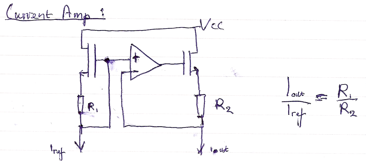

At the moment I quite like the look of the topology with current mirrors driving the load. I will have to think about a sensible way of making a current multiplying mirror out of discreet parts though. Some kind of opamp based Vgs control on the 2nd mirror transistors probably. If I was only making it on a chip it would be so easy as I could just make the transistors bigger!

Hi Hafran,
That seems to be a very creative solution for a basic problem with current drive. However, I see a problem with this approach.
The mechanical properties of any speaker are not linear, both at different power settings, and in time with aging etc. The compensation circuit would have to dynamically change when these driver parameters change, otherwise the compensation parameters will no longer match those of the driver.
Anyways, I would be interested to know if this setup has been implemented somewhere, and if results have been published,

Hi Hafran,
vac
sure google speaker maker AES .
AES had this compensation patented and is about to implement the method
on midrange in a 3 way. The trick is as simple as possible, the output impedance of the driver mirrors the impedance of the speaker . This can of course only be accomplished with a transconductance amp.
