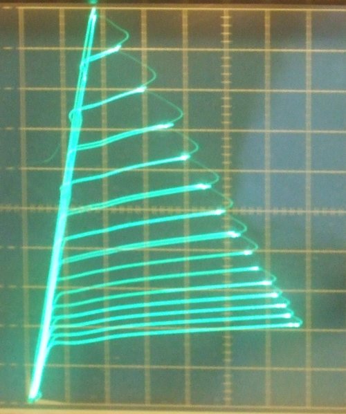

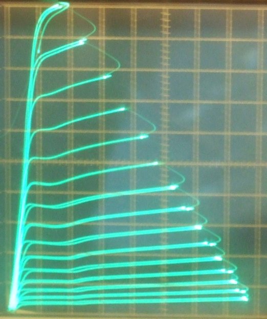

Here are some plate curves to illustrate what happens:
A) a well made (aligned) 17KV6A TV Sweep tube, 50mA/div Vert., 50 V/div Horiz., and 2 V steps on grid 1. (135V on grid 2)
B) a 30% mis-aligned 22KV6A, same 50 mA/.div. Vert., 50 V/div Horiz., and 2 V steps on grid 1. (135V on grid2)
Notice the reduced gm for B) and the increased minimum knee voltage. It is also drawing twice as much screen grid current.
I have another 36MC6 pair, one perfect and the other perfectly mis-aligned. The bad one draws so much grid2 current that its grid2 glows and it pulls down the grid2 V supply. Imminent failure likely. I keep that one on the shelf for interesting tests. It runs perfectly in triode mode however (although drawing a higher percentage of combined "plate" current through grid2 than a well aligned tube).

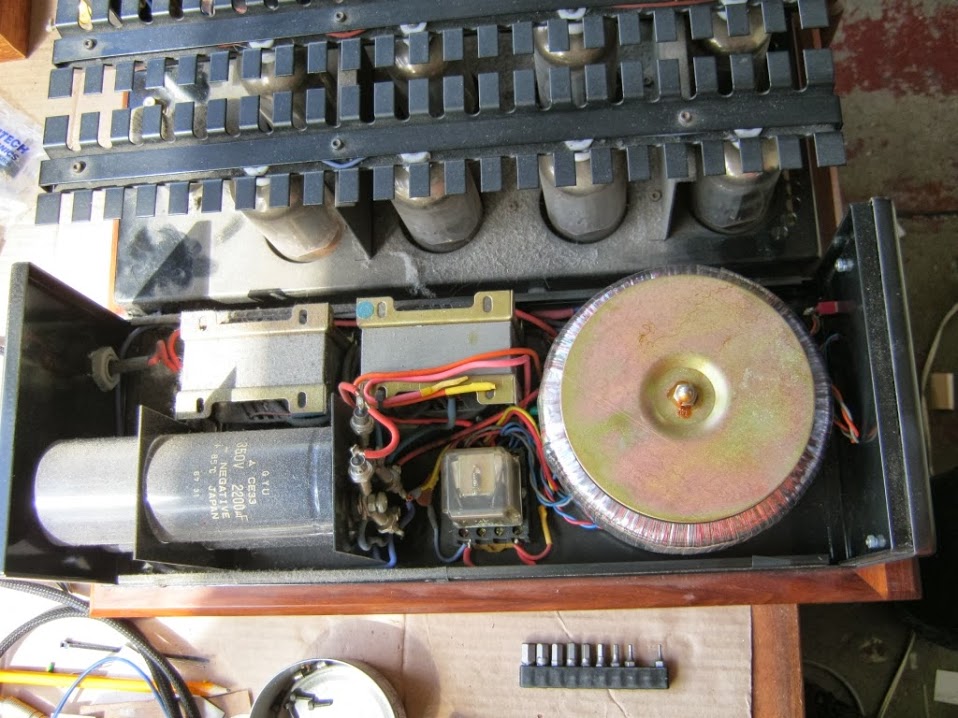

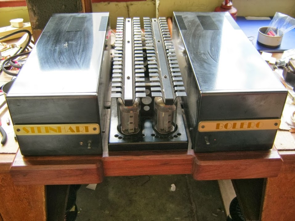

Judging by the pictures here (near bottom of page):
Analogue Audio Engineering
This amplifier has to be over-heating grossly. All 8 output tubes, running class A, in a small box with shiny reflective sides everywhere except on top, where a wall of plate-cap heatsinks absorb the heat again. I do see ventilation holes around the tube bases, but this thing needs a blower to stay cool in there. Even the steel frame is rusting out from over temping. And are those exposed metal/plate caps on top? A death trap too.
Some serious re-work needed on those things I think.
There are many idiots out there who learned how to solder two wires and how to cut the 1" holes in a chassis hence became the Gods of Hi-Fi electronics design.The Fiery Inferno Amplifier

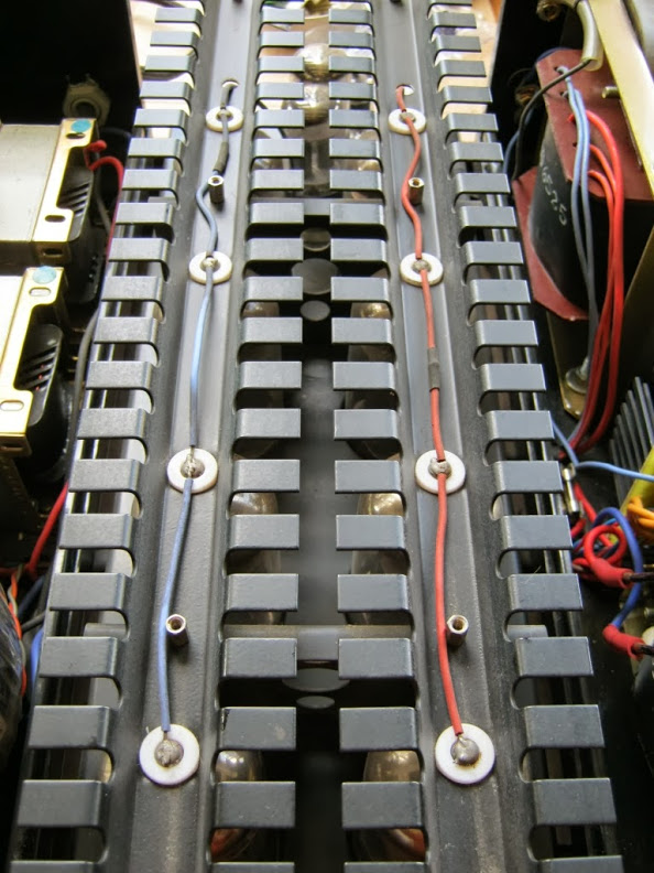

I see them placing the electrolytic caps over the hot tubes, mounting the tubes horizontally without aligning the grids vertically, or like this squeezing output tubes into such cases etc etc etc. What I do not get most: why they situate the ugly-cheapo-no-name caps protruding out of chassis like tubes, and hell, some are red-colored! Apparently, that means "The Performance" ))
To me, the first sign of "design" is zero screws on amp's top surface, only then I look further. Otherwise just another pity home-brew amateur's . .. craft ))
It looks like the metal "heatsinks" up top are just decorative (teflon insulators on caps), used to hide the plate cap wiring (which is insulated, for the most part, but can still see the bare connections through the cover strip gaps). But now this decorative but useless "heatsink" up top is just restricting air flow.
On the bright side, looks like the amplifier is in 3 parts, so could be separated for some cooling by lengthening some wiring and putting the tube section up top (stacked).

Yes, those "heat sink" devices are for decoration only. They are not well thought out and not well made either. But man they sound good when they work.
