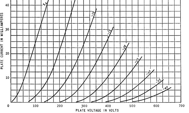

I took the two graphs together:

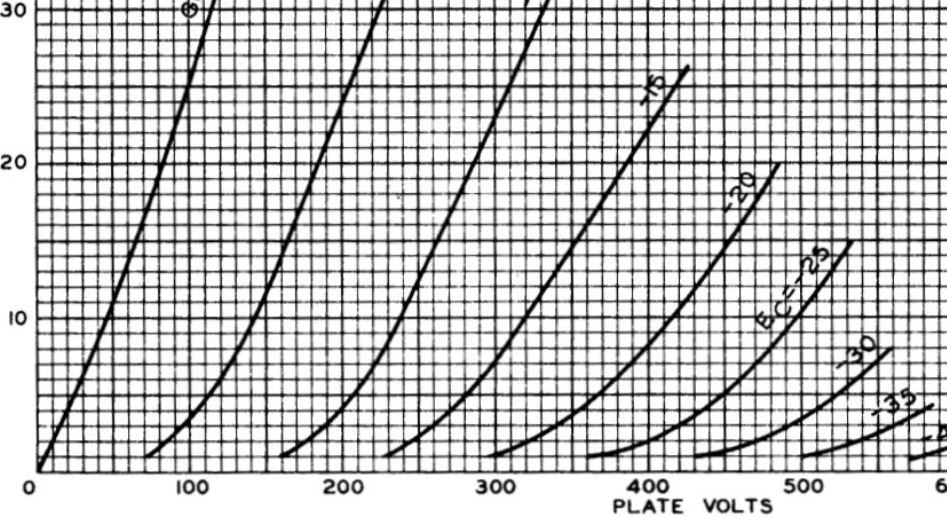

Makes a better driver to drive the following stage in an RC coupled amp. The AC vs the DC loadline is an important consideration, the drive stage should have an impedance as small a fraction as possible when compared to the following stage. The 12BH7 is lower rp, should result in lower distortion.:)
How they compare to the ear depends on many influences external to the 12BH7. Speakers, baffle, room, mood & on & on.
Some folks like a bit of distortion. For there own reasons.:)
Preferences are a very complicated subject.
If the RC cct is driving a cathode bias stage the following grid can be safely up to 500K. For that a driver of plate load 100K would be OK.
If the RC coupled cct is driving a fixed bias stage with 100K grid resister then a 100K driver would result in quite a bit of even order distortion (2nd, 4th, 6th,....). We can see the bunching up of the plate curves on the RHS of the resultant loadline. So in that case something like 27K would be a better choice.:)
As the following grid resistor is reduced the AC loadline rotates in a +ve direction. The example is for a different tube but applies to any RC coupled triode. And pentode.
Another point overlooked or completely missed by many is the zero order term of the power series that results. That is what moves the operating point. The effect used to be referred to as rectification. Figure that one out!!:D

Here is curve trace of 2 JJ 12BH7
As uTracer only goes 2 400V the curves are cut there. Solid lines is triode 1,
dotted lines = triode 2
Also "summary reports" at typical conditions.

What is your verdict about the 3 groups of 12bh7 anode curves ?
I am currently designing a power amp with MOSFET output.
- The input is the 12BH7 tube, which also provide all the voltage amplification. - The transistors in the output end just acts like an inverting buffer. As the tube inverts the outcome is in phase with the input....
