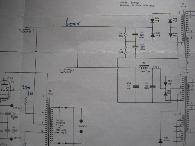

For more than 10 years of building amps I'd been petrified of applying high tension to cold tubes.
There is no harm done when applying high voltage to cold tubes!!!
The 5U4 was the standard equipment rectifier in the post war years; worse was to come when evil smelling selenium rectifiers were used. The metal rectifier was the norm in lower voltage TV sets.
Nearly all the tube amps of the late 60's started to use sil rects. Did the instantaneous Bmax destroy tubes ? Nup. No evidence of stripping at anything used in consumer equipment.
Enclosed, anything cheap to save was the norm. One of those nasty rabid cap-input filter circuits. ca 1967. The description mentions KT88's should ahve a life of 10,000 hrs....
