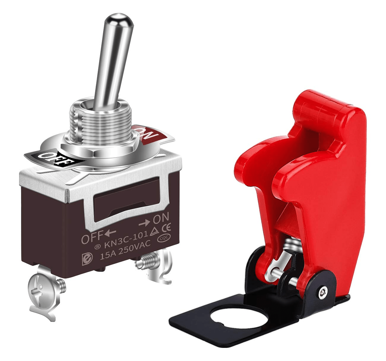

yes, with a fire suppression system.A real emergency stop switch would take the burning amp joke to the next level. 😉

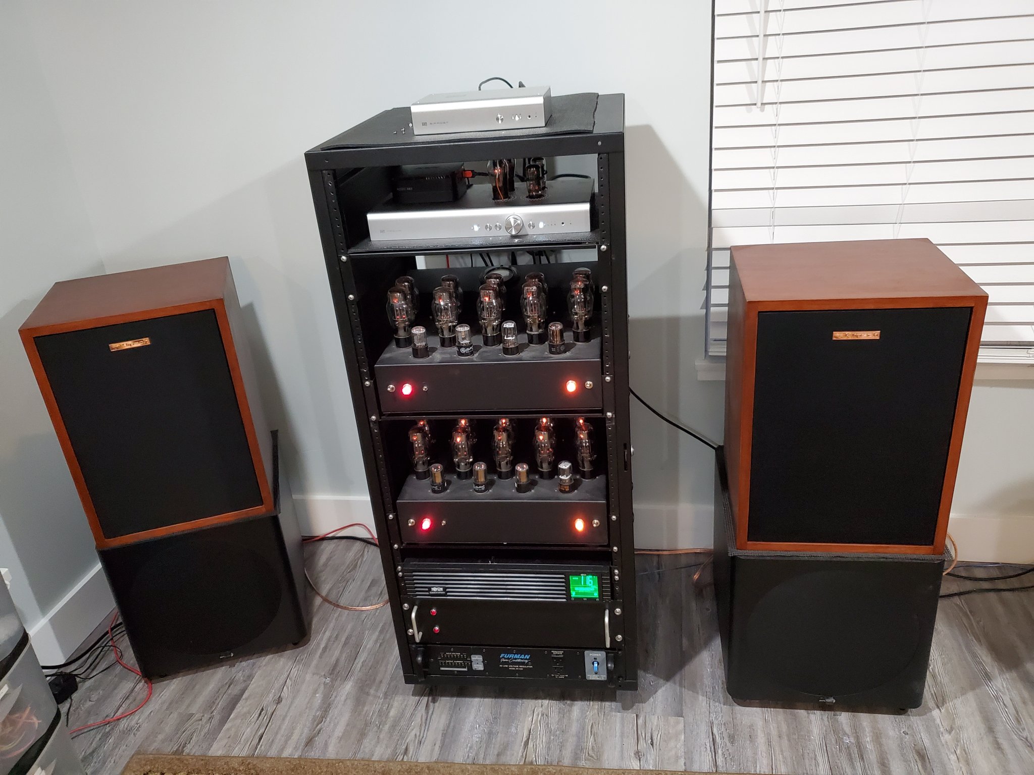

Server cabinets are great. Especially for my OTL’s 😬My next proposal must be a bigger chassis then.. server chassis?
These suggestions are awesome! I’d love to do a server but the space is limited.

Great sounding I’m sure and an excellent source of heat in the winter 😁Server cabinets are great. Especially for my OTL’s 😬

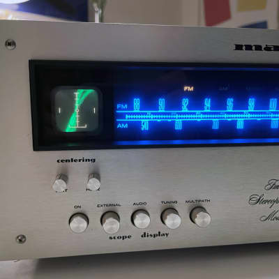

These vintage tuners look great, I’ll try to incorporate This into the front panel in some way.Keeping true to the heritage of the chassis, I suggest an oscilloscope screen on the front panel, like the FM tuners of the past.
Then you can visually check for clipping or just show the world what music looks like. The possibilities are endless.
I actually have a round oscilloscope bezel & screen from an old Eico, that might make its way into the build.

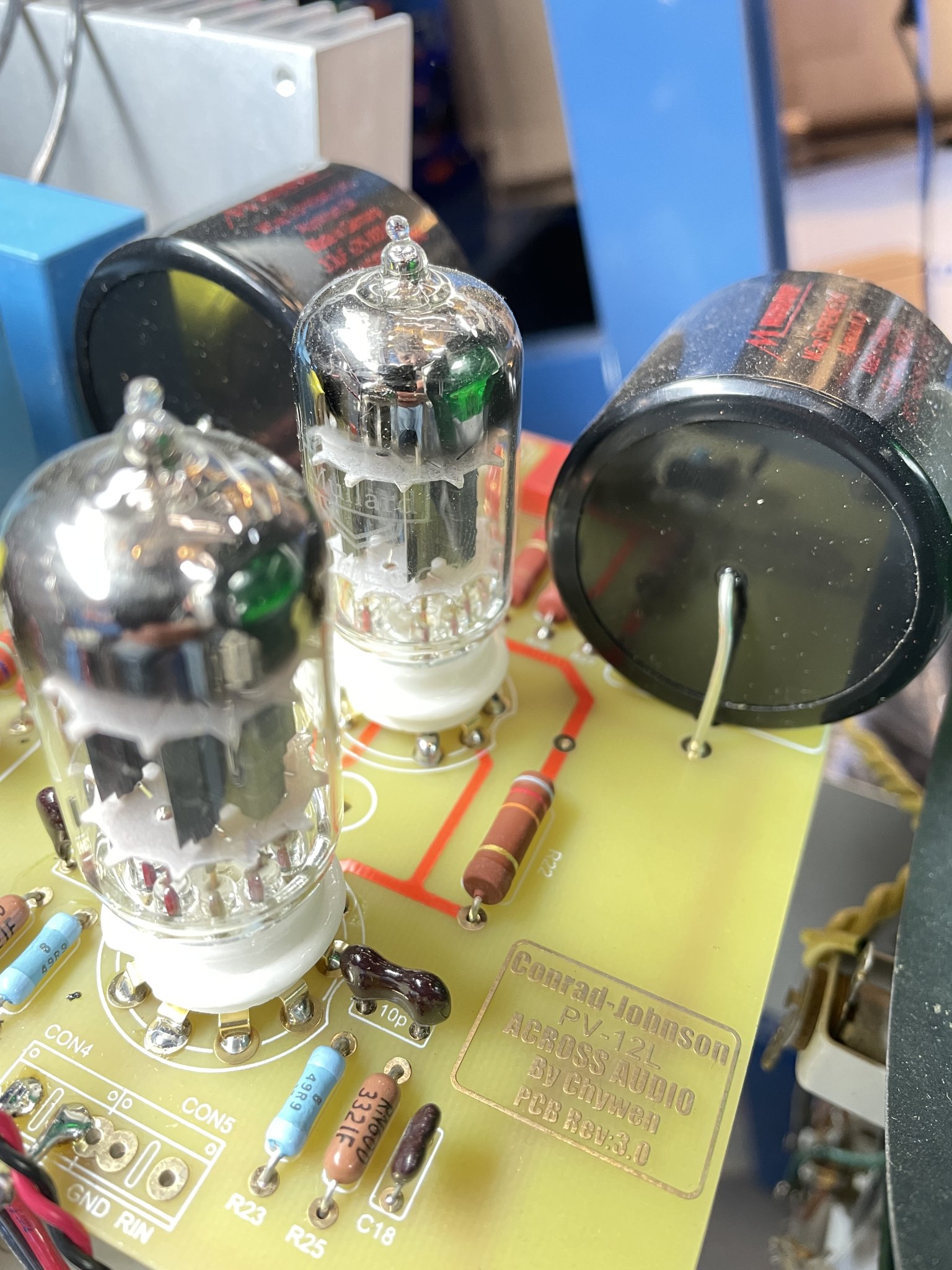

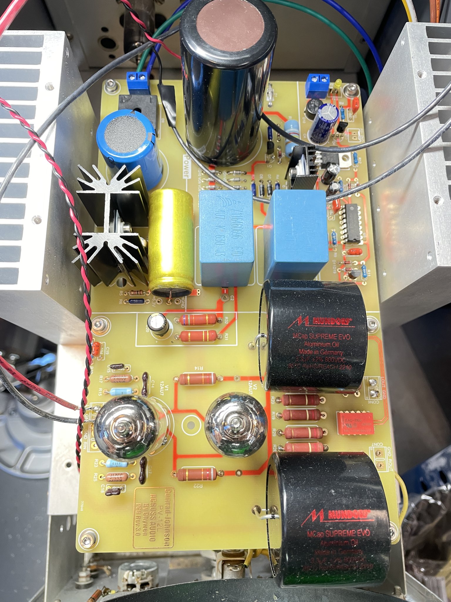

To be honest, I got some reservations about a CJ "copy". No way did CJ allow such a copy... they are adamant about keeping control over their stuff, even maintenance and repair. I got a PV9 and ET3SE (line stage), both with their CJ branded Teflon caps... which elevates them incredibly over the stock units (also use Svetlana tubes).
All of the work has been done at the factory.
You got to respect IP.
I agree with respect to IP and the value of CJs work.
This “copy” definitely deviates from the original design. I purchased it because the schematic and quality looked reasonable. If it had a different name I would call it by that, but unfortunately it doesn’t.
We can refer to it as the “SE tube preamp” for the duration of the build.
Also, the tubes and big caps didn’t come with the kit 😉

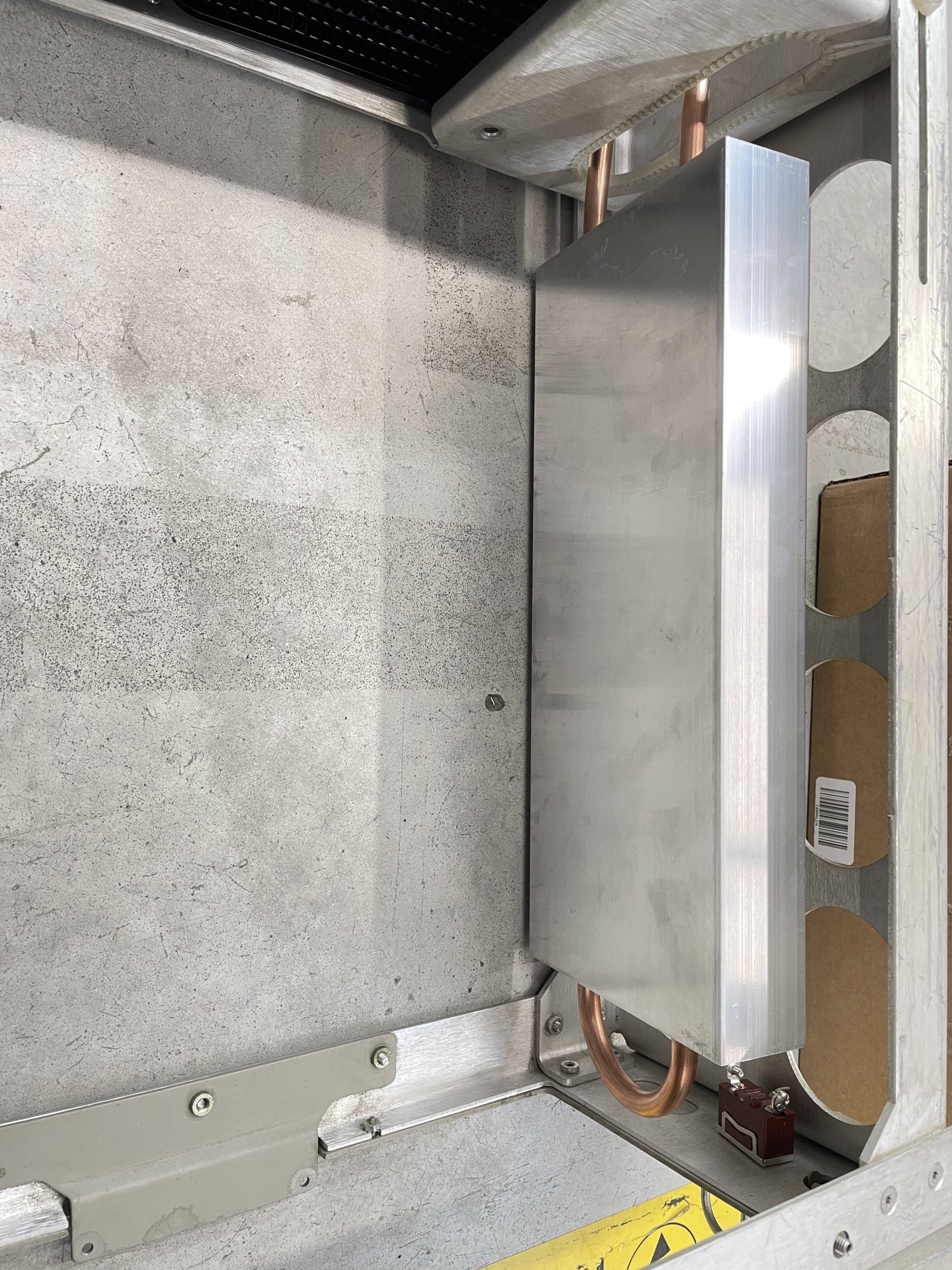

Cooling solution is being sorted out.
The current internal struggle is in deciding between dual cold plates or one single plate (serving both amplifiers). I believe the former is more widely accepted, but it will increase cost and complexity of the coolant loop.

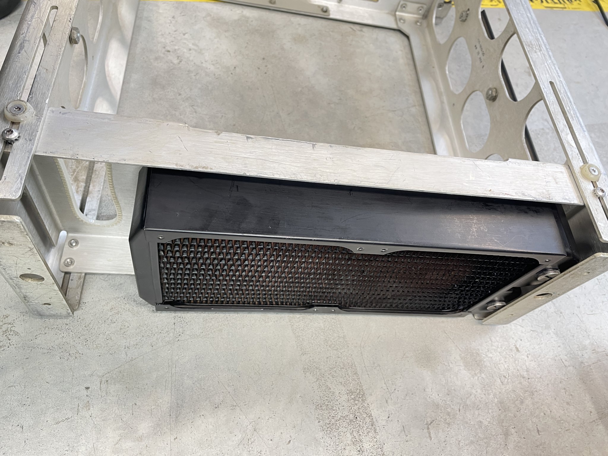

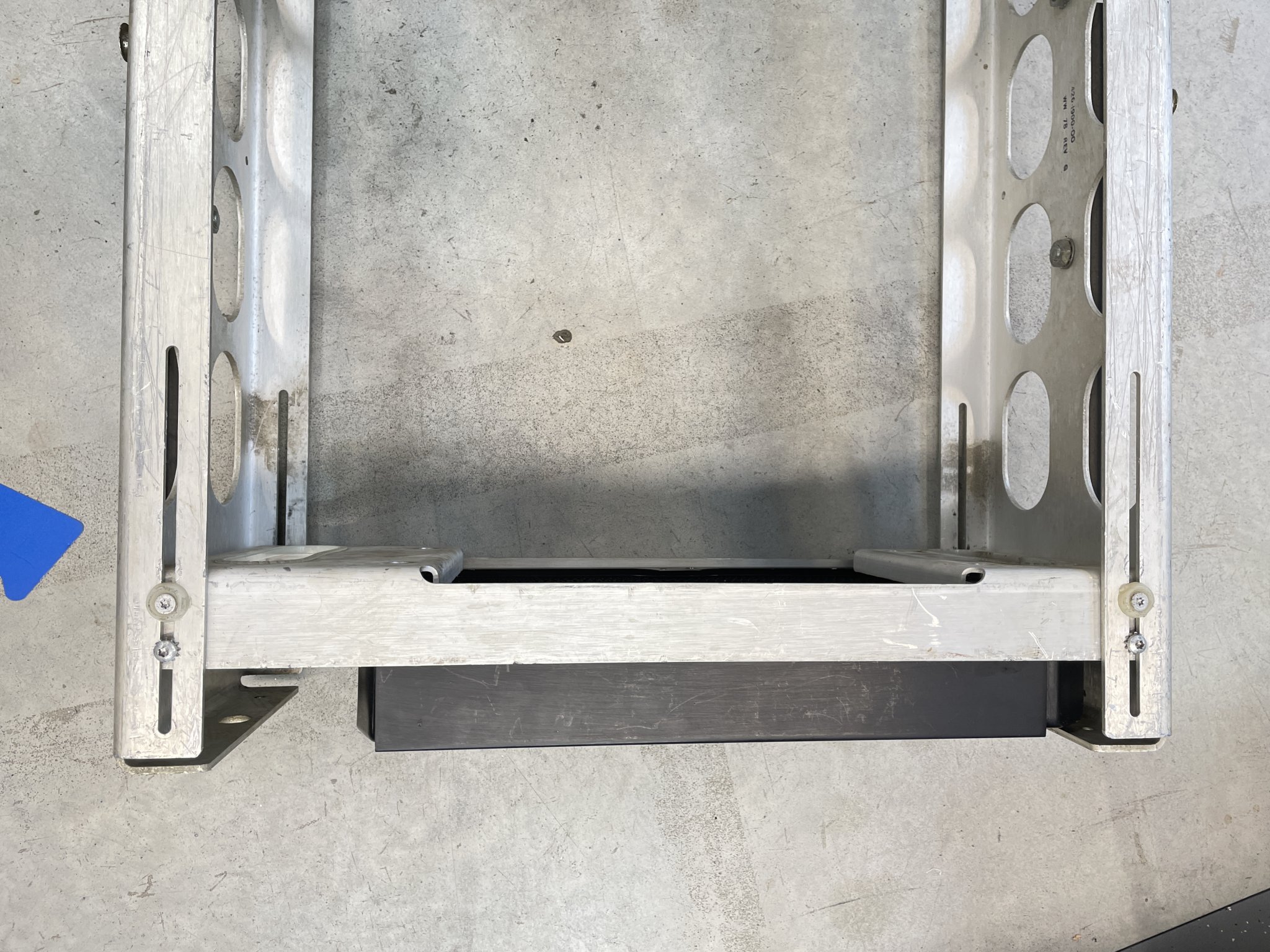

Received cold plates and radiator for the Aleph coolant setup. Haven’t had time to make a CAD model and plan the fabrication of mounting parts, this may or may not happen. Worst case, things get built on the fly.
Coolant reservoir and pump are not on hand yet, but they should be easy enough.
