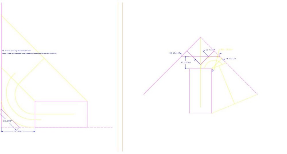

2 recommended corner loading schemes for labhorns - recommended 2 units, stacked (floor to ceiling) or 1 unit with a 'flare extention' to limit vertical expansion into the corner.
Borrowed from a thread on prosound web that I couldn't find to link to right now.
http://srforums.prosoundweb.com/index.php/f/3/0
Rob.
I'm doing the one on the left in a week or so...
Rob.
