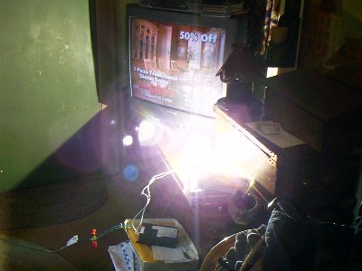

hmmm i got my bulb today, its crazy bright... When i first turn it on i was like... is that it? and then it started getting brighter and brighter, and yeah... it got super bright, it made shadows on objects in the room in the middle of the day with the widows unshaded. After i turned it off it tipped over on the carpet burnt a lil and started smoking. Then i put it in the hole of my projector but didnt turn the projector on only the light. The square projection was visable but dim. Im sure if i use a reflector it will work alot better. But after a few minutes it started to smoke so i turned it off. I think and hope, that it just had some carpet still stuck on it and when it got heated up it started bruning it, and not my projector, eitherway im pretty sure its gonna be way to hot. Maybe i can put a plexy glass seperator inbetween the bulb and the light terminal, then replace all the plastic sides of the bulb area with fans. Damn i dont know... and i also dont know what to do about a reflector i wanted to use the original but the hole in the back is to small.
damn, i just looked at the bulb and it has a big brown spot of crustyness on it, im guessing its the burnt carpet. I tried to rub it off with a tissue but it didnt work. Is it dangerous to run it with that crap stuck on it? I hope i didnt just waste 60$.... I also looked inside the projector and it burnt a tiny hole in the top in under a minute, im pretty sure this isnt gonna work... damn... I hope i can find something else to use it on.

Yeah I knew to be super careful, but I couldnt wait to power it up. I upluged the ballast and it fell on the floor and dragged the bulb and socket with it. I never touched the bulb with my bare hands, It has a pretty big base to hold on to when handling it. What should i do about the big chunck of carpet stuck to it? Did i just waste 65$? I guess it doesnt matter, i dont know what i would use this damn bulb for anyway... cooking maybe?

assuming your carpet was nylon or plastic-based, it melted and started burning from the heat of the bulb, right? that means the carpet fiber is a thermoplastic, which means it softens when heated.....get what i'm trying to suggest here???
ok If you still don't get it i'll just say it.
turn your lamp on until it warms enough so you can use a credit card or some smooth edged tool to pry the "softened" thermo plastic off.
should work.

Hey, thanks for the tip, but im afraid it will explode if i mess with it anymore. I might try though. It looks like charcoal right now... so i dont know if its gonna work.
Pooh, I work in the areospace industry, and we use alot of solvents. One of the solvents we use does a fairly decent job of melting most plastics. You might want to give it a try. It wont hurt the glass or the ceramic base. Its called MEK or Methyl ethyl ketone. You can get it at most hardware stores that carry alot of paint supplys. Use protective gloves and try not to breathe much of the fumes, its also extremly flamable so be careful. Ater you wipe the burnt plastic off with some ketone, use a little rubbing alcohal for a final clean.
