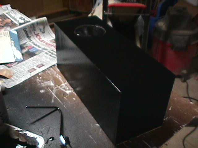

did a bit more work on the enclosures today. my woodworking skill still leave something to be desired, but since i used thicker than necessary materials, i had quite a bit of breathing room for "touch ups" (mainly matching up corners and such). i tried doing the whole bedliner paint, but i messed up somewhere (guess i should have primered or something or its too cold here to cure right). i instead used some flat black paint that i had from when i did a previous electronic project (my very own arcade style controller). here's another pic of my progress. jsut waiting for it to dry, maybe add a 3rd coat....
