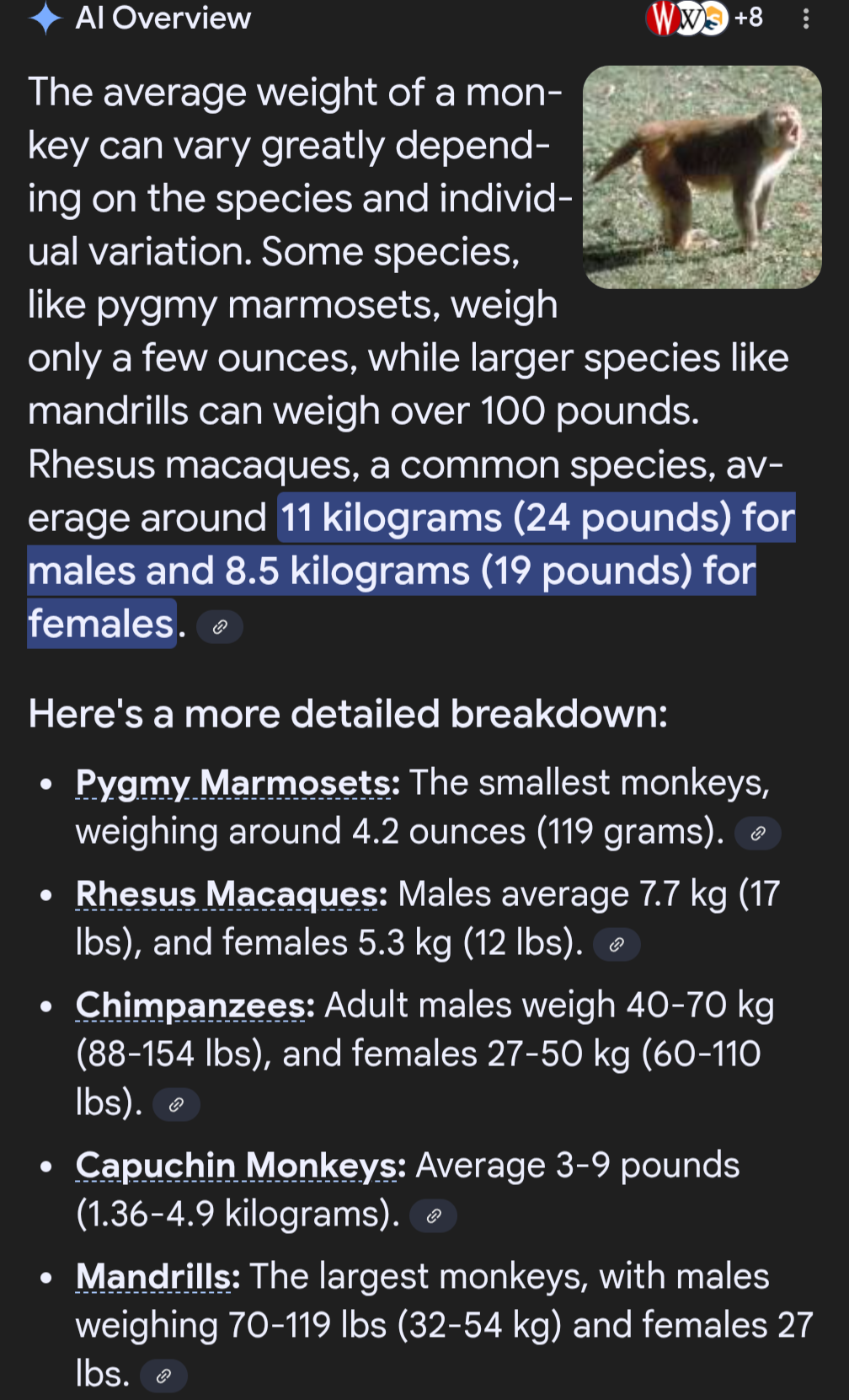

Regarding height, something that can I can put a 1970s style monkey coffin on at its lowest setting, and a small desktop size speaker at its tallest setting. Ear height is assumed to be around 38-42". Weight limit, maybe 50 lbs? How much does a monkey weigh at most?
