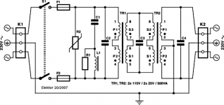

Lets build a POWER CONDITIONER! input needed.
From Elektor Oct 2007
"Interference-free Sound
Mains filter for clean audio power"
I have removed the component values hoping this now counts as fair use?
Regards
James
I'm not trying to start a flame war, I am just trying to provide information to prevent bad stuff from happening.
I had a PC take a hit probably through the phone line, and despite Tech Guy's mumbling, the power supply and CPU did not go out, only the modem and PCI slot.
Most likely the surge came in from the mains and left through the phone line, using your modem as an exit port. Consider that a MOV's are typically wired to divert energy to ground wire, and that the phone line is also connected to the ground wire. There is a ground loop to the POTS line. The surge diverted to ground back into the modem to fry it. Was it just your modem fried or were all your phone line devices fried too? I am betting it was just your modem, If lightning hit your phone line, you can bet everything else connected to POTS lines (include other POTs lines connected to your building) will also get fried.
Another words, what appears to be a surge on the phone line, because the modem blew often is a false diagnosis of the problem. Your modem died because of MOVs diverting energy to the ground wire, creating a very high voltage differential between ground and the POTs line connected to your PC. MOVs don't absorb energy they divert it.

Blowing the fuse is my idea, instead of blowing the expensive or impossible to replace power transformer.
Fuses are way too slow. They take 100's of milliseconds to 10's of seconds to blow. a high voltage spike can cause damage to electronics in nanoseconds. Short nano-second spikes are rare, but all it takes is one to ruin your week\month\year\etc (depending on how much damage is done). Also very high current surges will vaporize the fuse filments into plasma that will provide a low impediance path for current to flow, well after the fuse has blown.

How much protection depends on how much risk you wish to take. I prefer to have the highest level of protection on my most expensive equipment for those 1 in 1000 surges. I don't like the idea of diverting a surge to the ground line, only to attack other devices from their ground connections. Its like moving a flaming cart away from one building and placing it next to another. You saved one building, but lost another to the fire. Surpressing the surge using a cap bank is a better solution (like pouring water on to the flames).
All these suppressors read 9999 meg ohms, and some them I have reused. Ishida and Allen Bradley and TB Woods have major reliability reputations to protect, and all use S14 MOS suppressor on their inputs.
That doesn't mean they are not degraded. a MOV consists of thousands to hundreds of thousand micro pathways for current to flow during a surge. Each time a surge happens a few to thousands will blow reducing the amount of current it can carry. eventually it will lose its ability to pass any significant current. a resistance test on a MOV does not tell you how much current it can pass during the next spike. All it tells you is that the device isn't completely blown.
